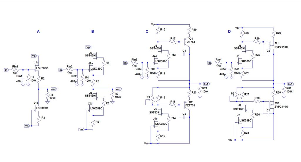

Thanks Joshua, in my system sounds better Calvin schematic B buffer than JC buffer, the differences are clear: more resolution, no analytic sound, etc.
Congrats Calvin, surely I will try schematic C & D for the AVC volume control, not sure for the active xover, will see depending the result with the AVC.

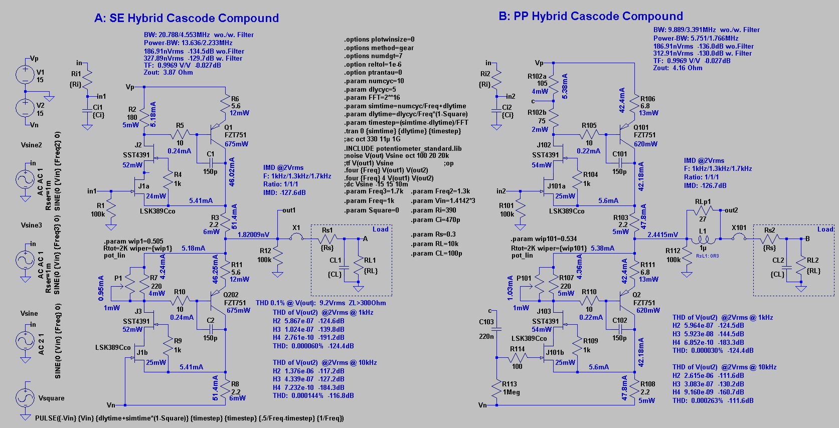

You saved me 2 topologies I had in mind comparing. Based on your experience, I intend to compare either B and C, or B and SE Hybrid Cascode Compound (C) and PP Hybrid Cascode Compound.

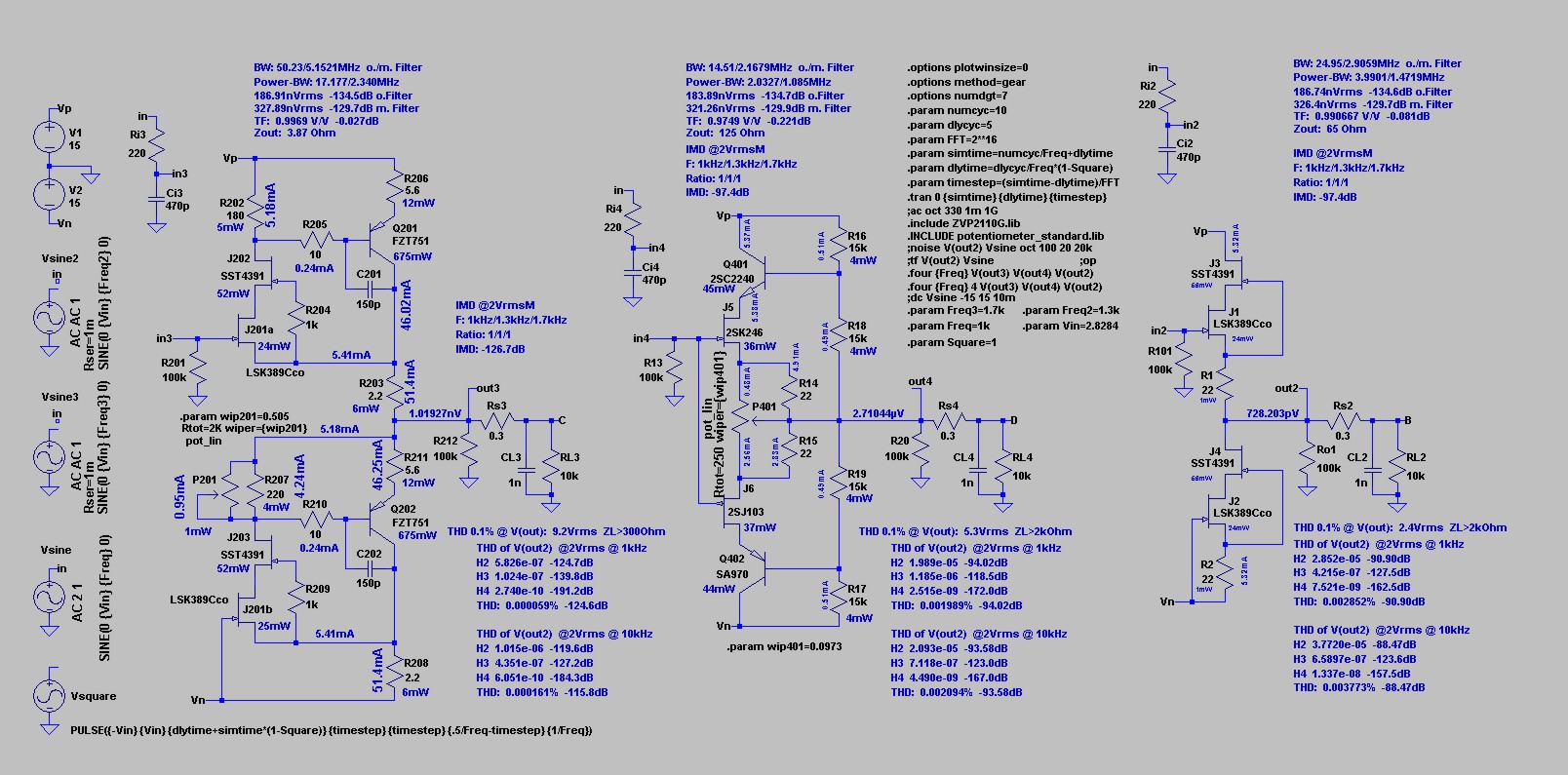

The buffer is intended to come between IVC and the power amp, however upon finding the best sounding buffer (to my taste and on my setup), I'm going to compare also the IVC to DACT Stepped Attenuator.

I accept your experience, however the picture may change when the TVC/IVC/Attenuator is buffered by Calvin Buffer. It will cost me nothing to compare.
It's also my experience that without a buffer the Tribute IVC is the most pure and transparent preamp, though it lacks dynamics with my power amp. With a simple JC buffer, like in "A", the IVC is superior to any preamp I encountered in respects, or in all sound parameters, including dynamics.
The prospects are that it will be even better with one of the two versions of the Calvin Buffer (SE or PP).
Also, what's 'better' may depend on the entire stereo setup and personal taste.

I forgot to told you in my system & for my taste. I agree with you nothing beats the AVC alone, Calvin posted it depends of the load:
" ´D´ shows slightly better THD than ´C´ with highimpedance loads, while ´C´is slightly better with lowimpedance loads and can drive up to 6Vrms."
Following Calvin advice between pre an amp "D" will sounds better "C", for active xover loudspeakers "C".

Do you know the values for schematic C?
P1
R15-16-17-18-19-20
C1 & C2
In the attached pdf document all values are given for version "D". There should be no change in resistors values for 2SK170/PN4391 JFETs.
For version "C" use the values given in the attached jpg, only, for KSA1381 change C1,C2 to 100pF.
