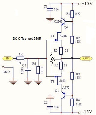

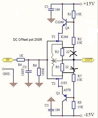

Still no luck. I am getting a 100mV offset across 250K resistor ( and with no load ). I am just connecting two batteries of 9V in series and using the center tap as ground. Is that the problem the voltage difference in batteries causing an offset to appear at output?

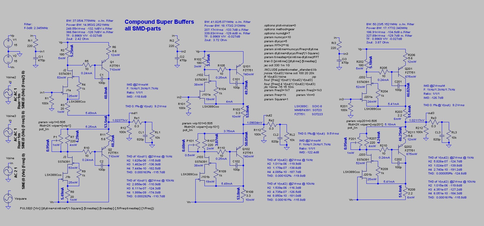

I was just taking a look at the push-pull (modulated ccs) buffer. With 100 ohm load and 10Vp-p output, the 2nd harmonic still dominates at -80dB in respect to the fundamental of 20KHz. It has "second harmonic character", although I consider the distortion quite low. The 5th harmonic is better than -120dB and the 7th is -160dB. As shown, the bias is 8mA in the jfet and 75mA in the pnp. What a beauty.
edit: 2SA1381 is not adequate, it won't sustain hfe (beta) at 100mA. It's ok for simulation purposes. For construction, Q1 and Q2 are TBD

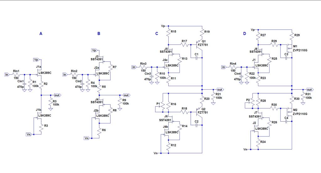

why not decrease the idle current by increasing R_top and R_bottom?
50mA (45+5mA) would be fully sufficient for 10Vpp into 100R.
Reducing the Id of the SK170BL to say 5mA/45mA would also reduce the heat power loss considerably (which is alot higher than in the cascoded JFETs of the Calvin-Buffer).
If You want run the circuit that hot, You might use a different PNP (plus possibly different compensation caps).
MJE350, 2SA1358, 2SA1837, 2SA1859, 2SA1930(!), BD140, KSA1220, ZTX750, ZTX957 et al.
