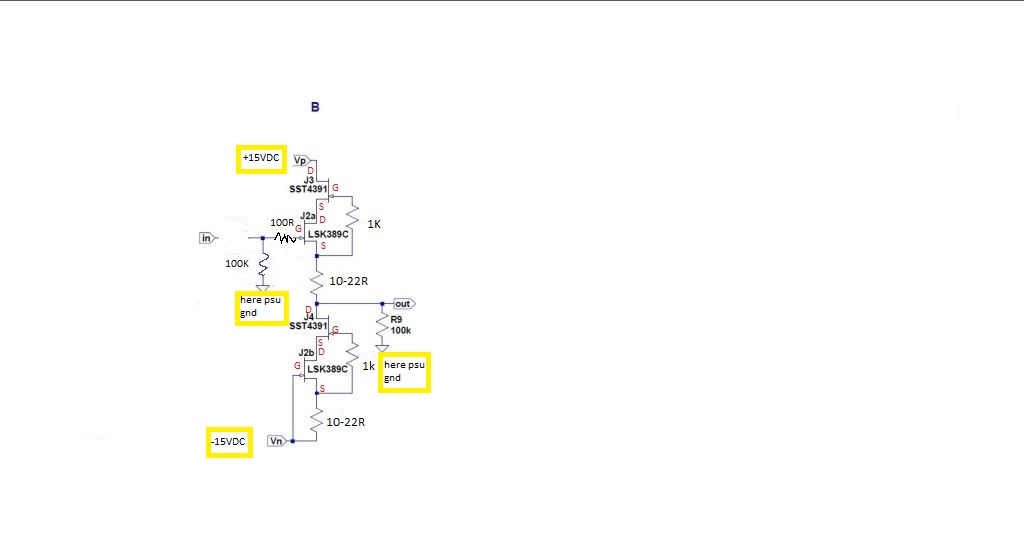

Another ignorant question, before to connect the buffer to the PSU LM317/337 I adjusted the PSU to give +-15VDC without load, when I connected the buffer to the PSU the voltage down to +3,91 VDC and -1,19VDC, the tx is 0-22VAC 1A main filter cap is 4.700uF
Something is wrong, possibly short circuit or burned JFET(s) in your buffer.
Check carefully (without voltage applied) wiring and check all JFETs between D and S with an Ohmmeter.
Attached pic showing how I connected the PSU to the Buffer.

Merlin,
do you have a CRC Filter in your PSU? During startup the buffer draws quite some current until it settles to the designed bias current. I have the same (well not that extreme) with my SMD Calvin buffers. However after a few seconds it adjusts to expected behaviour.
Just a thought...

It's ALIVE!
I finally got one channel of this buffer completed this evening.
I only built one channel initially to see if it was going to play music or go up in smoke.:flame:
Much to my surprise it does play music. I was able to get the DC offset between 0 and 1mv after adjusting the trimmer pot.🙂
I'll assemble the other channel and see how it sounds connected to my Adcom 535II amplifier.
Soldering those little SMD resistors does take some time.:snail:
