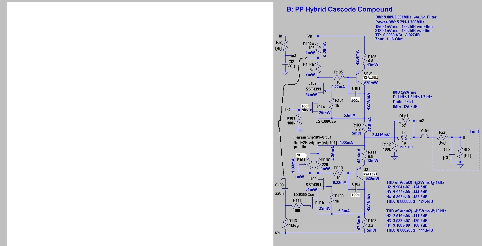

Attached schematic "C" KSA1381 mod, is OK?

P1 value?
2K for all versions.

regarding #561 (565):
I wouldn´t suggest making R1 (R101) higher than 100k.
It´s the input impedance the sourcing device will ´see´.
Originally I thought of AC-coupling the Buffer.
Therefore a first 100k resistor would have been added from ´in(vsine)´to gnd, and a series cap from ´in (vsine)´ to ´in(Ri)´ of 1µF to 10µF.
The first 100k and the R1 would have resulted in ~50kOhm AC-Input impedance.
The standard value for the input impedance is 47k.
So, if one wants to DC-couple the Buffer, than R1 (R101) may be reduced to 47k.
Don´t forget the Input RC lowpass Ri/Ci between ´in´ and ´in1´ (in2).
R12 (R112) are only used as ballast resistors, if no load is attached.
100k is high enough, but 250k won´t make much difference (apart from higher output offset voltage, resp. higher sensitivity to offset).
Rs, RL and CL are only external loading parts for simulation purposes!
They are no parts to be placed on the buffer PCB.
X1 (X101) are just monikers for a connecting cable.
jauu
Calvin

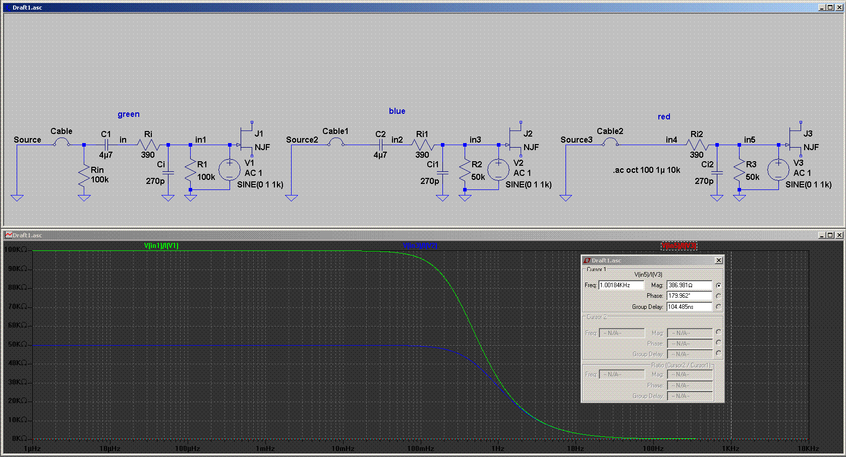

shown are the three possibilities for the input filters.
red: as is in the simu of #561
blue: as is plus AC-coupling cap
green: with split Rs and AC-coupling cap
The input impedance plots as the source would see them(1st attachment).
red: 50k (50k390 to be precise) until the Ci comes to effect lowering the curve above 10kHz.
blue: as red, but rising to infinite (an open) below 1Hz
green: as blue but Rin limiting the plot to 100k below ~100mHz.
Over the range of ~1Hz to 10kHz the source mostly sees Rin and R1 in parallel (50k).

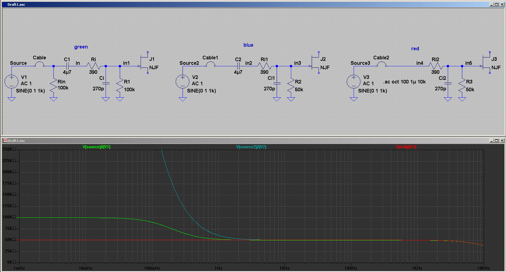

If a source with miniscule output impedance is connected the JFETs will see impedances as shown in the 2nd attachment.
red: constant at 390R (value of Ri, Ci has nearly no effect below 100kHz)
blue: like red at 390R, but rising below ~10Hz and levelling out at 50kOhm below~100mHz.
green: similar to blue but levelling out at 100kOhm below ~100mHz.
Of importance is rather what the impedance seen from the source looks like (1st attachment).
jauu
Calvin

Of importance is rather what the impedance seen from the Buffer looks like when looking back towards the Source
Only when the interconnect is disconnected does the Buffer see Rin alone.
If one also has an RF attenuating capacitor (as shown in your sch) then the disconnected impedance seen by the Buffer is Cin||Rin. i.e. even lower and at RF extremely low.
