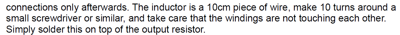

This is where I got the figure of 10uH from...must be an error in the assembly guide.
I saw that and in view of the high impedance that the Buffer is intended to drive I believed that 10uH value.
Compare to an 8ohms speaker where we generally use around 1uH.
Driving 10k ohms would hardly sniff a 10uH inductor in the line.

the 10u figure is an artefact of one of the sims.
~1u is the correct and practical value if You do as descrbed in the assembly guide.
You may use simple wire as described -windings shall not touch each other- or enameled copper wire for dense turning.

It´ll probabely a bit less than 1µH, but the value isn´t critical at all.
Just follow the guide and all will be ok.

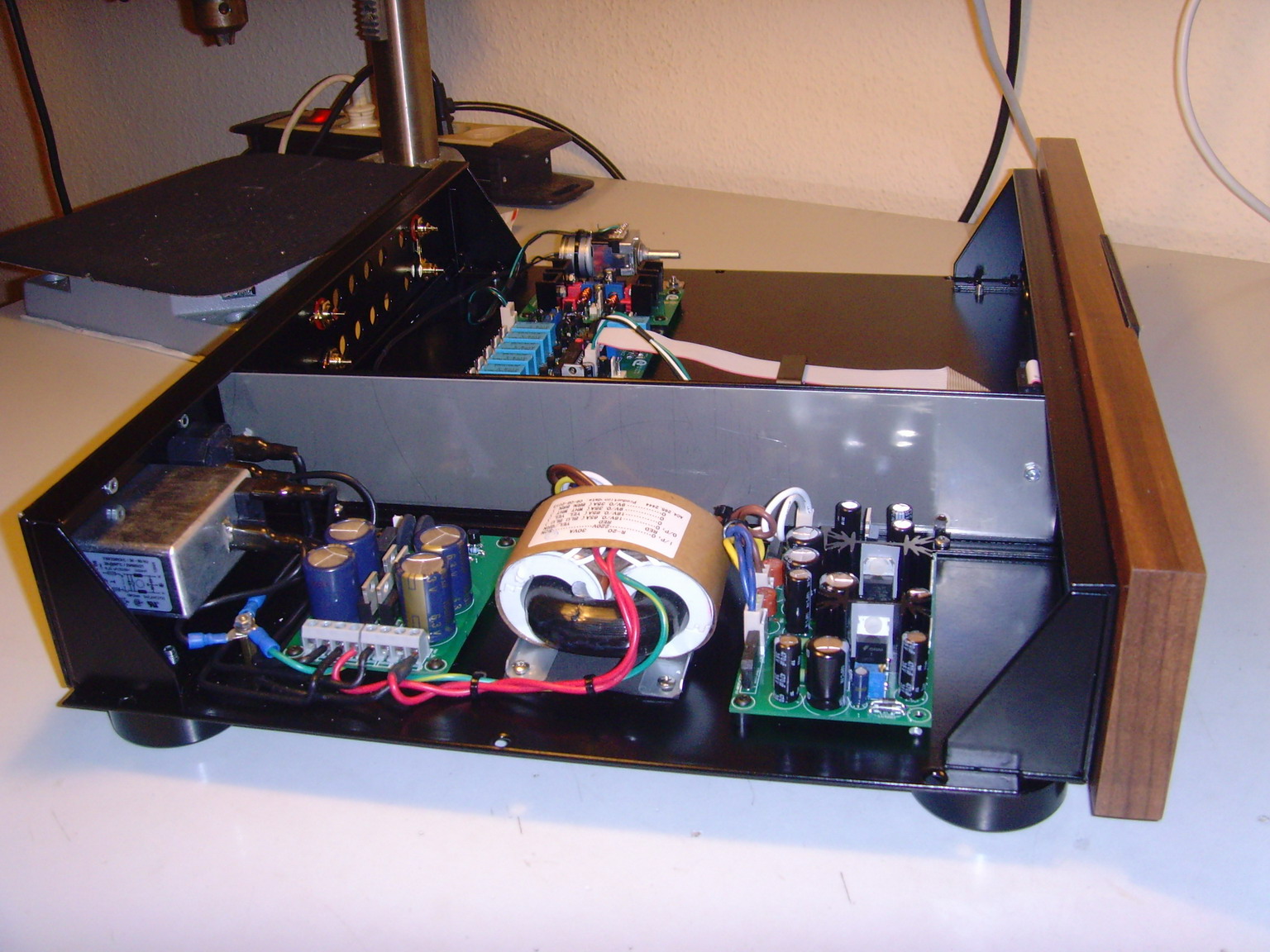

Calvin, I will try and sketch the components that my PRE is consisting of.
First (Image 1): the PSU - section.
230VAC mains enters the case through a SCHAFFNER-filter.
The PE-connector of the filter's output is connected to the metal bottom plate of the case (chassis PE-earth).
I have also connected the R-Core's screen wire to the chassis.
These are the only wires / signals that I have connected to the chassis!
The Schaffner-filter is followed by a DC-hum filter.
(I have already bypassed the hum-filter, but this did not change anything.)
The used R-Core provides 2 x 9VAC @ 350mA each and 2 x 18VAC @ 650mA each.

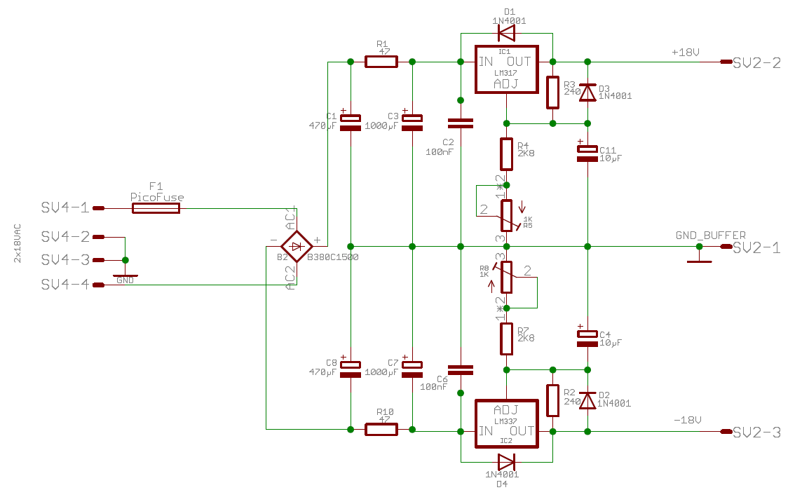

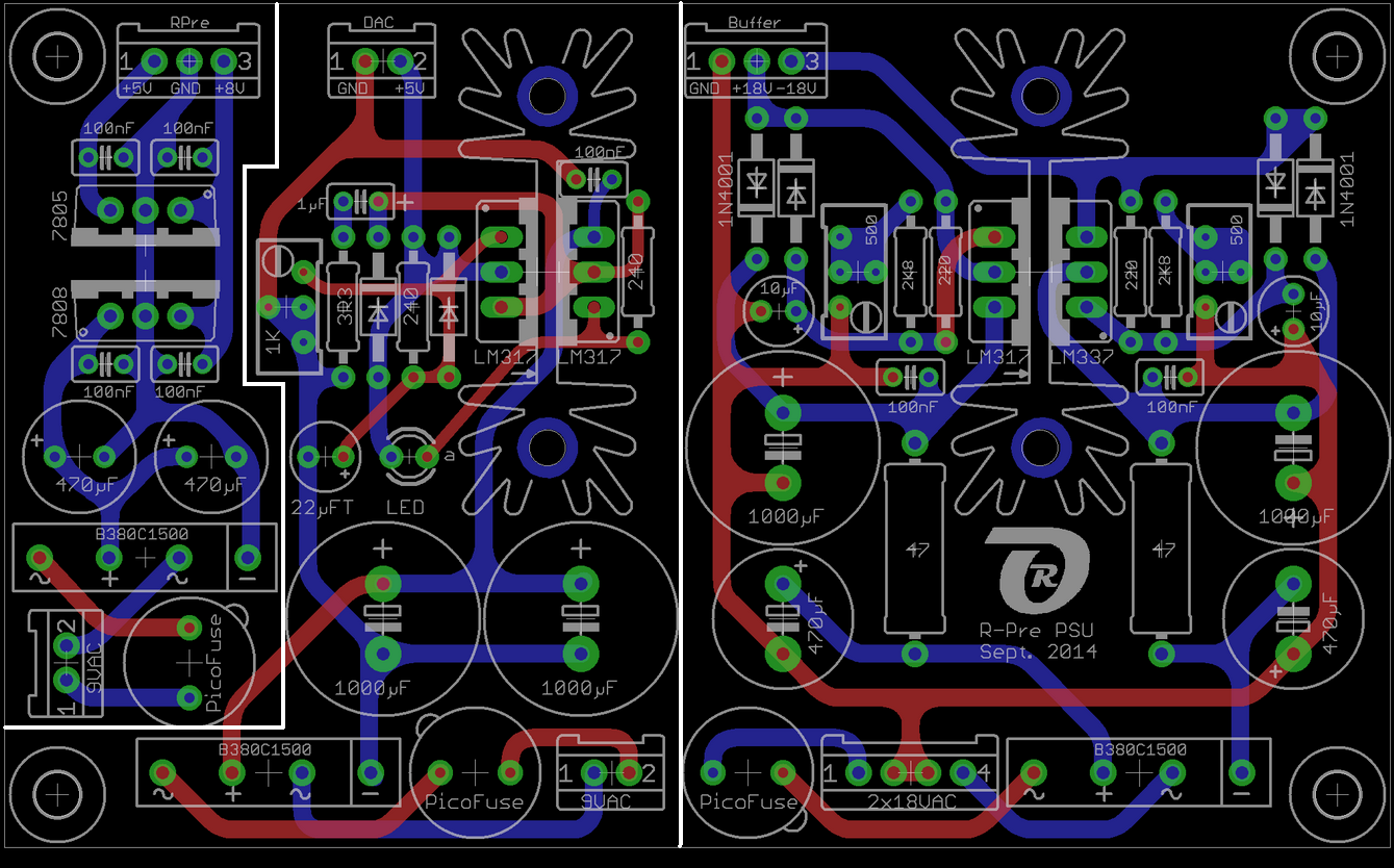

The PSU consists of 3 sections: a +5VDC / +8VDC on the left side for the passive PRE, a +5VDC for the DAC and a +/-18VDC for your buffer on the right side.
The "Buffer-PSU" is using a traditional LM3x7 ddesign (see image 3).
The 3 sections of the PSU work "independently" from one another.
The GNDs of the 3 sections are not connected to each other.

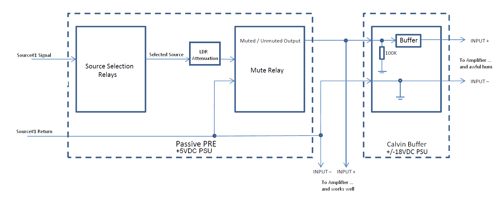

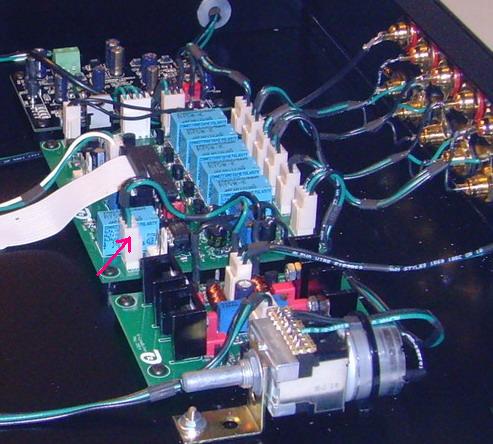

The source signals pass through a selection relay (see image 4), the LDR-attenuation and the mute relay.
The source's return-wire is not connected to GND on the passive PRE-PCB.
I have placed a 3-pole connector (Out-Left, Out-Right, Signal Return) on the output of the mute-relay.
When I run some wires from this connector to the RCA connector in the back-plane and connect an amplifier to it, everything works fine.
When I connect the output of the mute-relay to the buffer (see pink arrow on image 5), I have a persistent awful hum.
The R-Core connects to the PSU shown in image 2.

@Stormsonic:
The different GNDs of DAC, PRE and Buffer PSU are not connected to one another.
AUDIO GND (Signal Return) is not connected to either DAC or PRE GND.
It connects of course on the entry to the buffer PCB with the buffer - PSU - GND (have a look at image 4).
Best regards - Rudi
P.S. Joshua: I have sent you a PM.

P.S.,
Nothing connected to the input of the buffer means also not the ground from the preamp.
If when nothing is connected to the input of the buffer there will be hum, it means that something is wrong with the buffer, or with its' PSU.
If when nothing is connected to the input of the buffer there will be no hum, it means that there is a ground loop between the preamp and the buffer.
