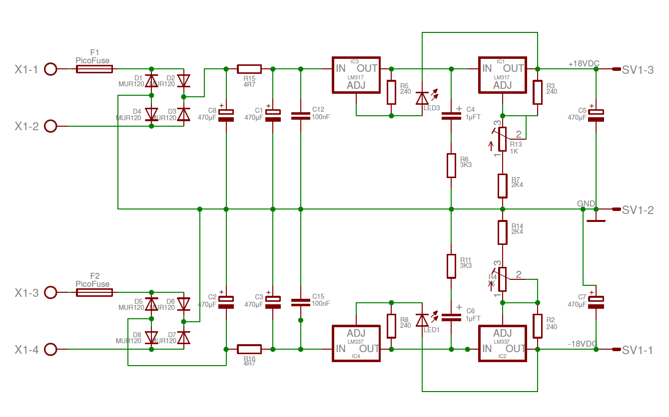

Your schematic is wrong.Joshua: the hum is present, even if no input (CDP, ...) is connected to the PRE (I need to verify this once more and ask my DIY-friend Hans).
I have placed 2 x 100µF capacitors on the buffer PCB near the PSU-connector (have a look at the image in post #617 please).
Best regards - Rudi
It shows the two terminals at the extreme left connected to the OUTPUT at the extreme right.
The transformer CT MUST be connected to the INPUT of the smoothing capacitors bank. i.e. connect SV4 -2 and SV4 -3 direct to the junction between C1 and C8. BUT also twist the AC wires together from transformer to rectifier and twist the DC wires together from rectifier to smoothing capacitors. The CT wire must be included inside that twisted group.
The 3pin regulators are also wired wrongly.
The adjustable VR must connect to the output node, as must it's capacitor.
The +ve regulator MEASURES the output voltage using TWO connections, one on the +ve side of the output and one on the Zero Volts side of the output.
If one of these wires reads the wrong voltage, then the regulator will give the wrong output.
DO NOT let the regulator read the ripple on a shared Zero Volts line.
Those are good points, however from the schematic posted it's impossible to know how the physical wiring is done.
Look again at the posted schematic, it's done this way. The adjustable VR is connected to the output node via 2 series resistors, it cannot be connected directly to the output.

This is yet another example where using the same term for all "grounds" leads to ERRORS. Make the diagrams unambiguous by showing the correct unambiguous terms for each different terminal.
The adjustable VR is connected to the "ground" line (or Zero Volts line) between C2 and C11.Look again at the posted schematic, it's done this way. The adjustable VR is connected to the output node via 2 series resistors, it cannot be connected directly to the output.
This point is at a different voltage from the INPUT to the regulator and at a different voltage at the OUTPUT from the regulator.
If you need the regulator to READ the OUTPUT voltage, then the VR must be connected to the NODE that is at the SAME voltage as the output. i.e connect VR and it's capacitor to the output node.
the long wire from the CT to the OUTPUT carries variable current.What do you mean by it?
That variable current passing through impedances generates variable voltages.
The voltages at the beginning and in the middle and at the end are NOT the same.
Stop calling everything "ground".
Give every different Return wire it's own unique label.

Thanks to the assistance of HESENER the problem that I have reported about my PRE / CalvinBuffer - build in post #632 has finally been resolved.
I have been using 470µF - 47Ohm - 1000µF CRC-filters in the buffer's +/-18VDC PSUs.
When I calculated the filters' resistor's value (47Ohm), I have anticipated a too small value of current flowing through the power rails.
The actual voltage drop across the filter's resistors has then been so large that the minimum input LM3x7 voltages have not been matched resp. have been "on the edge".
So the LM3x7 had a "tendency to oscillate".
I myself have not been aware of this problem, when I built the prototype.
Maybe the JFETs that I have used have a very low IDSS or the primary voltage in Hamburg is rated at 235VAC whereas in Stuttgart ..
Anyway: substituting the filters' resistors by a 4R7 value remedied all of my problems.

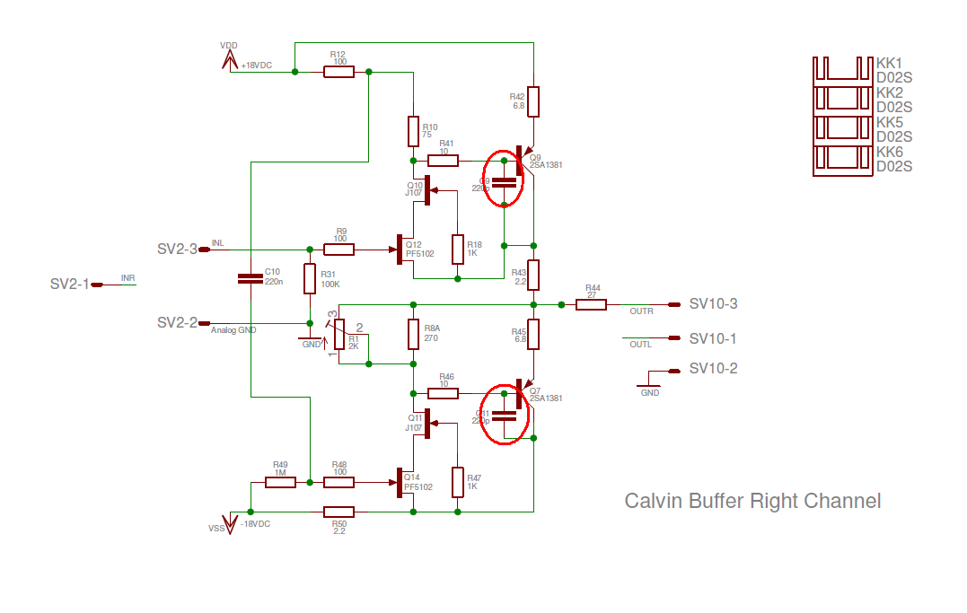

Calvin, it looks like your buffer cannot be as easily used as a "general buffer" as I thought (not being used in your Paradise phono stage board) - as I have told in my post above.
Being connected between a LDR - attenuation and a SYMASYM (which has an input impedance of about 20K), it shows a tendency to oscillate on its output.
Can this oscillation be remedied by increasing the value of the compensation capacitors (indicated by the red circle)?

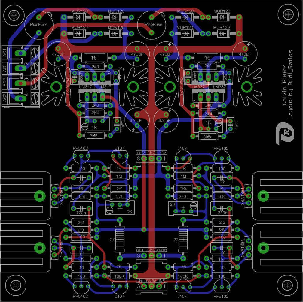

Calvin,
this is how your buffer will eventually look like - as least in my eyes / ears!
TPR-PSU and your buffer on a single 100x100mm PCB!
Best regards - Rudi

Rudi,
Just small comment, I am not sure if this can be of any help but I would suggest to review value of the R6 and R11 in your PSU. The purpose of this C4/R6 and C6/R11 circuit is to dump any eventual tendency to oscillation in PSU. As per information I found for 1uF capacitor there should be a few ohms value (3R3?) instead of 3k3.
Thanks for your PCB design!
rgds
-jacek
