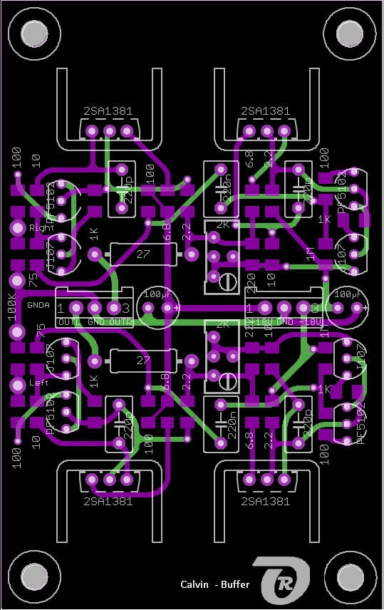

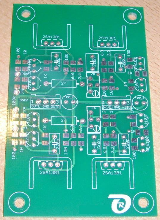

I have quite a couple of my own layout of Calvin's buffer, using SMD-resistors, left.
Since my eyes have grown old since I did the SMD-layout, I am no more able to solder the PCBs and will happily sell you Calvin's buffer for 5€ per PCB(shipping included!).
Best regards - Rudi_Ratlos

I'm not a big fan of SMD, but I've had pretty good luck soldering 1206 devices.
Will these boards accept 1206 devices or are they designed for smaller devices?
Too bad someone hasn't come up with a dual through-hole board. Perhaps that's something I may try to design in the future.
I need to hear one of these buffers first, though.
I see the 2SA1381's are obsolete. There are some on eBay, but who knows whether they are fake or not.
What input and output devices, that aren't obsolete, are recommended?

Rudi, how about the boards you have? Are they also designed for the small 0805 resistors, or something larger?
Thanks...
