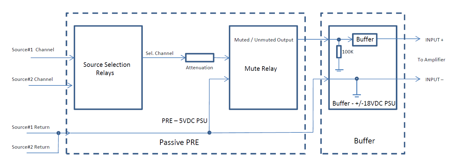

MUTE-Handling
Gentlemen, I am having a question regarding my own PRE-Amplifier's design on how to handle MUTE.
My design (2nd image, showing you a rough image) uses relays to select the chosen music-source.
(Image#2 is only showing the source-selection of 2 sources.)
The PRE uses a very ripple-free +5VDC PSU.
The selected music-source-signal is then attenuated by a schematic, which is based on a digitally controlled LDR solution.
The attenuated signal along with its return signal is then fed to a MUTE relay.
The PRE is followed by a buffer, having a separate +/-18VDC PSU.
As long as I do not press the MUTE switch, everything works fine.
But when I press the MUTE-switch: I hear a hum.
Muting an amplifier should be done by shorting the INPUT+ and INPUT- signals to the amplifier.
But in my case: INPUT- is connected to the BUFFER's GND and INPUT+ is connected to the BUFFER's GND via a 100 KOhm resistor .
Is this the reason, why I am hearing some hum?
How should I do the connections in my PRE?
Best regards - Rudi_Ratlos

And you are perfectly certain that you have not accidentally wired up the relay so that instead of shorting the signal to ground, it just interrupts it? You may want to verify that. With a 100k input hanging in the air, you easily catch a hum.
Otherwise it would have to be some sort of grounding issue that's not obvious from your block diagram.

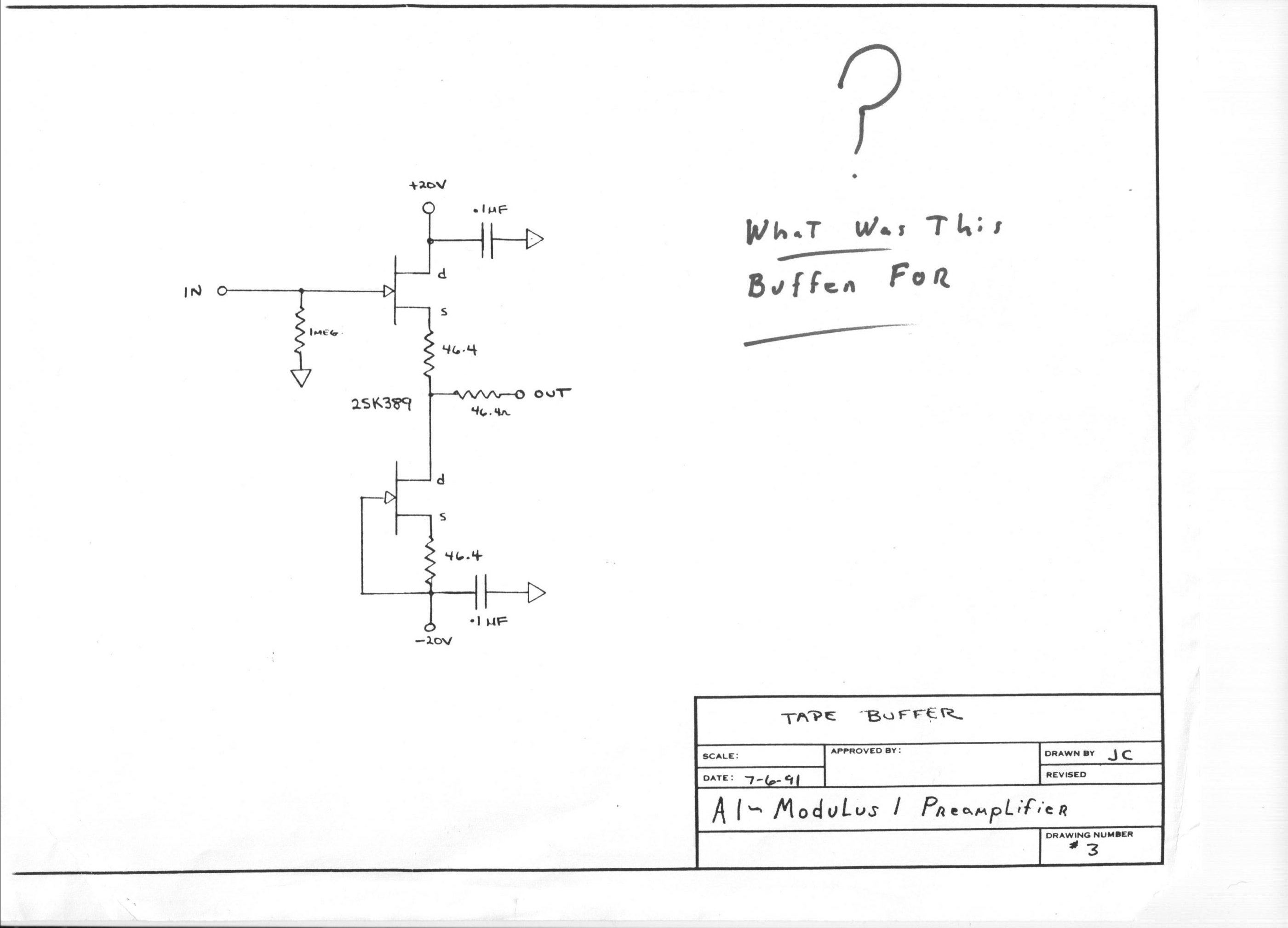

I have a 20 years old tube preamp, which has a tape out buffer designed by John Curl.
Feeding this buffer from IVC (Inductive Volume Control) is the most transparent 'preamp' I ever heard.
Do you know of any reliable sources for the 2SK389?
I see a lot for sale on eBay from Asian sellers, but have no idea if they would be fake, or not.
For very low DC at the output, the JFETs must be matched for Idss.
The load must not be too low Z or distortion will rise; something like >50K is good.
I thought the 2SK389 dual device was no longer made for quite awhile now.
Thx-RNMarsh
