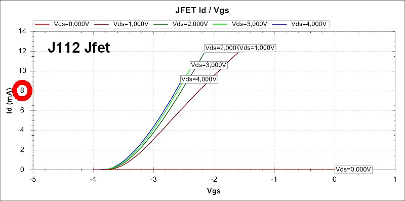

As this current is also running through J3 its gate-source voltage automatically sets to a certain value that can be evaluated from the Datasheet graph of drain-current over gate-source voltage (Id/Vgs).
Due to the high transconductance even large variations of drain current lead to very small variations of the gate-source voltage.

We need to find a Slave JFET now that ´gives´ the Master a drain-source voltage of a couple of Volts at a couple of mA drain current, say for example ~-4V and ~8mA.
In the attached Pic You find the Id overVgs simualton of a SST4391.
The Datashet specifies:
For a gate-source voltage of 0V the drain current Idss can be between 50mA and 150mA.
For a negligibly low drain current Id=10nA the gate-source voltage (Vgs(off)) may vary between -4 and -10V.
The simulation gives us: Idss= 103mA and Vgs(off)~-5.8V
Following the graph a Id of 8mA corresponds with a Vgs of -4.2V.
This way You may find the right Slave JFET.
In short: Idss of >50mA, Vgs(off) <-3V, Vds(max) >30V.

How about J111 with Vds=-35V, Idss min 20mA, typical 50mA and Vgs(off) between -3V and -10V -- when selecting samples for desirable Idss and Vgs(off)?
the graph in #352 is characteristic for all JFETs.
To evaluate if Your candidate is suitable for the cascoding task have a look in the datasheets and the graphs.
If the DS contains only specs but no graphs, then you can estimate the Vgs at a certain Id in a first aproximation by drawing a straight line in a Id over Vgs graph instead of the real bowed curve.
The end points of the line beeing the Idss value at Vgs=0 and the Id value at Vgs(off).
If the result at a Id of ~8mA is less than -3V Vgs then the JFET should be fine for the task.

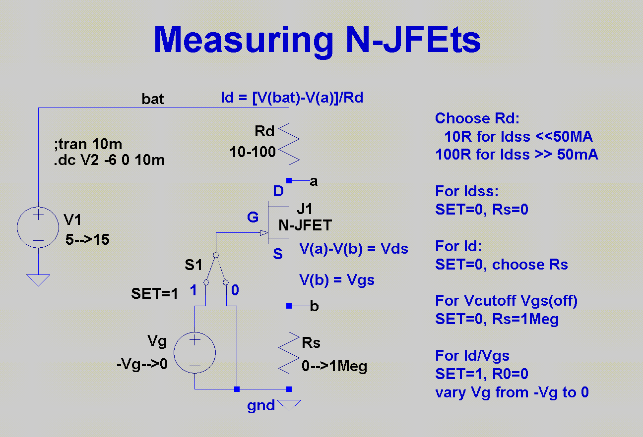

Attached is a easy schem how You can determine the critical values Yourself.
V1 may be a constant voltage power supply or a battery.
Rd is s measuring resistor to determine the drain current.
Choose V1 and Rd so that V(a) is similar to the idle working point of the later application.
A value around 9V suits best.
Vg is a variable negative voltage source. If You only have a constant negative supply at hand You may connect a 1Meg Poti from Vneg to gnd , the wiper going to the Gate.
Rs may be made from fixed resistors or a 1Meg Poti connected as variable resistor.
Following the instructions You can evaluate Idss, Vgs(off) and the Id versus Vgs behaviour.
As the manufacturing process of JFETs includes rather high tolerances the Values of Idss and Vgs(off) vary over a large range.
Manufacturers apply preselection into 2-or 3 Idss classes.
This preselection may already be good enough, as the value of Vgs of the cascoding JFET plays only a minor role for the output offset of the circuit.
Values of Vgs +-0.5V are still fine.
But if You want to achieve lower Vgs tolerances this easy screening method will suffice.
