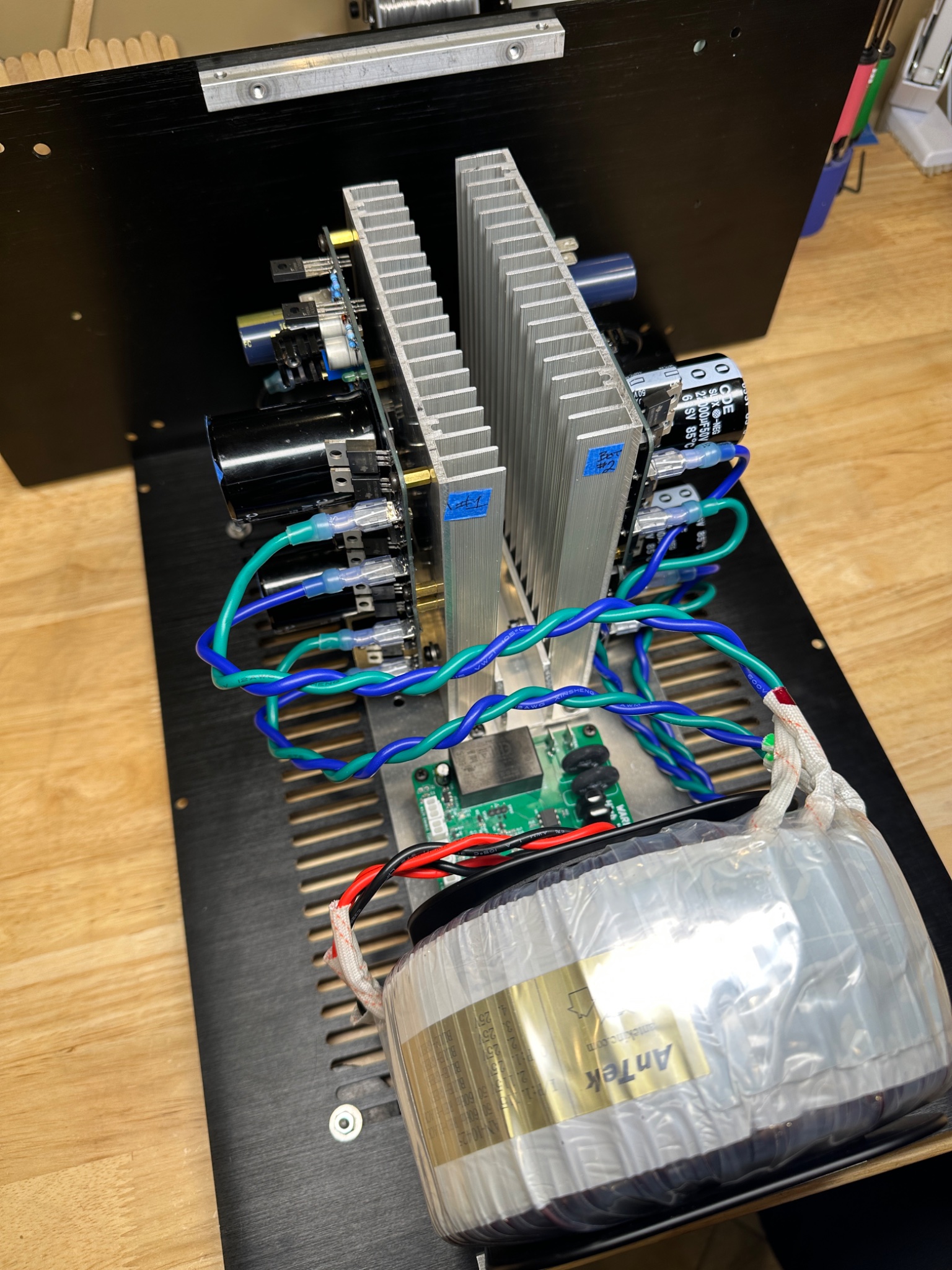

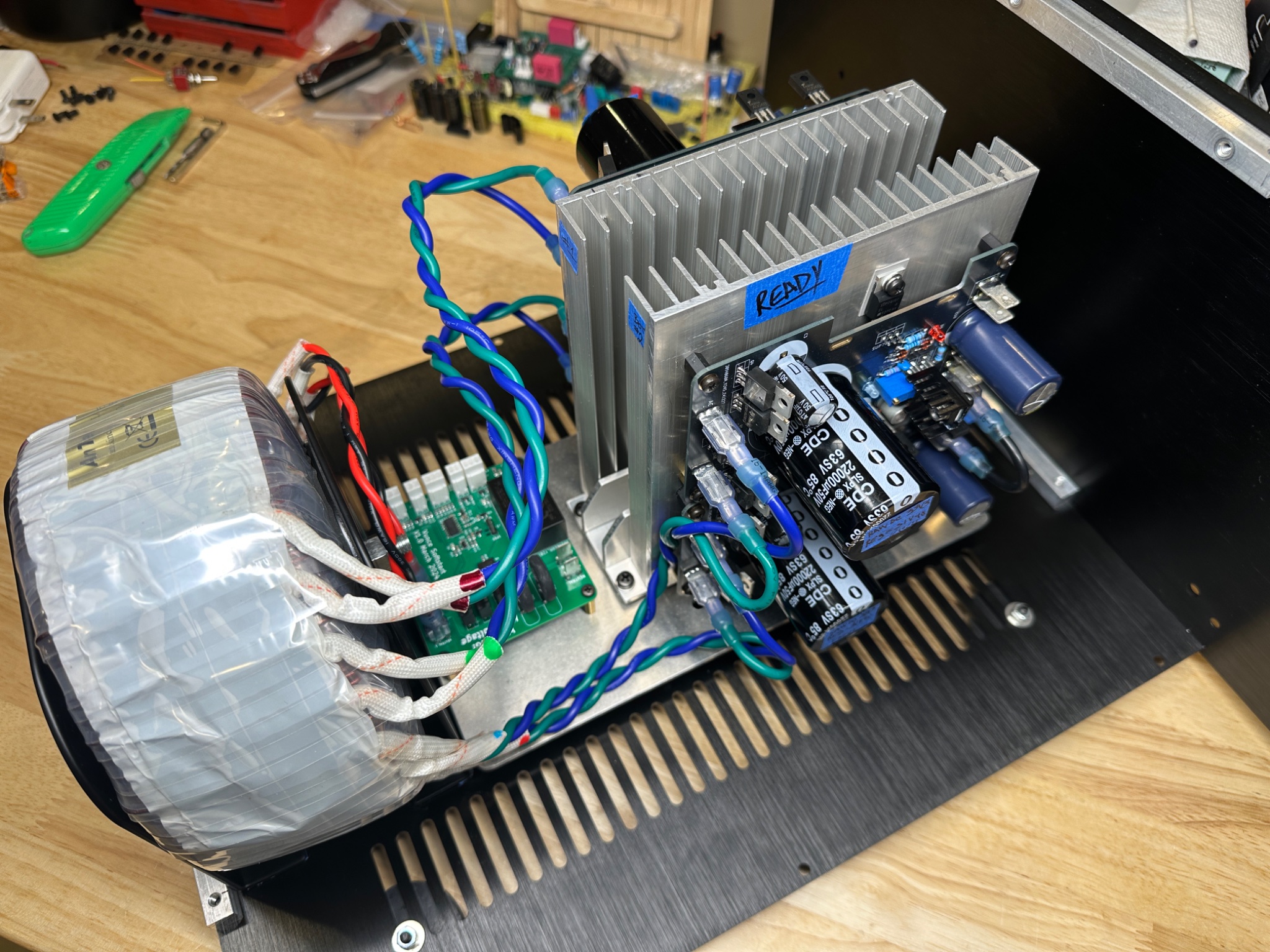

I used DUELUND 12 gauge cast jacket. I had it available and I like it.
The four 10mF caps are on a perf board with the leads in the middle which is likely not optimum but that was the best way to integrate. I can always change it if told it should be linear. I would change it.
The caps are placed so the the leads are available from the bottom (the tops are on placed on a piece of wood) which allows a short path to R25 in my installation.
From there to the stub of the snap in on tombo's board.
I could not take a photo that would show it any better than my explanation.

Twisted, heavy gauge wire as short as possible would be my approach to connect off-board caps. But, what would be too long for "as short as possible"?
Using AWG 15 – 14 (1.6 – 2 square mm cross section), any length required inside amplifier’s case is not too long for the proper performance. We should keep length at the possible minimum to minimize radiated 100/120 Hz noise. Reservoir capacitors are charged with short high current pulses and that produces strong EM fields. By twisting two wires together, most of two opposing EM fields cancel out, but enough remains.

Foundation is ready :spin:.
You nailed it Anand 😉.
That trafo saved me big bucks!
At first, Toroidy was going to get the call🤑🤑
Edit:
The 25V secondaries deliver 26V5 output under load. Perfect for a little regulator dropout headroom.
Regulated output: +/-32V
