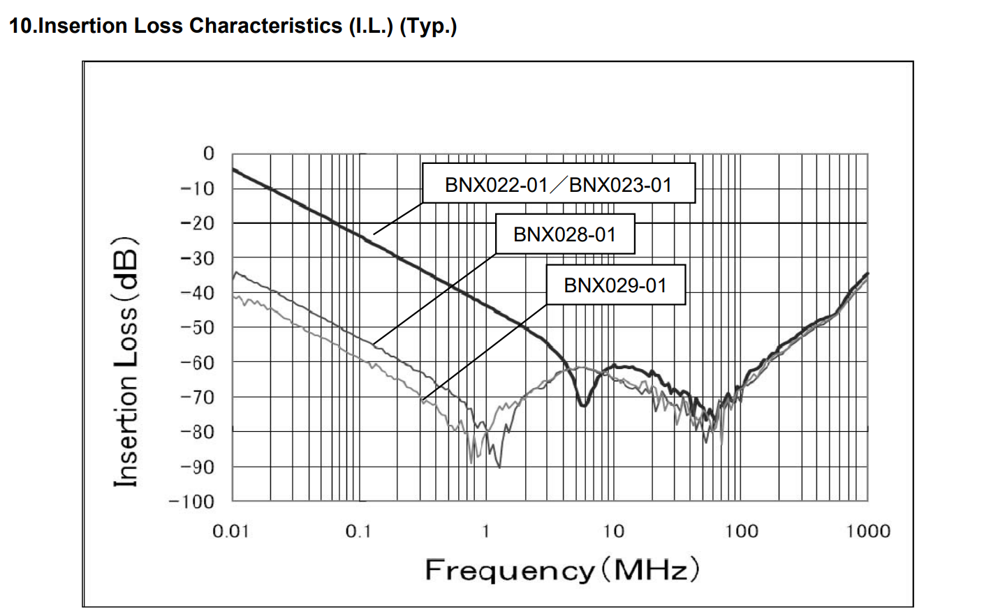

There is no need to sacrifice all RF filtering at voltages above 50V.
There is a filter in the same form factor rated at 100V (BNX023-01). Sure, you lose several dB of PSRR, compared to the default filter, but not much.
So, 'official' recommendation for 50-60V range is to use filter with this part number:
https://www2.mouser.com/ProductDetail/Murata-Electronics/BNX023-01B?qs=/%2BPMR94VuMYPshF2N9CBoQ==
That was an epic fail from my side, not to check before. 🤣
I was focused on max. filtering performance and reasonably high voltage. Those BNX026 were bought years ago and tested during R21 development and are still better choice. But, some RF filtering may be better than none.

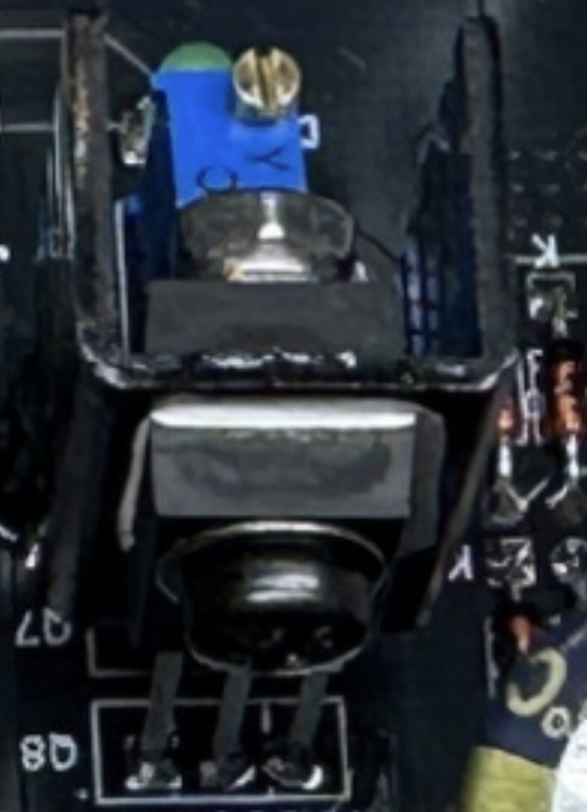

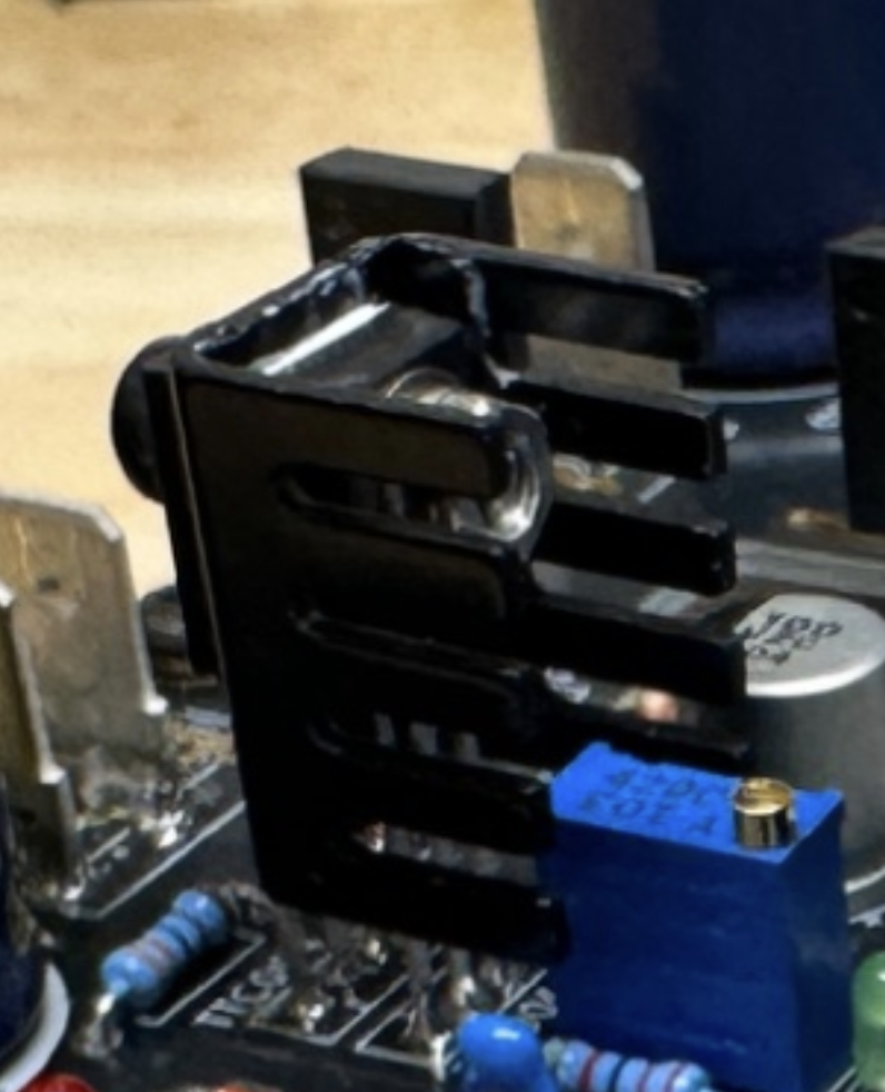

Small heatsink from the BOM fits without any problem.
I have been spying on @Vunce and other people who know better:
For Q7 and Q8, it appears it is 1 shared heat sink.
Facing the trimmer, the TL431 gets in the way a lot, facing the other way I need to give enough clearance to the resistor.
But, unless I am missing something, it's a shared heat sink no matter what, right?

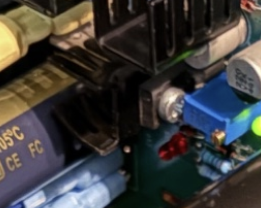

Yes, one heatsink sandwiched between the BJT’s. Just a dab of goop on the backside of each.
Fitment:
The TL431 was mounted low to the pcb, the heatsinked assembly was mounted high so the lowest “finger” just cleared the top of the TL431.
In order not to stress the leads of Q7/8 and a flat fitment to the heatsink they should be removed. Assemble separately then install back in the board, make sure to double check the orientation of the pins is correct.
If you have fresh BJT’s, use those with uncut leads so you’ll be able to clear the TL431.
