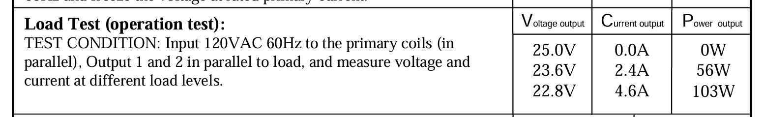

Seems fine if it is 2 X 25V. What is typical mains voltage in your area. 25V output is specified for 120V input.
It varies by season. Tends to be 115V in the Summer and 120V in the Winter.

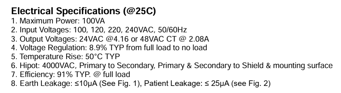

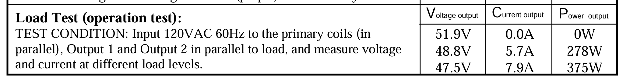

You are right, the Antek is tested at 120V, but is in fact 2 X 24V.
I also found this one:
https://www.antekinc.com/content/AS-1224.pdf
Which I like even better because of the shield between primaries and secondaries. It is also 2 X 24V.
Then, it is safe to use 50V (2x25 at no load) as input voltage at C2 and LT4320 will not surpass 70V under any conditions, worst case being during winter and no load at the supply output.
It will never be at no load in practice, so even though that 2X24V Antek gives 25V at no load, my guess is it'll give between 24.5 and 25V at something like 0.25 A. In other words, it should be fine.
I think I am settling on:
@Vunce Do you concur? (movie reference; 10 points to anyone who guesses)
EDIT: I sent an email to Antek to have them confirm what kind of Load Test characteristics I can count on if I wire the secondaries in series.

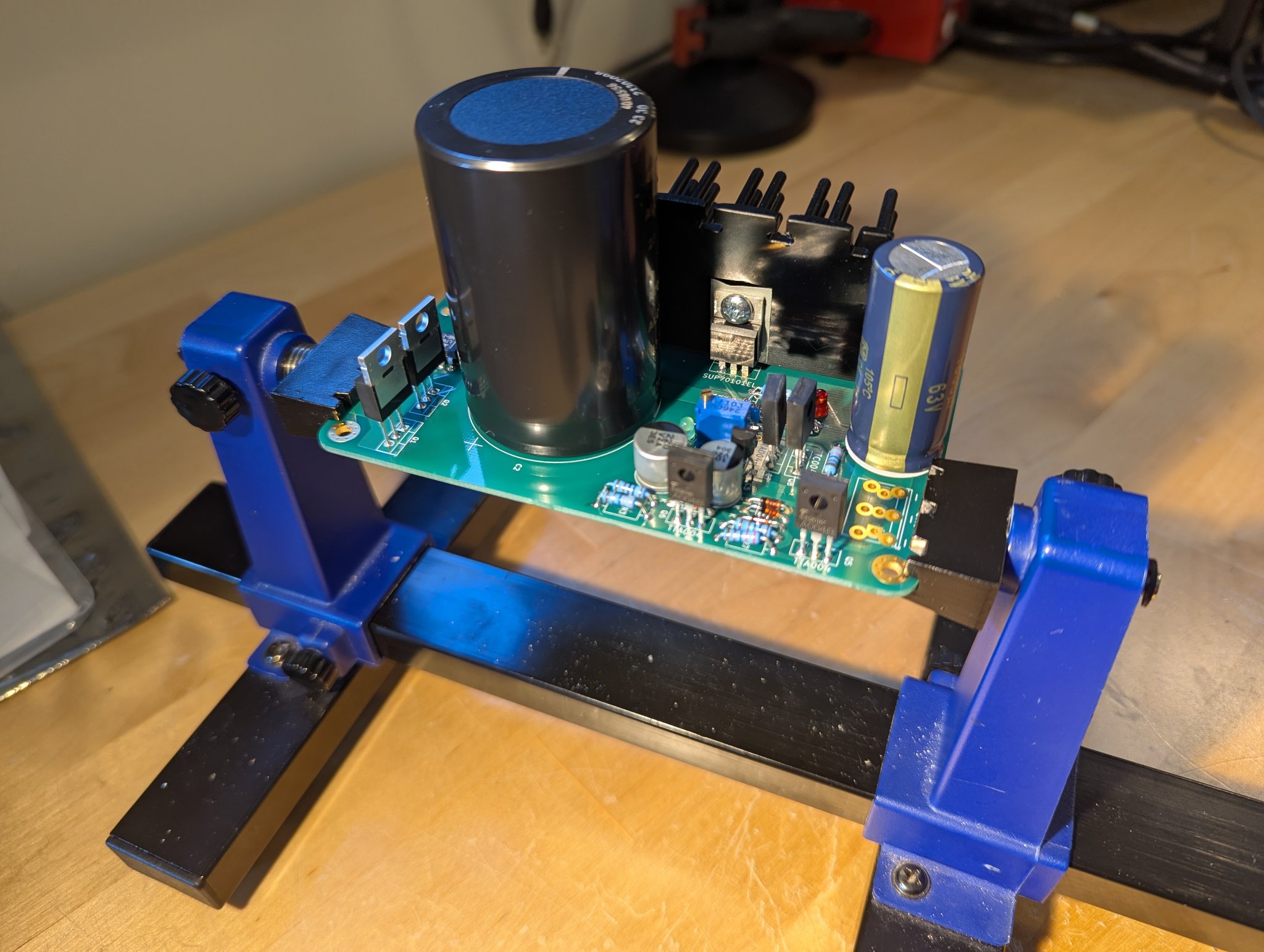

Another board assembled. Finished this one yesterday. Got frustrated messing with the heatsink clip and just drilled and tapped a hole to screw-mount the MOSFET.
Power transformer is in the mail; haven't actually tested it yet. Was fun to do some SMD soldering by hand; only had to fix one little solder bridge on the tiny op-amp. Glad @tombo56 advised soldering that part last; absolutely the right advice.
Thanks for the hard work on this design, looking forward to trying it out.
Additional work, but definitely better thermal transfer for the MOSFET.
Definitely worth it. I spent more time messing with the clip than I did drilling and tapping one measly little hole, for which I didn't even bother with the drill press. Highly recommend this approach for others building the board, provided you have a suitably sized drill bit and tap available.
I think that's what I'll do too. I remember struggling with clip-based sinks before.
At an output of near 60V, Q5/Q6/Q7/Q8 will get small wing sinks too, but it seems back-to-back sinks for Q7/Q8 could be a challenge, space-wise.
