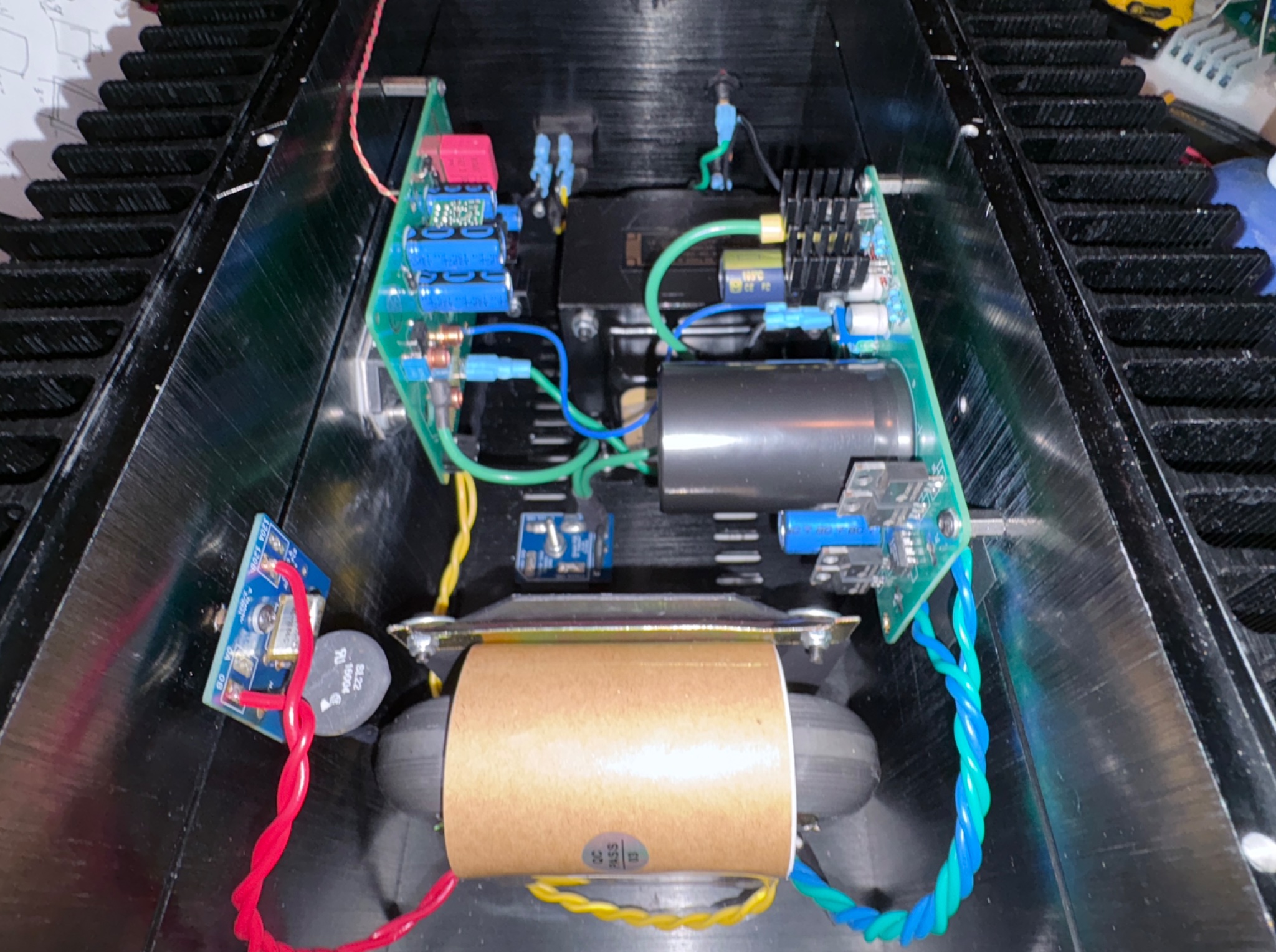

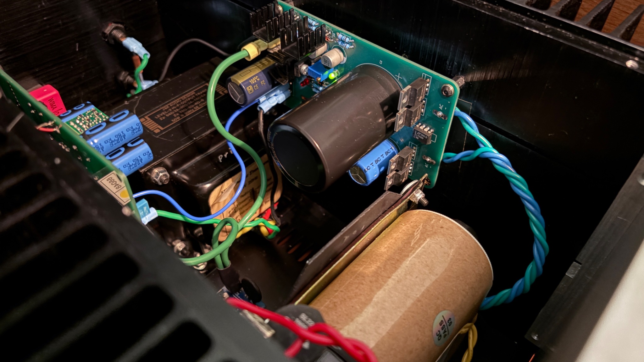

Finally got around to transferring my SIT OPT amp into dedicated monoblocks, which gave me the opportunity to use the R21 PSUs. Everything performs as expected in comparison to the modules. I really like the soft start - plays perfectly with the depletion parts.

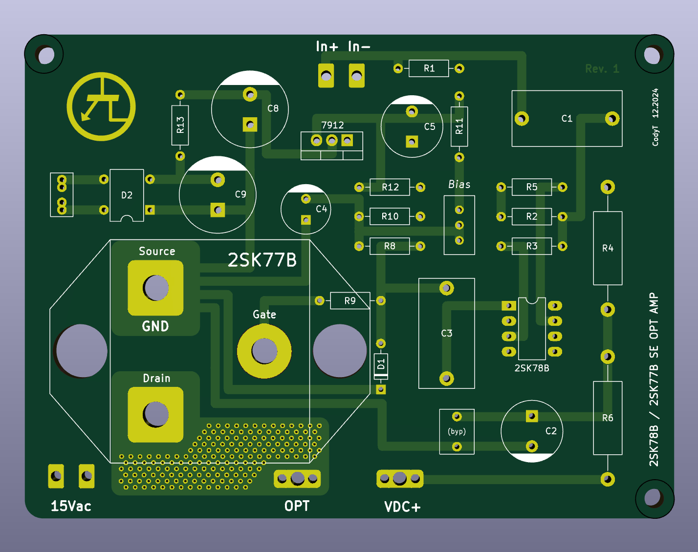

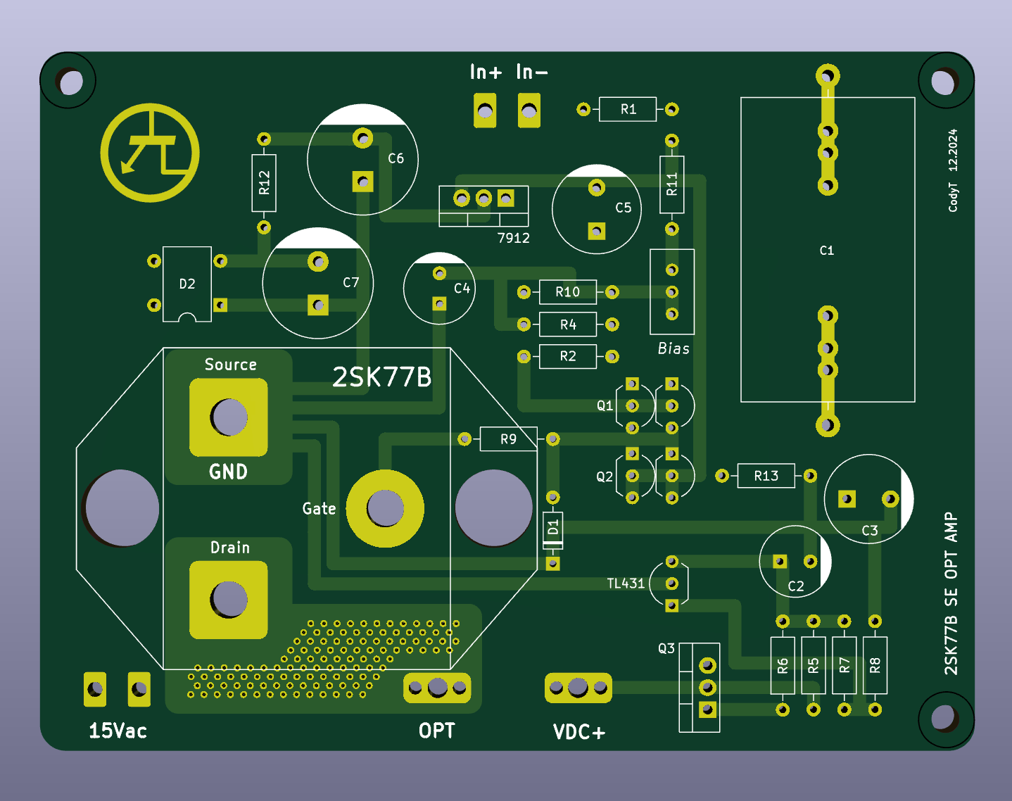

No, a few months ago I ordered a pair of custom output transformers that are spec'd more toward use with solid state, and I've been creating circuits for them. Using the same board dimensions, which makes it easy to swap out and test. So far I've got a common source output stage with buffer in front (Singing Bush inspired), a two stage circuit with SE SIT CS front end and SE SIT CS output, and am currently working on a SE SIT CS FE with common drain SIT output. Basic circuits, but they sound pretty amazing and this PSU plays a big part in that (inherently bad PSRR with these circuits). Hope to make a post soon to share findings, measurements, files, etc.
Very cool project for these VFET unicorns, Cody.
Look forward to reading more.......when you're ready of course.
In tha way, wouldn't the upper one be heated by the lower one so ending up in different temperature zones... is that wise?
Yes, I've had them for a couple months. I ordered the version that is modeled after the Tango FG-50S. The only change I made was to use a 50W core, allowing for higher bias current. Primary taps are 64/32/16 and secondary are 16/8/4. The quality and performance of these J&K transformers appear to be top notch.

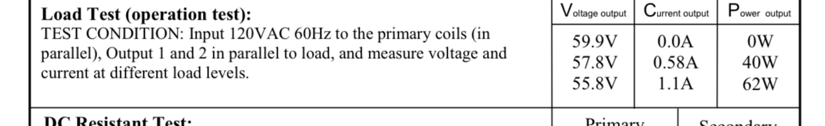

Almost certainly not the intended use case, but let’s say I want to use this transformer:
In operation, the peak current draw would be below the example 0.58 A scenario. (let’s say ~ 300 mA at quiescent state)
Can I expect 57V of regulated output?
Can I/should I use 10 mF @ 100VDC for C2?
Replace R8 & R9 with 4K7 & 3K9 values.
Use onboard heat sinks as in BOM?
I realize this is designed to deliver much more current, but I have an unusual use case at as close to 60V of regulated output as possible, with up to .5 A of draw.
52Vac trafo secondary is max.
Thanks, Vunce. Back to the drawing board.
Juice for Ra7’s preamp perhaps?Can I expect 57V of regulated output?
60V output is OK, but without RF filter as Murata declared it for 50V max. Another limit comes, as Vunce pointed out, from the LT4320 allowed voltage range.
