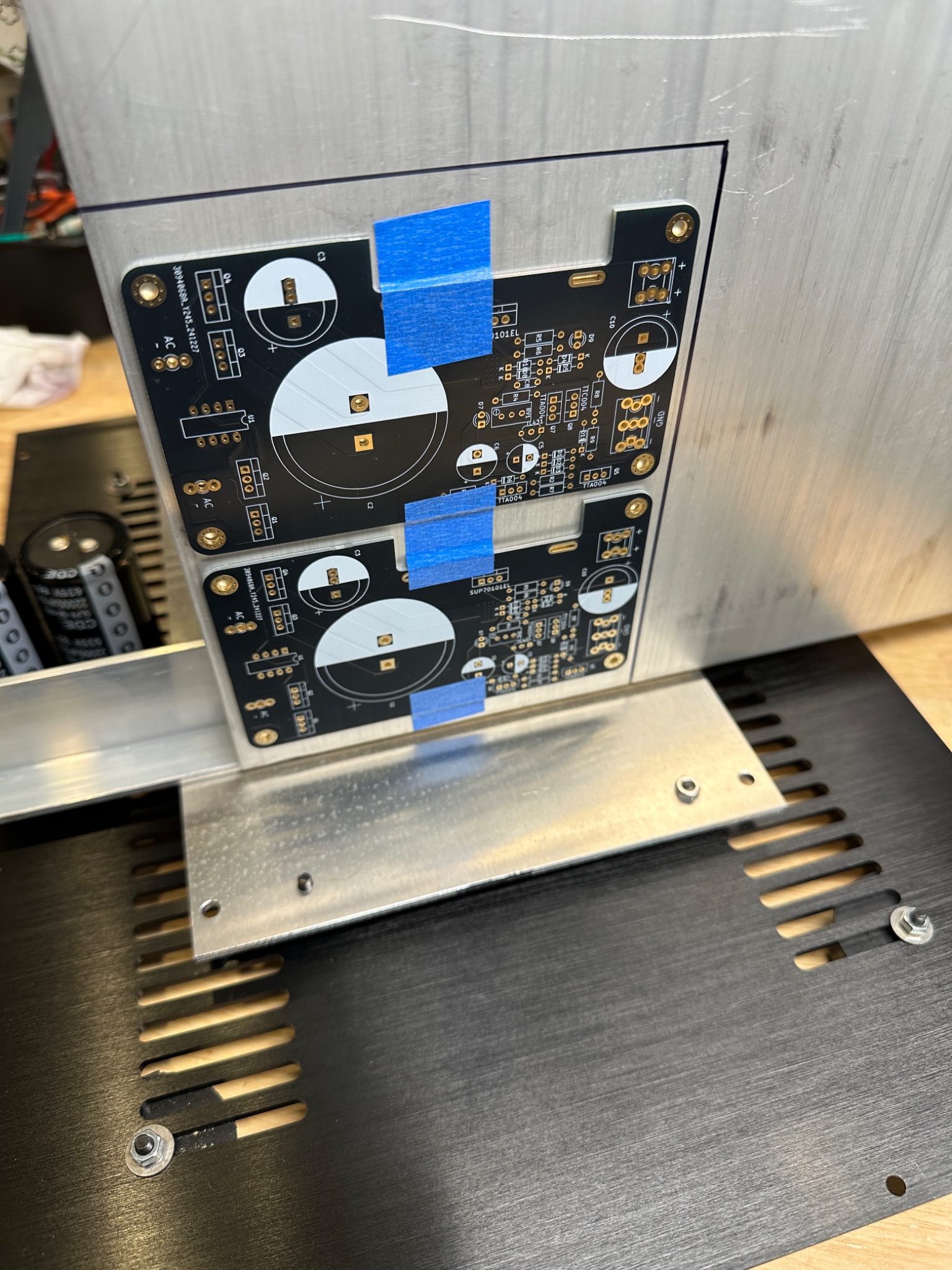

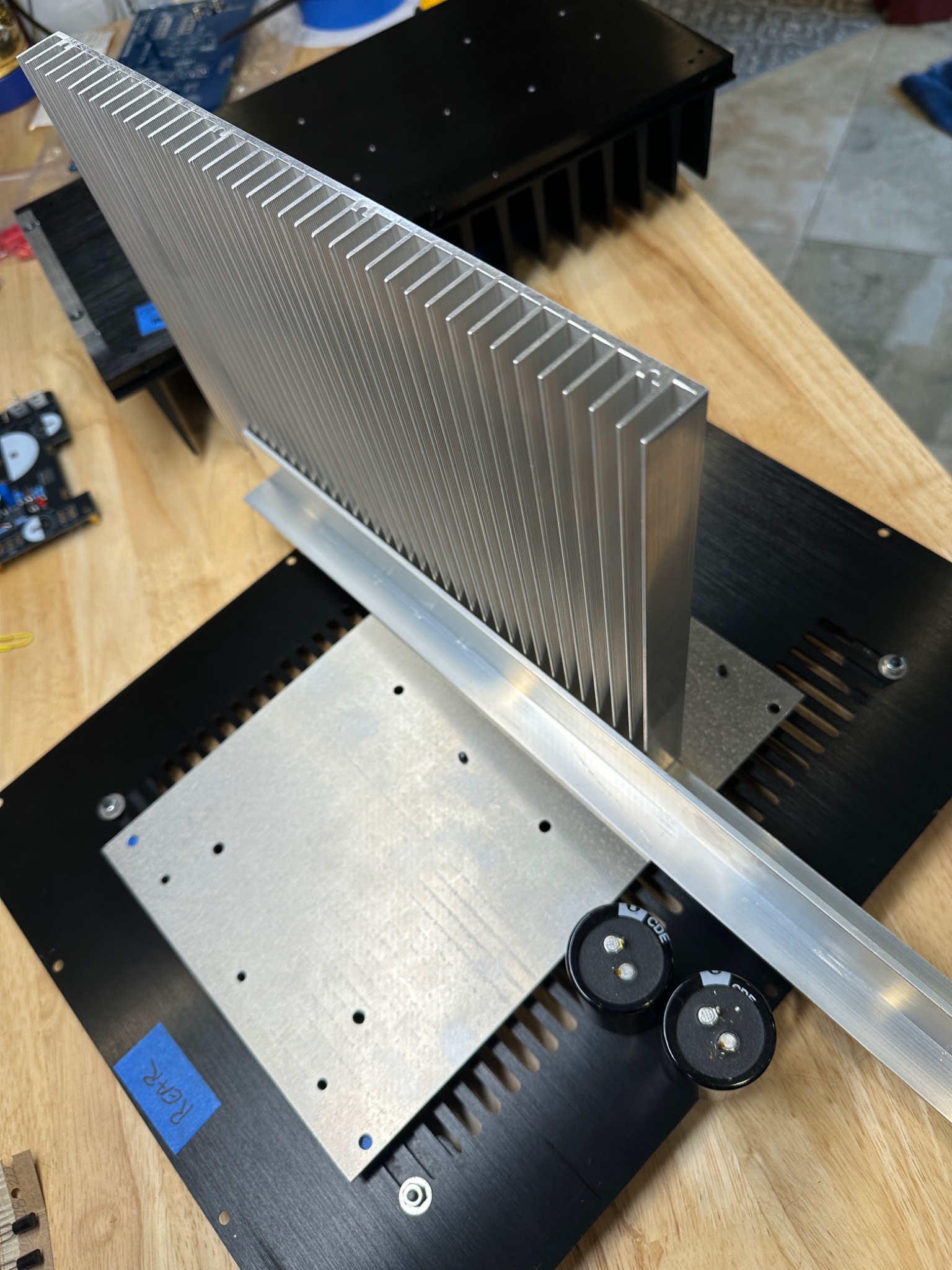

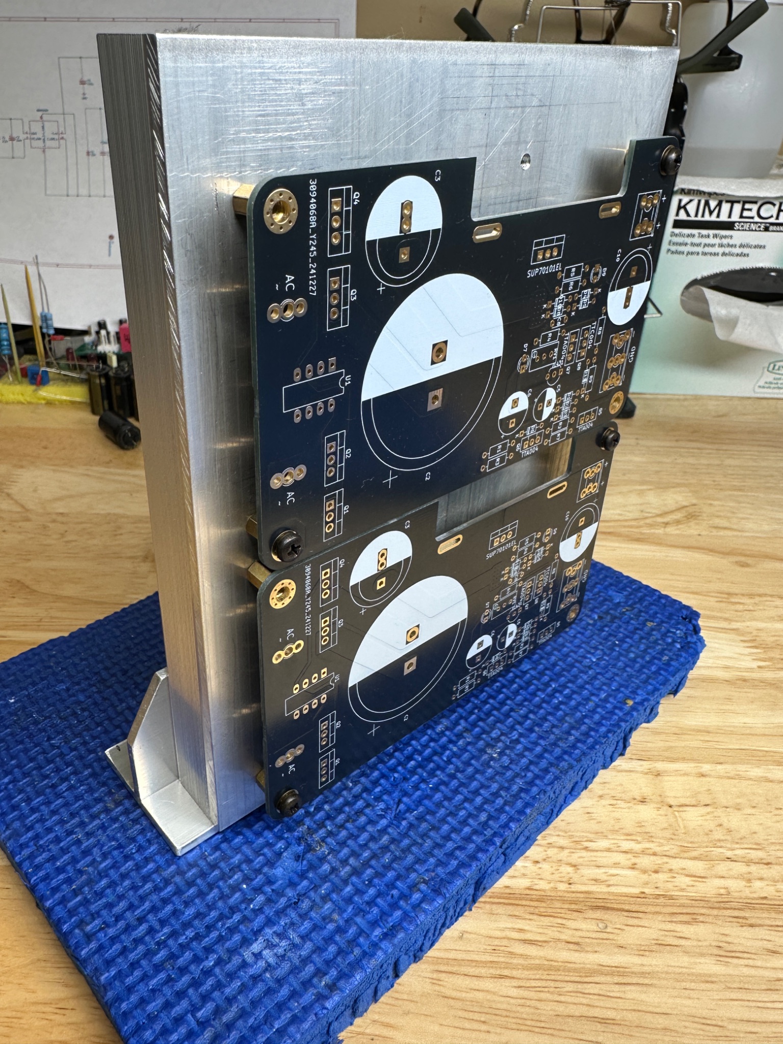

Hi @tombo56,
I’m in the brainstorming planning phase for my XA252 build.
The psu will be using two pairs of R25 modules fed by a single Antek AN-10425. The trafo will mount vertically at the front of the chassis. My current idea is to mount one pair of R25 modules on a heatsink installed vertical ‘card’ style on an aluminum plate, two cards required. The psu baseplate will attach to the chassis baseplate by M4 10mm brass standoffs.
Feedback is always welcomed from all🙂

Lot of ‘real estate’ with those heatsinks. 🙂 I like your build plan.
Antek transformer will provide some 33-34V at the C2. I see your reason to go with the 50V capacitors. If Iq will be 1.7A, with 22 mF C2, ripple will be about 650 mVpp. Minimal allowed voltage drop, for full performance, will be then about 0.6 V. I think that no additional capacitance is required.
Connect supplies as proposed in option 1.
Reading your build recommendations on post#1, I knew I was on the verge with the 22mF caps. 👍🏻
The heatsinks will be just shy of 180mm’s tall, R25’s won’t break a sweat.
Connection option #1 gives an additional faston tab for speaker return at the same location.(if needed)
Time to get cutting, drilling and tapping… Good times in -6°C temps 🥶
Thanks Tombo!
Thanks Tombo!

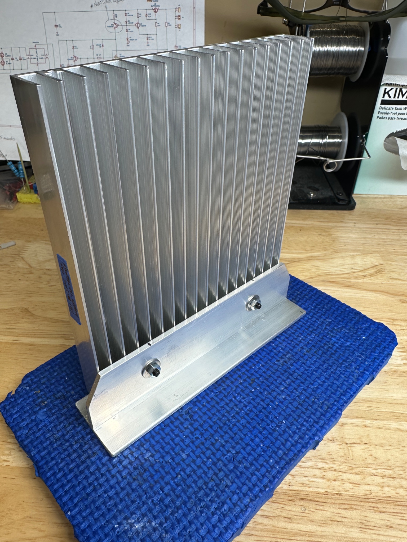

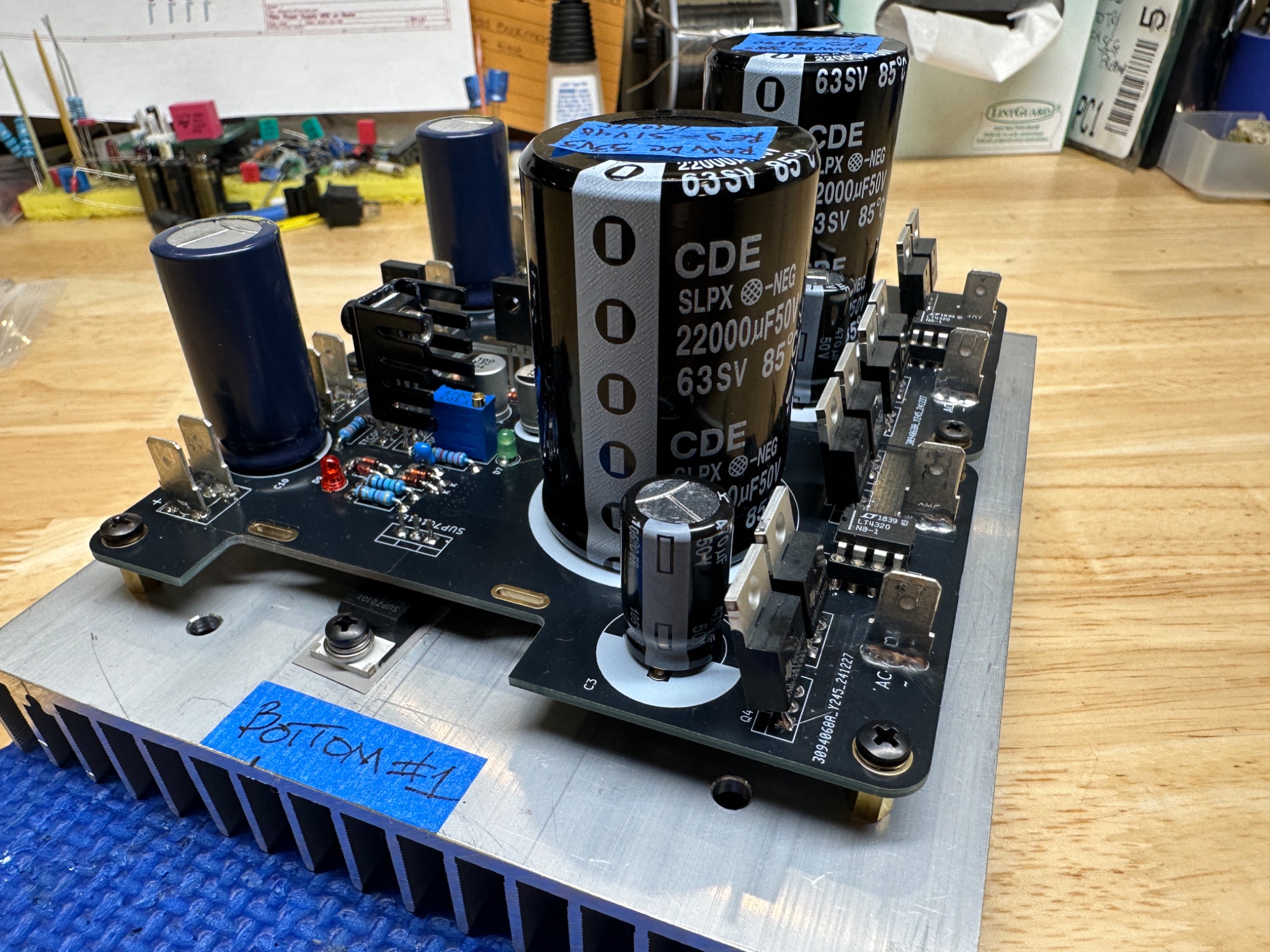

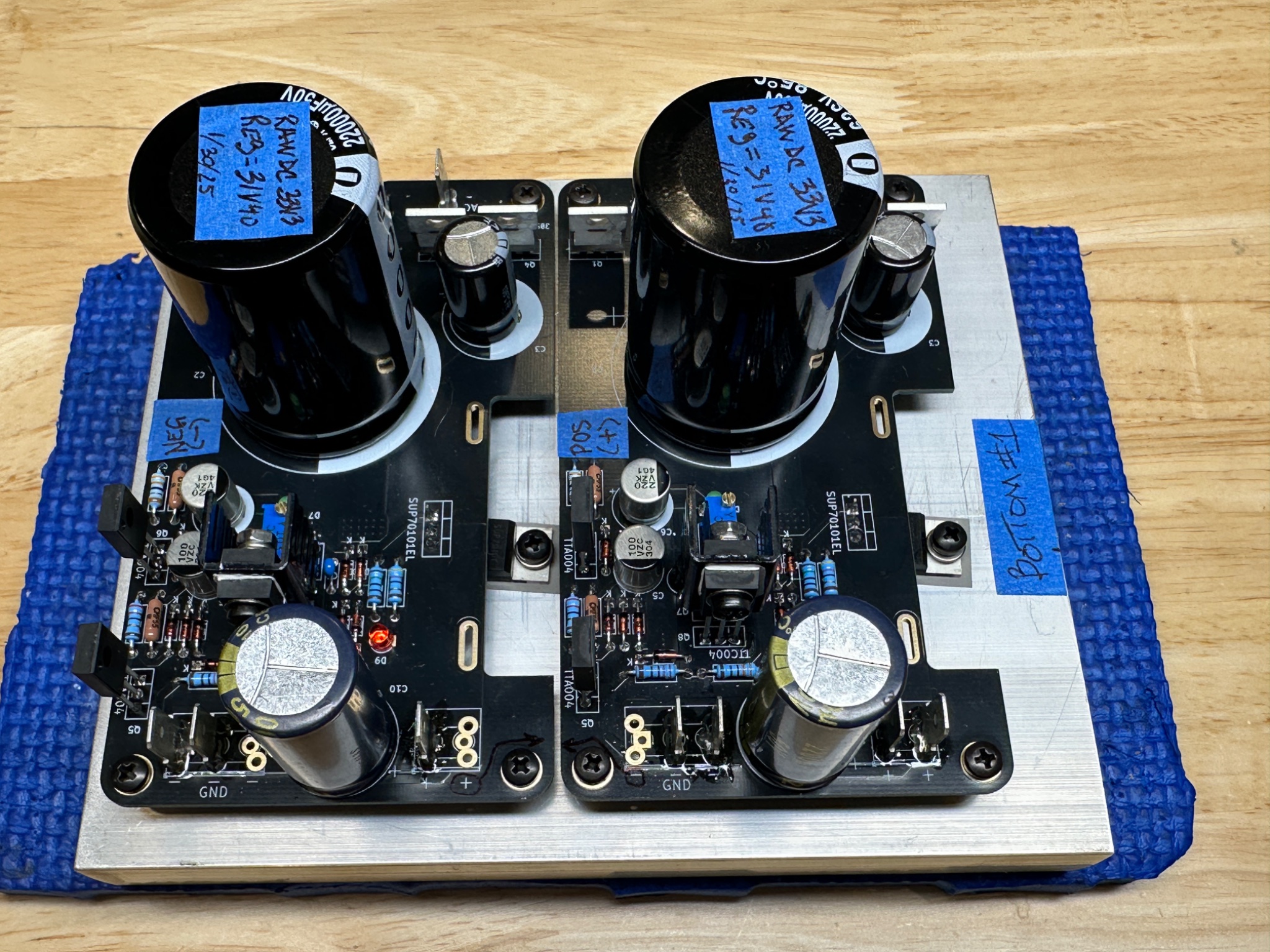

Made some progress on the R25 PSU this week.
Cutting, drilling and tapping of the aluminum material is completed.
Two of four R25 modules are completed and successfully powered up. The second pair is bare and waiting for more parts.
26VAC input
33V30 raw DC
31V40 regulated output with 500mA load.
Q6 gets a bit warm and will get a heatsink, Q5 can stay naked.
More to come…..
26VAC input
33V30 raw DC
More to come…..
Well done Vunce, you are always looking for new ways to improve the build, improve the chassis design and make it easier overall.
Ha, I see there an appropriate solution for a guy with few amplifier builds per year. 🙂Instead of stacking boards, I'll try vertical 'cards' similiar to how Accuphase stuffs their chassis.
You can easily move supply module from build to build, and it doesn’t take too much space. 👍
