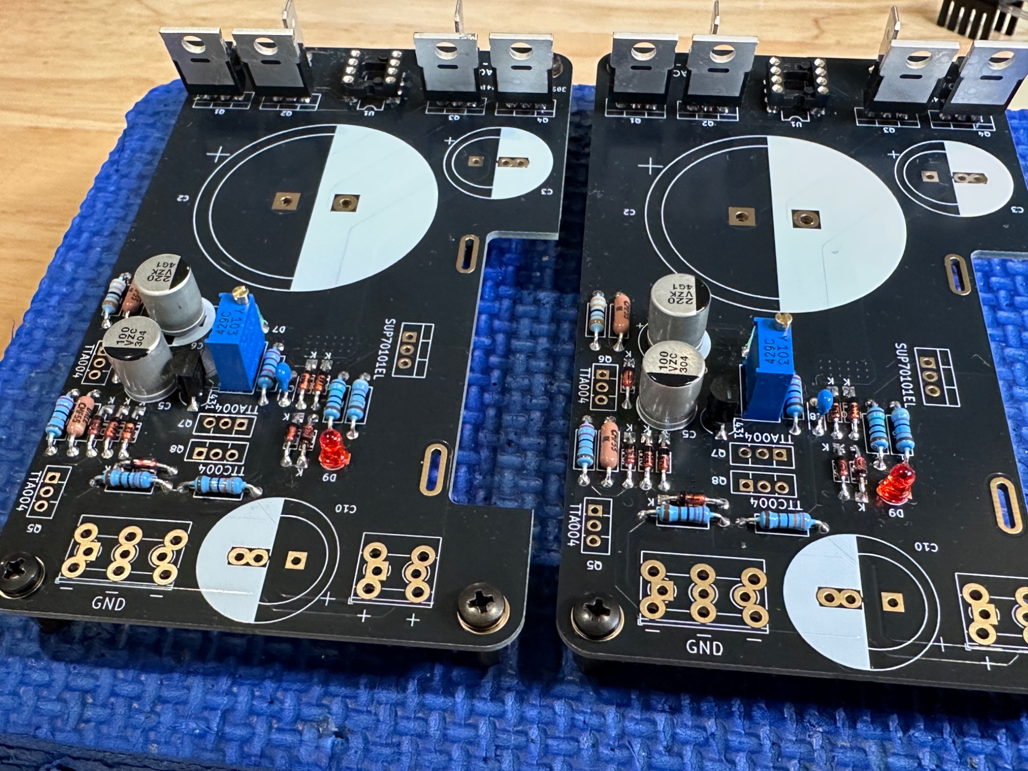

Most components are populated, but stopped at this point because I am still undecided what shape of aluminum Q9 will be undermounted to for heatsinking. I'd like to mount both boards on a single piece of thick aluminum plate to have a bipolar psu that can be used universally in different amplifiers. Drawback for this method is fitment won't be ideal depending on amp chassis. Probably best to build specifically for the amp it will be used in and forget the "universal" useage. Just build more R25's!!:rofl:
I did find a small tweak for the BOM...
Currently the trimpot is a 'Y' version with offset pins, for best fitment an inline 'W' version should be used.
Here's the Mouser link for the trimpot:
https://mou.sr/429Agb1

Nice work so far Vunce, I noticed the issue with the trimpot as well, picked it up just before a Mouser order - good to see you posted about it.

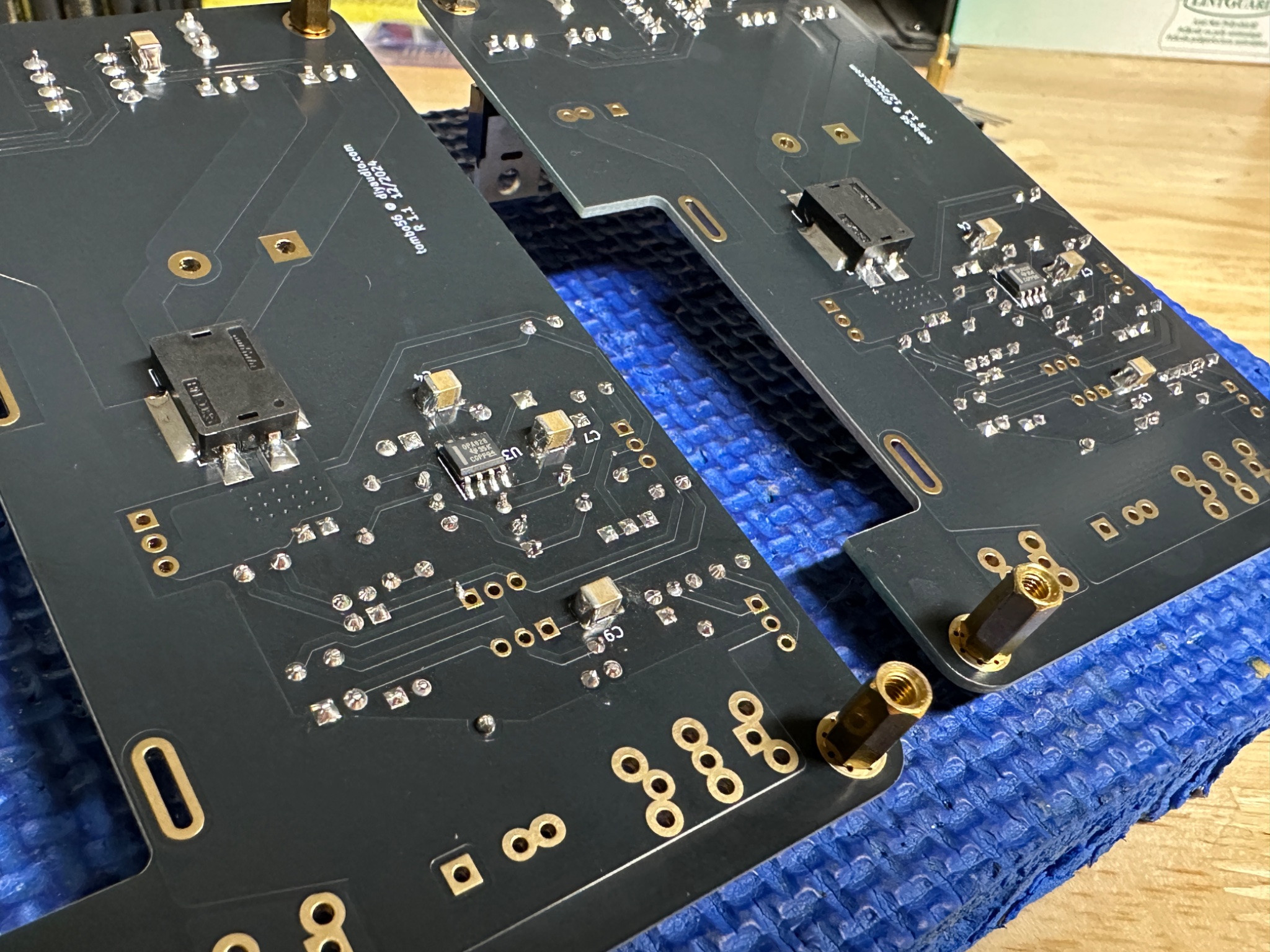

Good catch Gary. A bit of precision bending and my 'Y' transformed into a 'W', hehe!!
Since this board only has a few SMD components, they are all soldered with an iron.
The caps and EMI filter were soldered with 1.2mm chisel tip(T15-D12) and a 1mm bevel tip(T15-BC1) for the opamp.
Kester 0.015" '44'rosin core solder, apply a small blob of solder to a corner opamp pad, spread flux on each pad with the tip of a toothpick, pick and place the opamp into position. Wet the bevel tip and touch the edge of the opamp pad while gently holding the opamp in place with tweezers. As the solder melts drag outwards. Then do the same for the corner leg diagonally across, now that the opamp is stable the 6 other legs can be finished off. Be careful not to overheat the little bugger!
Mouser cart was updated, along with the Excel BOM, before your order. If I check Mouser cart, it is presenting the right trimmer (with inline pins) for me. Is it the same for you?
EDIT:
Hmm, now I wonder if picture at Mouser is simply wrong and part number is for trimmer with offset pins.
