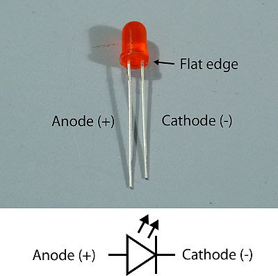

Even with Q6 reversed, green LED should be lit. It may be that LEDs are reversed? When placing, shorter LED pin (marking cathode) should go through square pad.

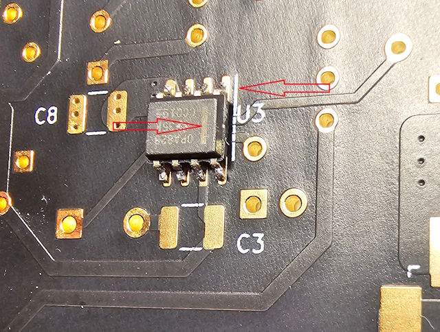

Next check point is opamp orientation. Lines on the opamp and silkscreen should be on the same side.

I was careful with the LED placement. Certainly thought I was but anything is possible.

If everything is in the right place, green LED must be lit. Reversed LED prevents current to flow and it would disable proper operation. After desoldering green LED, check with multi meter if it is OK, but put a new one.
The LEDs I received have no flat edge so the only way to be sure is to replace them which is what I did.
Opamp is oriented correctly.
Success - I obviously inserted them incorrectly. I replaced them both - not sure if I installed both of them incorrectly or not, which is moot.
