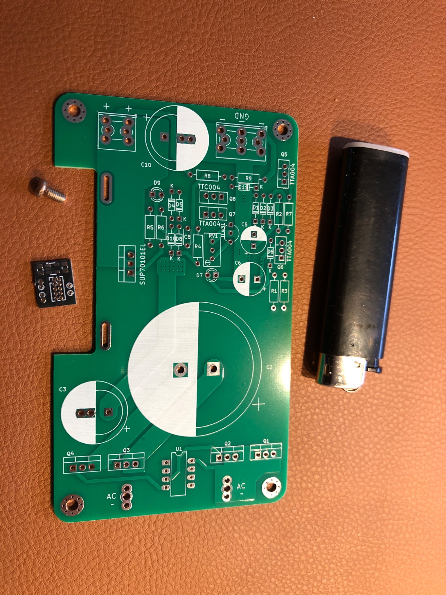

R25 board El Cheapo version. Indeed a large board but not too large 🙂 Normal copper, tin/lead finish. More than enough for the average sub 50W stereo class D amplifier. Since building costs are much higher than the cost of the device it will be feeding I decided to save a little and skip the (IMHO) silly and expensive clip on heatsink and will mount the MOSFET against the cast aluminium casing. With M3. Old fashioned sturdy, reliable and cheaper.
If someone in F, B, D or NL wants a PCB please send a PM.
Disclaimer: don’t lick or eat this PCB as it is not ROHS.
That way is also recommended if anyone needs to take advantage of very high current capability.
This time I haven’t included a build guide, but R21 build guide has such MOSFET mounting option pictured.
