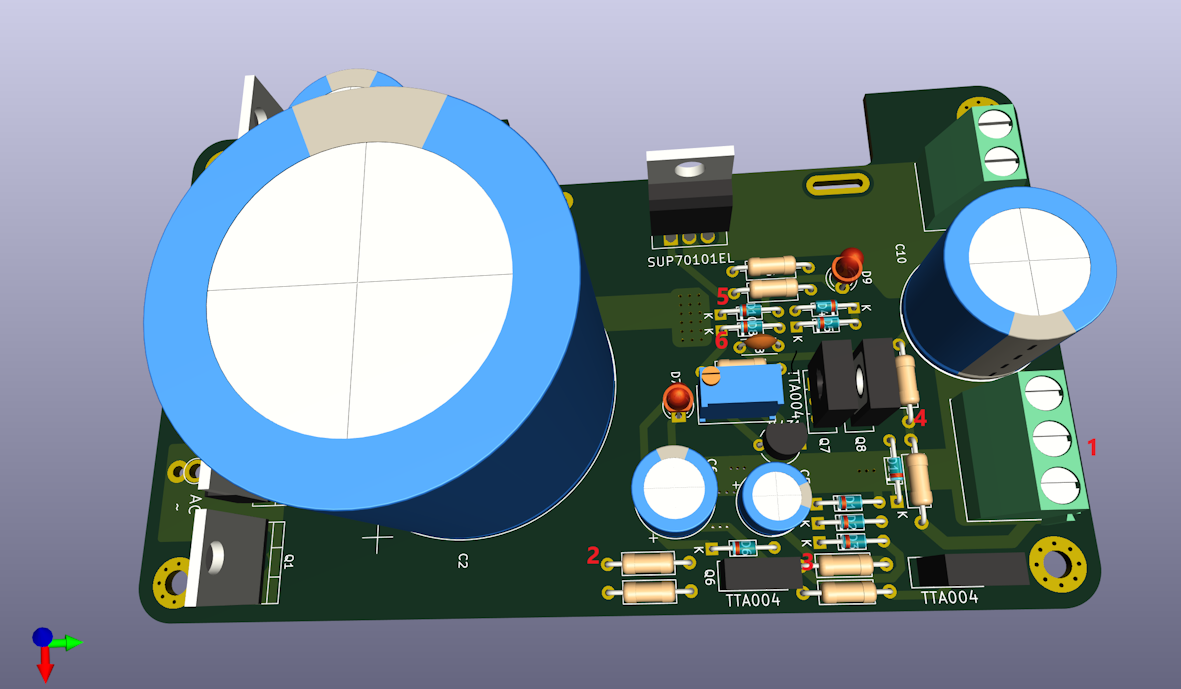

With supply powered off, measure resistance between pins 2 & 3 of SUP70101. If there is a short circuit, replace MOSFET.
If MOSFET id OK, on powered supply, but with amplifier disconnected, measure voltages between the following points, as marked on the picture.
1-2, 1-3, 1-4, 1-5, 1-6. Add voltages at input (+pin of C2 to ground), and voltage at supply output.
EDIT: as you intended, after checking MOSFET, check soldering on opamp.
Must have been the opamp - all is well now. I had never soldered in an SMD opamp - must have got lucky with the first. I will be be more certain of the next two before applying power.

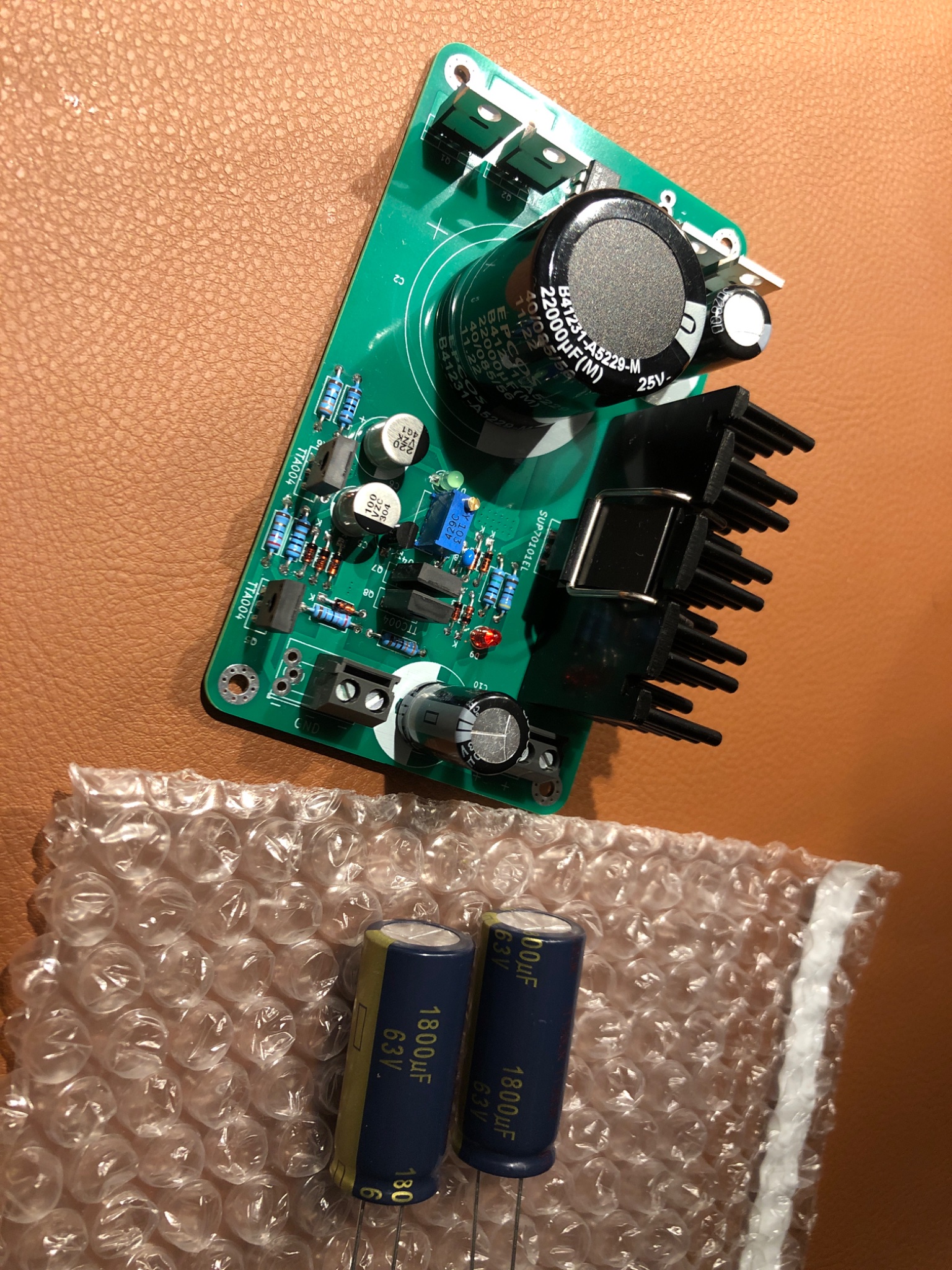

Please guess what I forgot to delete from the last shopping list update:
Heatsink😂
Lookin good JP.
Solid impressions Rick, looking forward to building mine. The Yellow van is delivering my JLCPCB order today😉.
Lookin good JP.
Thanks. Also the extra capacitors. It is not bright to name shopping list updates with just a incremental number when updating/adding items.

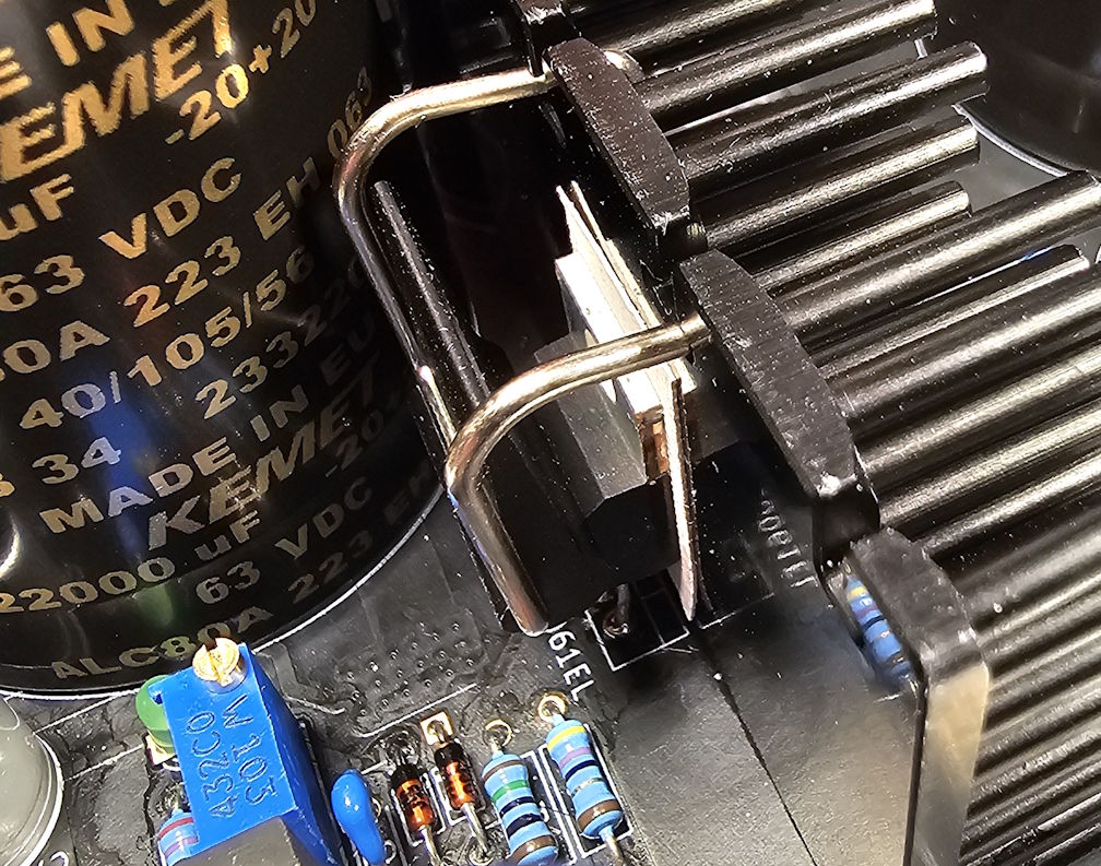

I think problem is that you didn't apply clip as is meant. MOSFET seems very low positioned at your board.The aluminium clip damages the TO220 tab
Yeah like usual short connection and TO220 till the point where the pins get wider and can not go deeper. Also the force against the MOSFET body felt wrong and the MOSFET changed position because of the clip both in unsoldered state and when trying to mount the set before soldering.
I will order a new MOSFET.
