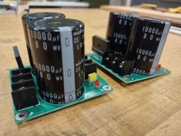

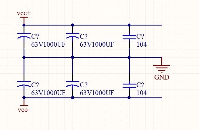

If you can. I suggest paralleling some capacitors between the power supply + -.
Because the switching power supply output will have some PWM signals. The frequency is about 100kHz.
These PWM signals may cause the amplifier output transistor to heat seriously. Even damaged.

I was thinking of using a pair of capacitor boards (please see photo). Do I need to add bypass caps to manage the PWM signals? If so, what is a good value?
Thank you for providing these wonderful amp boards and all of your help. - ziffel

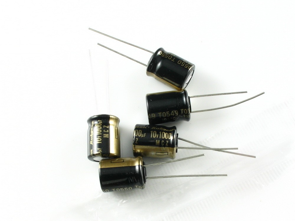

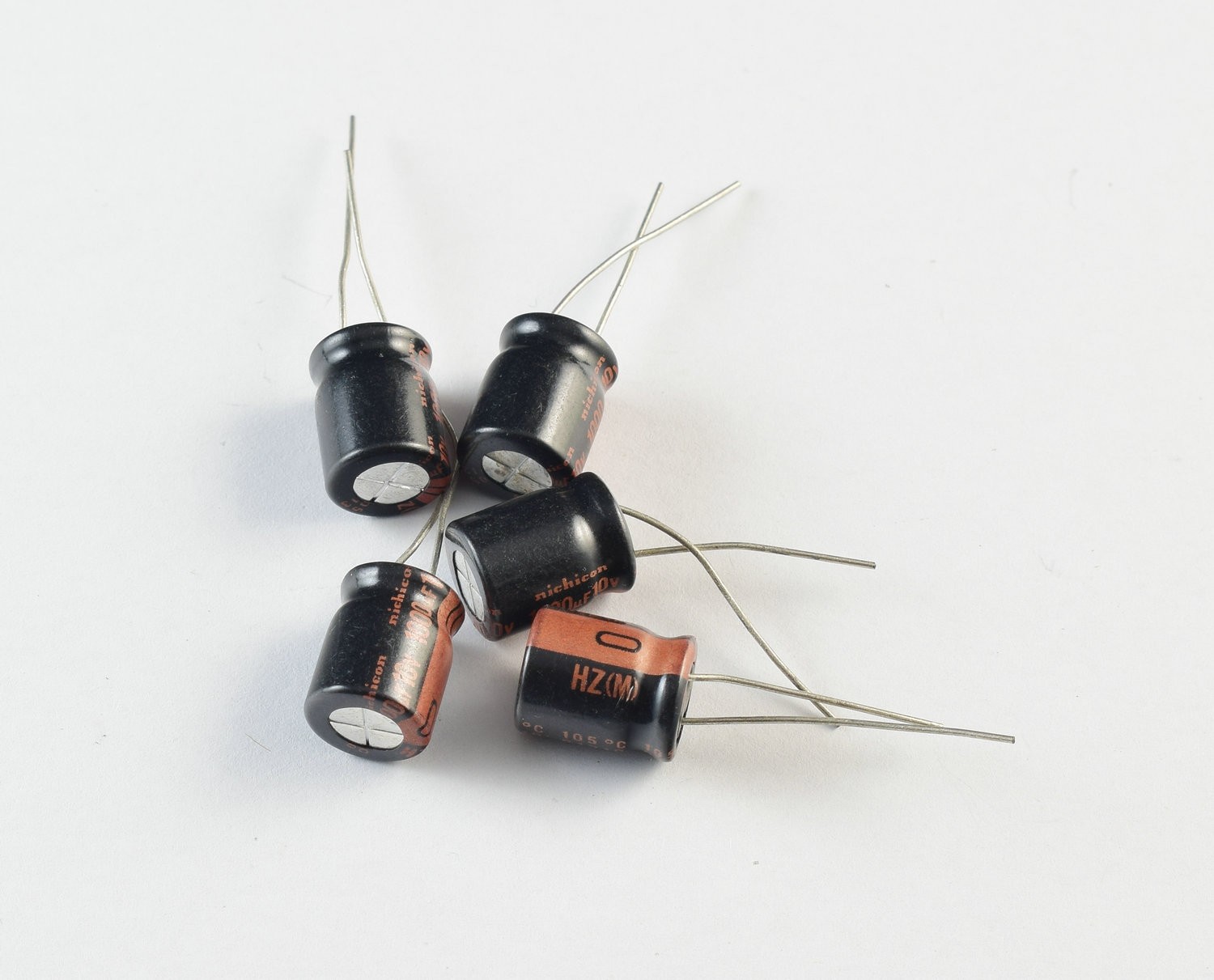

L20se has only one capacitor on the signal. 10V1000UF
It basically uses the world's best Rubycon MCZ capacitor.
Or Nichicon Hz, HN capacitor. They are basically the best capacitors in the world. There's nothing better.
