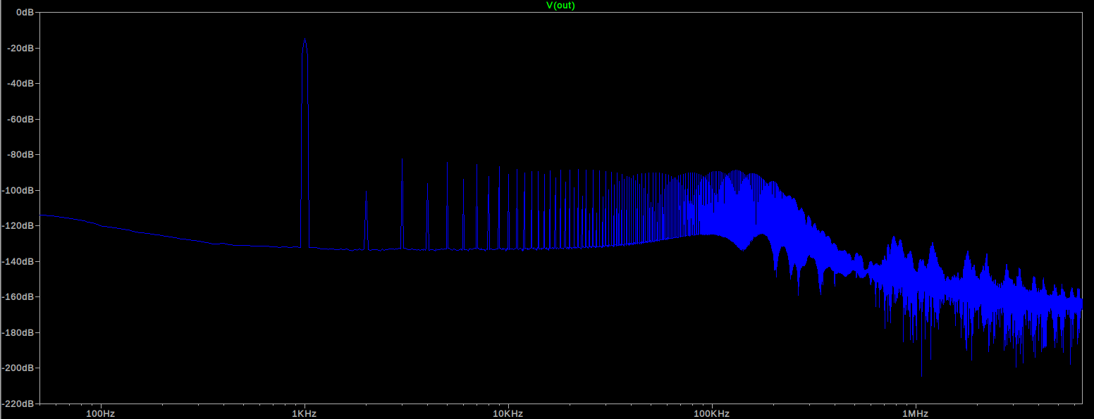

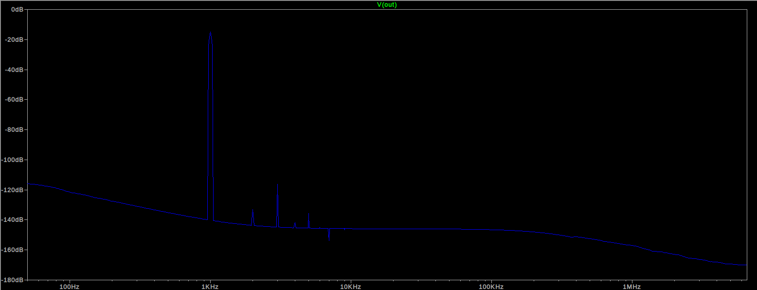

I've finally been able to simulate the schematic. I couldn't find any problems with oscillations, but the bias definitely needs some attention. It needs about 15mv per output resistor. Otherwise distortion and noise is significantly higher. Then again, i haven't tested this in practice yet.
