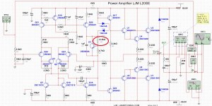

Power Amplifier LJM L20SE

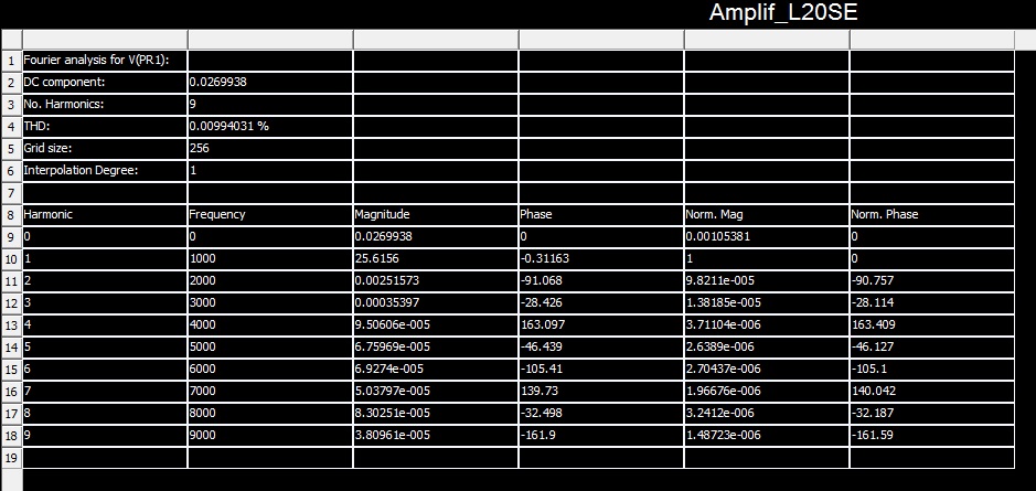

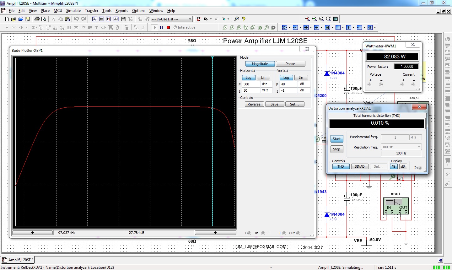

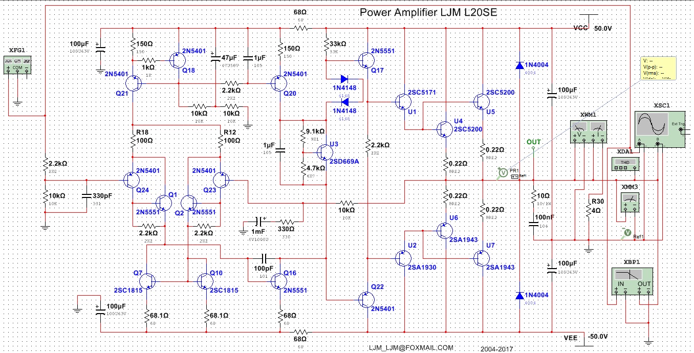

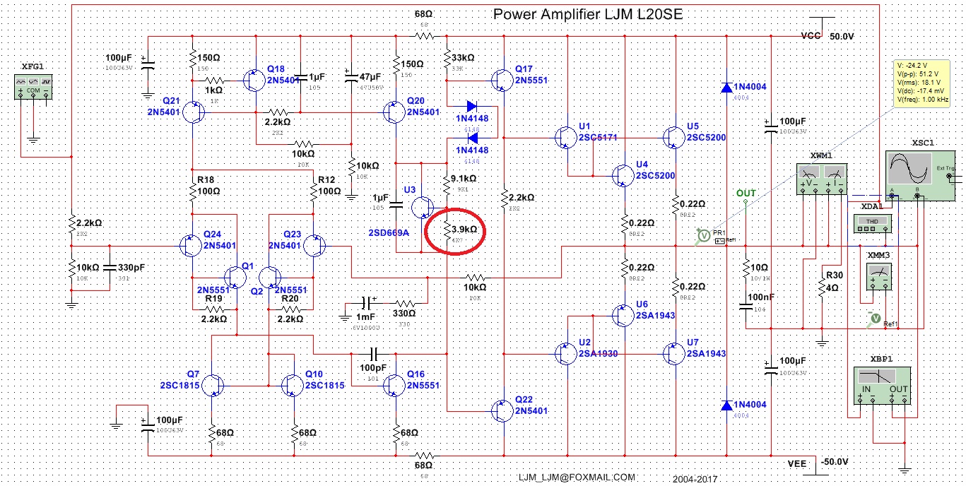

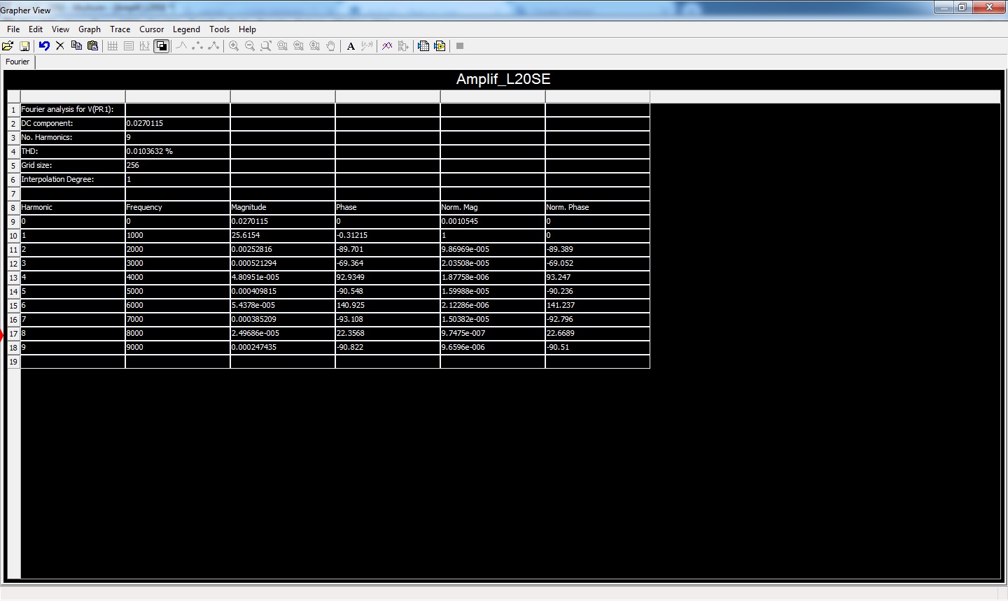

First modification - Setting BIAS
Circuit, response and fourier curve.
Resistance switch from 4.7k to 3.9k
Bending on the response curve. Attenuated peaks at the higher frequencies and amplified range of high frequencies at the amplification. It allows greater amount of harmonics.

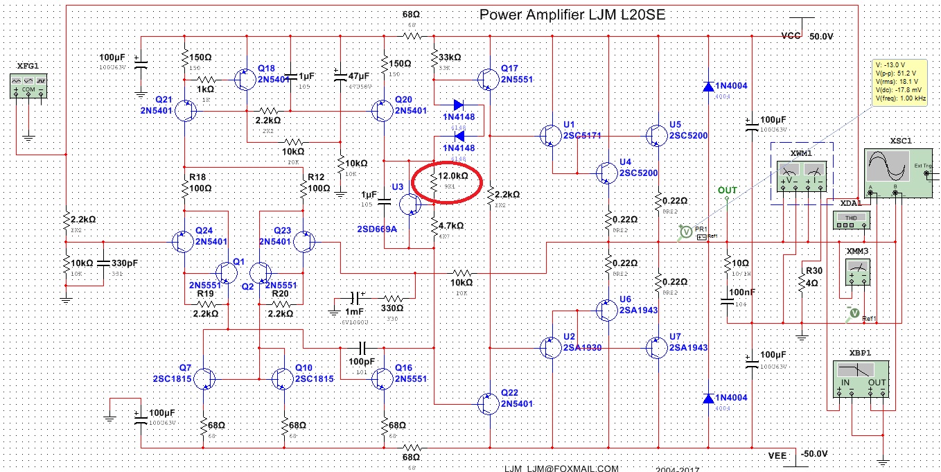

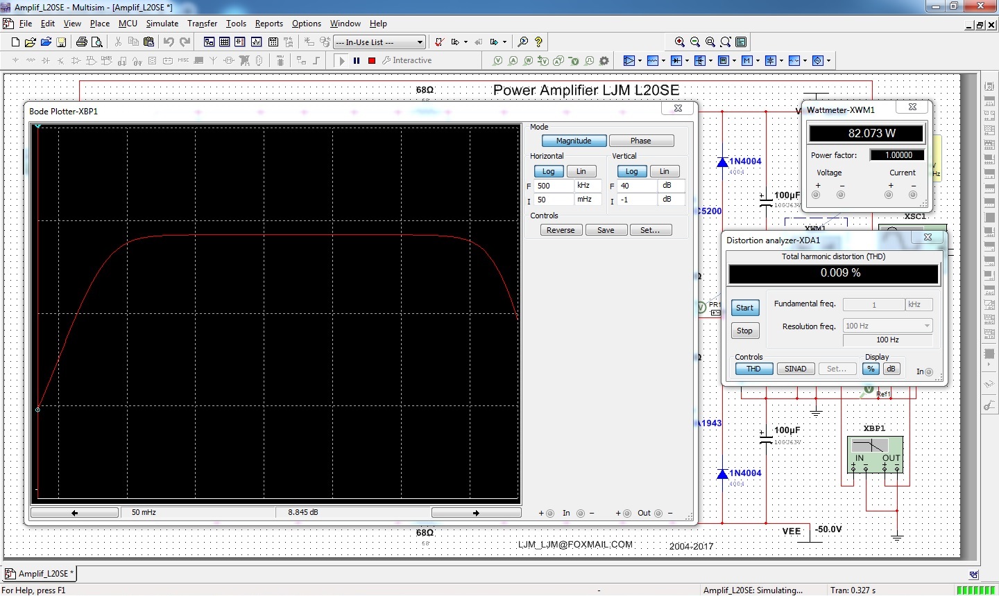

or...
Resistance switch from 9.1k to 12.0k - THD 0.009
ATTENTION! These last two changes did not really work out. caused overload and burnout of the fuse.

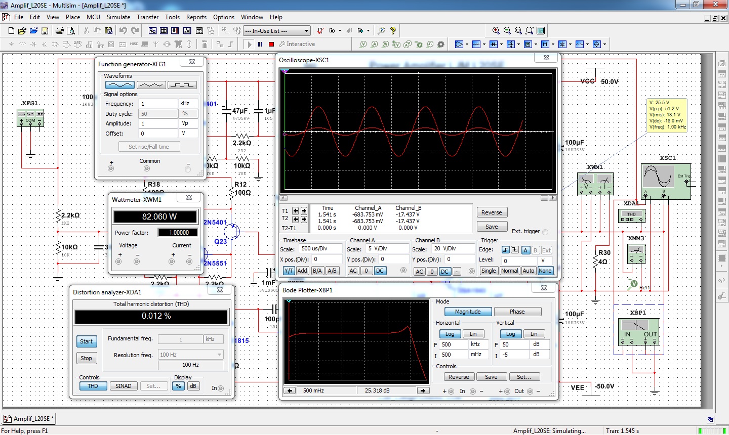

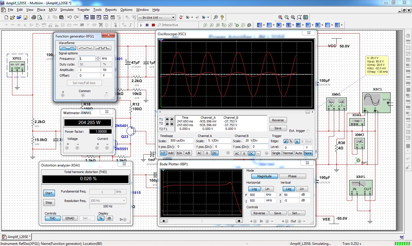

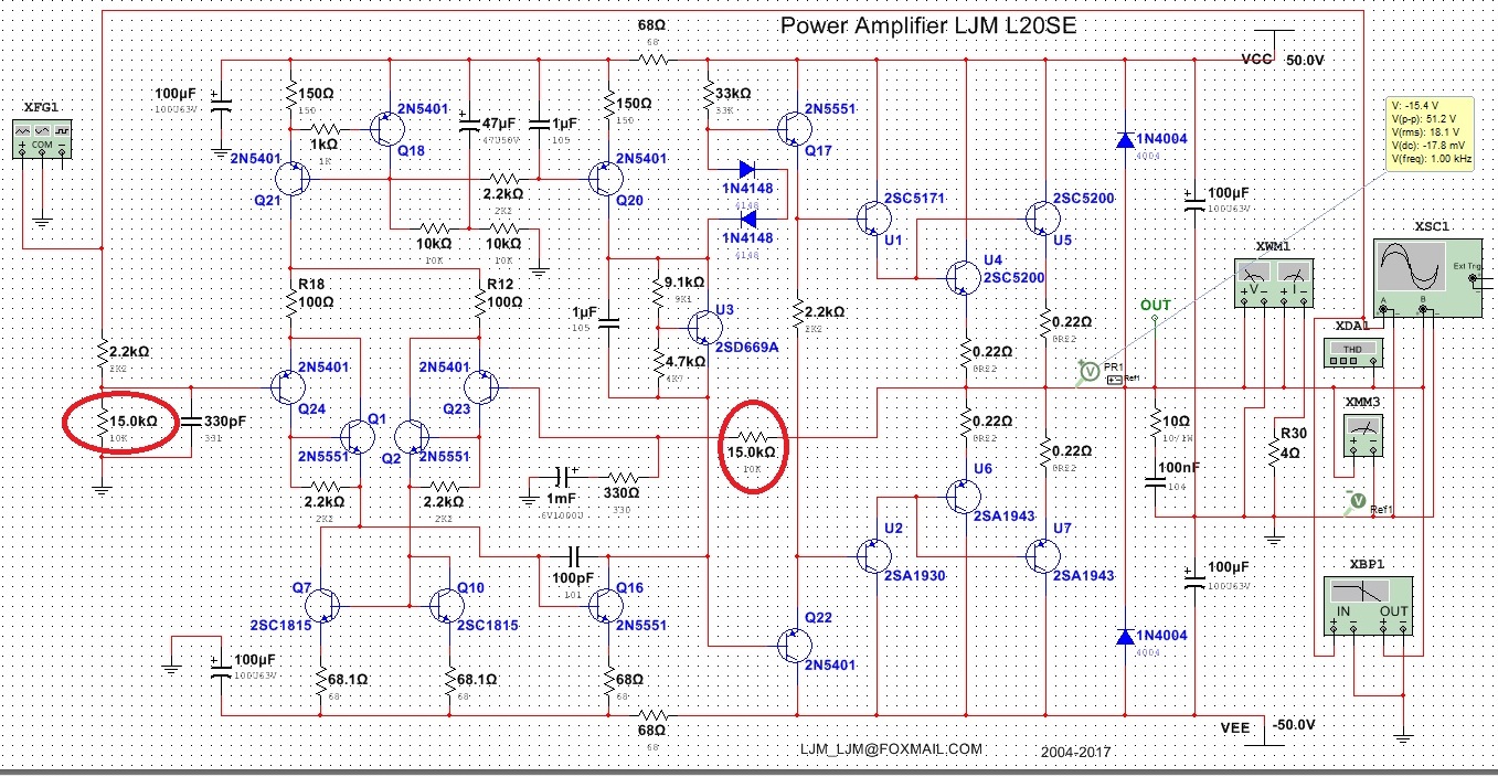

Second change - Change in gain and output power
Signal source: 1khz 1v sinusoidal
Source of +50 0 -50v DC
Changed differential input gain resistors - 10k to 15k.
Power Consumption - 2.05A to 3.24A
Output power - 82W to 204w
THD - 0.012% to 0.026%
Per channel

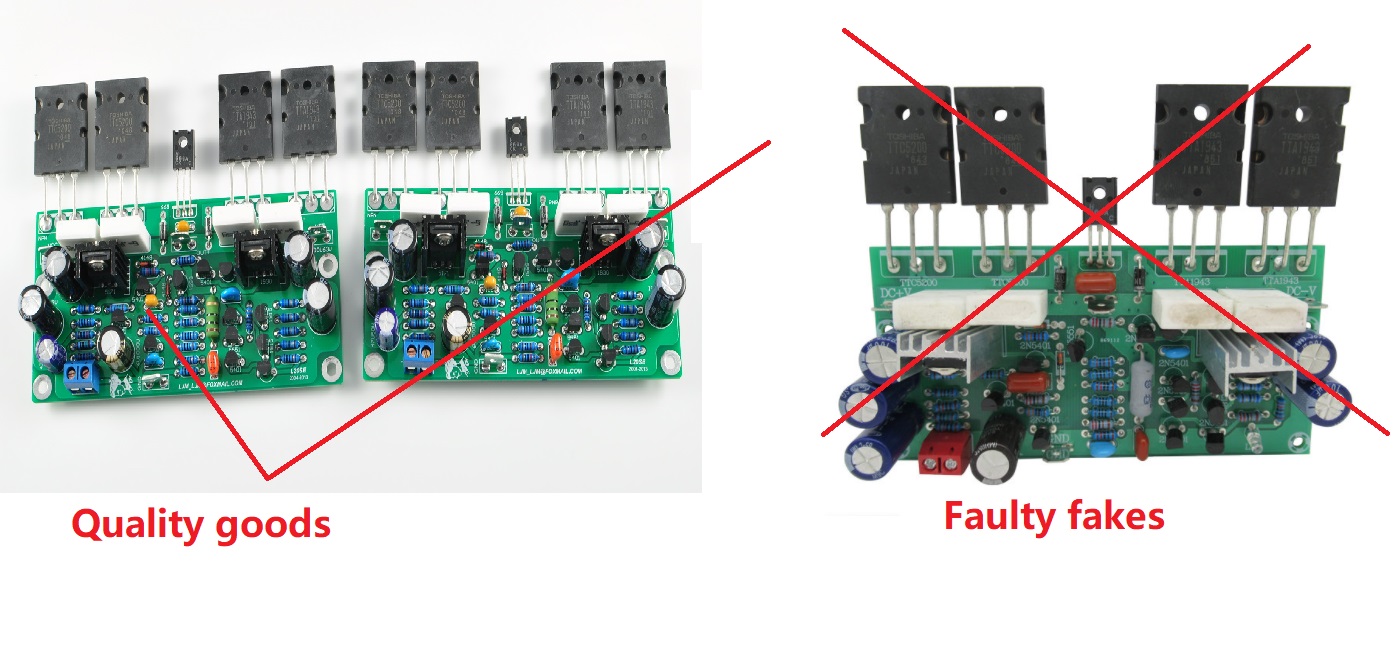

Hello Eliseu! Can i use a voltage supply of + - 54V? do i have to change any resistor?
where i can find the best kit available to buy? Thank you very much

Este kit eu comprei no Aliexpress. Não é o melhor nem o pior. Vai depender do que você procura. Mais potência, maior qualidade, menos distorção...
This kit I bought on Aliexpress. It is not the best nor the worst. It will depend on what you are looking for. More power, higher quality, less distortion ...

I have the same experience as Eliseu, change of bias from 15mA/transistor to a higher value (I have tried 200mA) causes instability, with a voltage of +/-40V.
I therefore do not recommend changing the 9,1k and 4,7k resistors.
The bias of 15mA is really low, I have another amplifier kit from this chinese designer, a NAP250 mod, and it seem to be stable with a nice bias of 500mA/transistor. I will post a review when I have finished testing it.

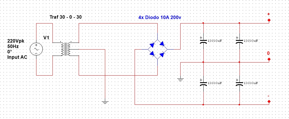

- In its original design, the L20SE is a good amplifier for home use. 80W RMS at 4 ohms (this is the actual power of it) and 0.011% THD (Input pattern with a 1 Khz sine wave and 1 VAC). High-fidelity amplifiers have THD less than 0.5%.
- I'm using two LJM L20SE boards doing minor modifications and testing as I show here.
- This design supports +/- 15 to +/- 65 VDC. +/- 40 VDC is recommended. Using +/- 60 VDC causes a bit more source noise, riple (AC frequency of 50 or 60 Hz) and does not increase power. What really matters is the transformer current, 8 A per channel at least (well defined bass).
- 1x Toroidal transformer +/- 28-32 VAC, 16-20 A. 4x Diodes 10 A, 200 V minimum. 4X Electrolytic capacitor 10,000 uF, 50V minimum. 8x Capacitor polyester or ceramic 100 nF, 100v minimum (optional). 2x artezanal confection filter (optional).
I think this, and the previous post about the smoked resistor indicates oscillation problems with the amp. If increasing the Iq makes it oscillate, I suspect that it could oscillate when driving a load too, when current increases.
You could try to feed it for example 20kHz square wave, vary the amplitude, and load resistor, and see what the flanks look like on a scope. The LP capacitor on the input should be disconnected for this, and best to disconnect the zobel on the output too.
If it's very prone to oscillate, feeding a sine wave, and watching the output on a scope could reveal a 'thick' or 'blurred' line on the peaks of the sine wave where current is higher. Transistor temperatures can also influence this, so it should be tested cold and 'hot'.
