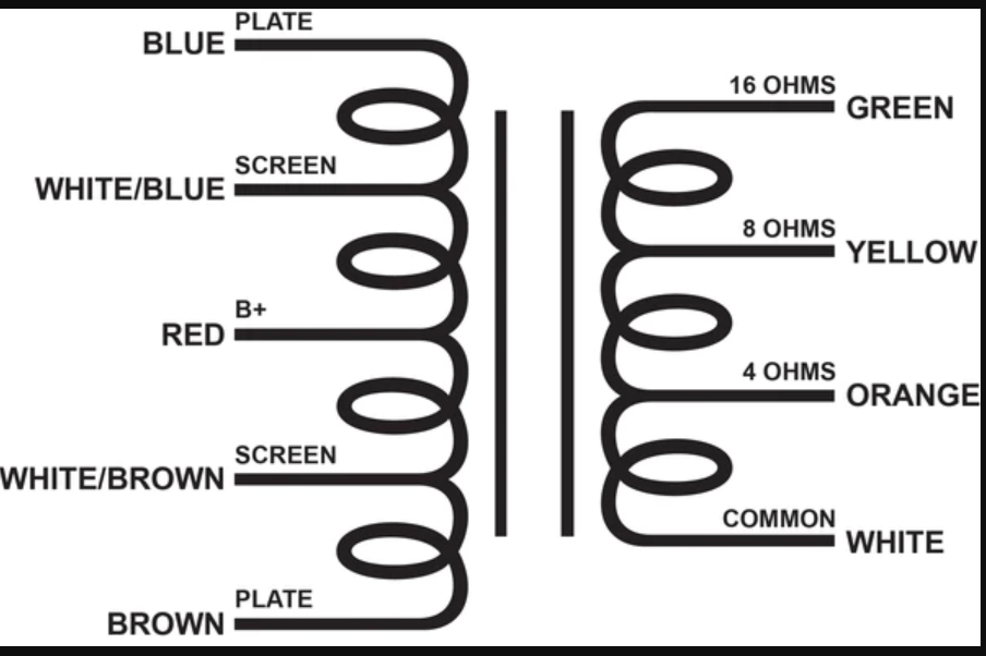

I am using a different PT and OT than what Pete originally perscirped. Bigger PT and OTs for more power.
I am using 1R cathode resistors rather than the 10R Pete used. As such his 400mV cathode voltage should be 40mV in my build.
My B+ is 450V DC fully loaded with all tubes in. Heaters read a nice 6.3V AC.
I use the bias trim pots and set -35V on the 6JN6s grid stoppers.
When I go to read the voltage across the 1R 6JN6 cathode resistors I am reading ~0.8V on all tubes.
Not sure what I am doing wrong? 🤔

So turns out the wonky bias readings were due to my DMM ground being connected directly to chassis ground rather than audio ground on the PCB. Those little diodes and their Vf threw things off.
But now the biasing of the 6JN6 is giving me troubles. The trim pot jumps from 30mV to 60mV, I can't get it to settle in the 35-55mV range where I want the bias to be (aiming for 40mV).

A snappy jump in bias current can be caused by several things. A wonky pot is one, but a sharp jump from 15 mA to 50 mA can be oscillation. If you have the GNFB connected, disconnect it, at least until you get things working. A scope can see oscillation if you have one, but I often used a portable AM radio tuned to a weak station sitting near the board. If the radio goes bonkers when you turn the bias pot, you have oscillation. If moving your hands around near the tubes and transformer wires (be careful not to touch anything conductive) causes a change in current, you have oscillation. Try rerouting the transformer wires if oscillation is suspected.

If the OPT is wired out of phase it is possible for GNFB to be GPFB, IE positive feedback cresting an oscillator. When bringing up a new amp I always minimize the possibilitise for error and feedback of any kind is a possible error source. With this board I fired it up as built without GNFB and it worked. I built three boards total. The first one was built as close to Petes plans as I could with the parts that I had on hand. I used it as my test mule and general science lab for over 3 years (post #138 in 2009 to post #1431 in 2014). It and one of the other two were packed in a box when I moved out of Florida in 2014. They have not seen power since then. Whenever I tried something new I first brought it up without GNFB, then tried it. The board as designed is marginal on gain at power levels in the 50+ WPC range. GNFB reduces the gain further. Using a 6GU5 for the driver tube buys some more gain. Pete switched to the 6GU5 in his 50 Watt mono block version.

Ok I will try keeping the GNFB connected on the PCB but while flipping the leads of the right side OT, hopefully it is just GPFB that needs to turn to GNFB by flipping of the OT primaries.
It would be weird though that the right side OT is backwards no?
Both OTs are the same, have the same wire colour coding and correspond to the wire colours marked on the PCB.
Ok it was GPFB that was causing the ossicllation/bias soaring issues on the right channel!
I moved the NFB wire coming off the PCB from the red output binding post to the black output binding post and all was good on the right channel. I will get to further burn in and testing later but at least now the bias is stable and not flying off in to thermal run down. 😀

The amp is up and running, found I had GPFB on both channels. So for now I just removed the feedback and I am running the amp with no feedback until I have time to swap the OT primary leads.

You can just swap the secondary leads on the OPTs if you want.

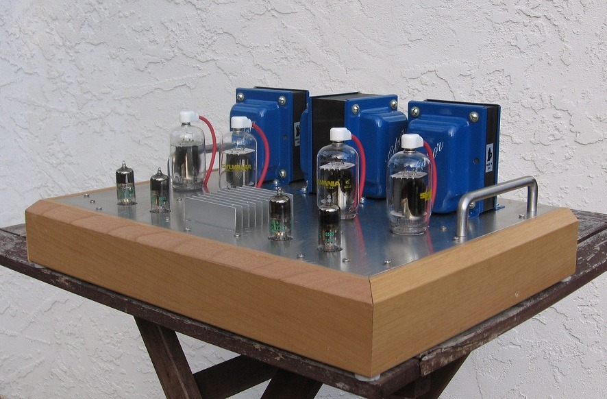

Here's a pic of my old amp. Heat sink is ~2.5" wide, 2.75" deep, and ~ 1" tall . It came from an old dead Sansui receiver. It bolts directly to the transistors, not the top plate.
