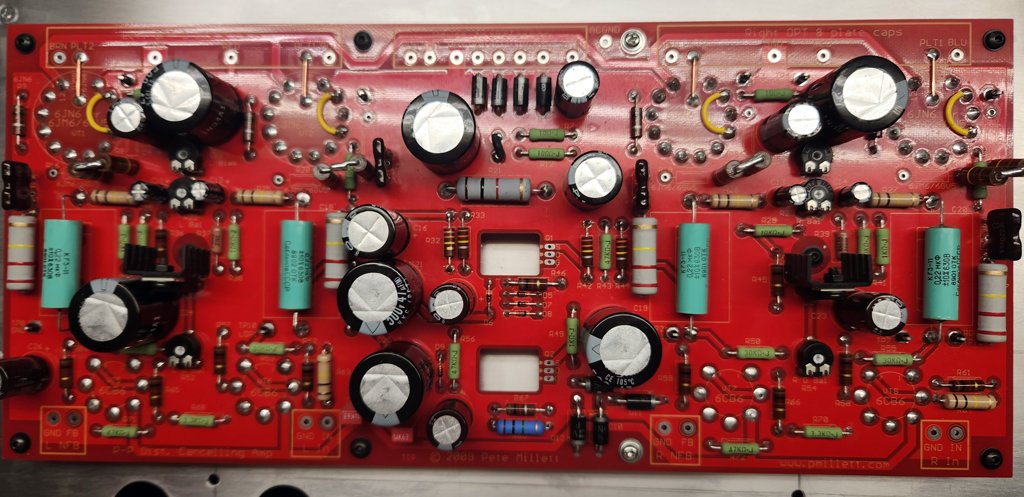

Hopefully one day I can pay back 10-fold for my questions and need for hand holding. I populated the Red Board and think I got the changes made that were recommended. When I ordered the parts I didn't quite know what route I was going to take.. increasing power to the board or with the 'boost method' so I went with upgrading the capacitors. Reading through this thread a few times it really dawned on me that this is old history already.
C2, 3, 6, 21, 24, 25, 27 increased to 47uf 500v
C4, 5, 22, 23, 26, 30 increased to 10uf 500v
D1, 2, 3, 4 increased to 3A 1000v
R8, 9, 10, 11 changed to 500 ohm (had to put 2x 250 ohm 1w in series)
Mod was done according to image at post 346 to run 6HJ5 tubes
Additional Jumper added to 12 pin sockets between pin 2 & 4 to accommodate 6HD5 tubes according to a certain super smart 'axe' wielding blond guy in post 1869
R29, 30, 31, 47 changed to 220k 5 watt
Reduced R21 to 1k 5 watt
I haven't done anything with the 820pf caps yet and the FETs are waiting until the heatsink arrives so I can twist my addled aging brain a bit more 🙂

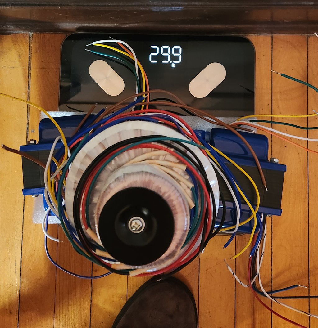

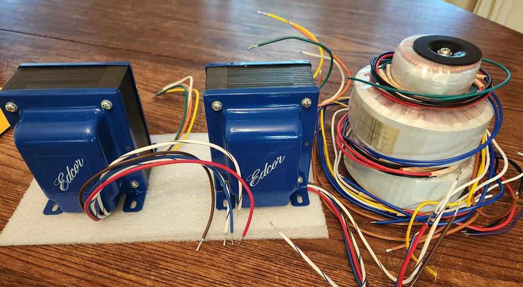

The transformers have finally arrived! Man, folks were not exaggerating the weight of this thing as a 100 watt per channel amp!

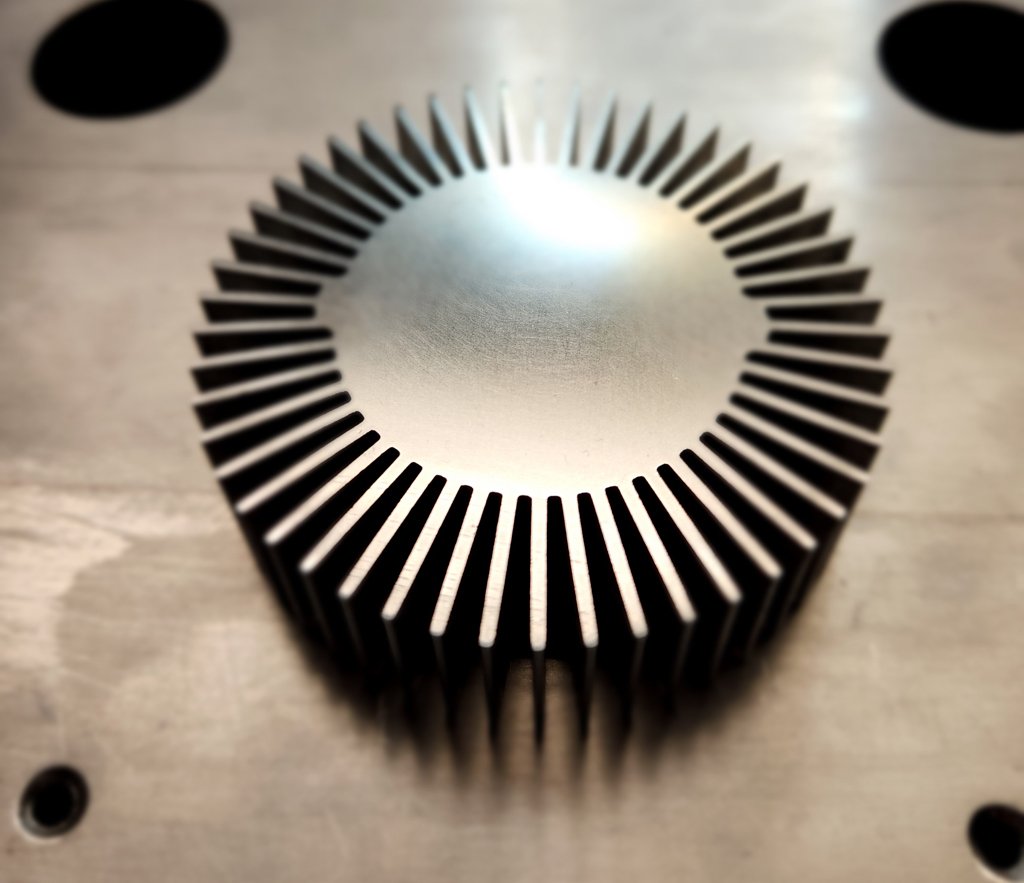

I stole the round heatsink idea from many of you here. Tubes are all here 🙂 . Now I'm waiting on another chassis. I'll keep the original for a stock build or just slightly larger but I don't think it would support all the weight very well. I think I might have bitten off a bit more than I can chew here. I decided to go with the build that Scott17 put together using 2 Antek AS-2T230's, a little 25va 40+40 for bias etc. Scott's not available but I'm hoping I can bug some of you when it comes time to wire this up 🙂

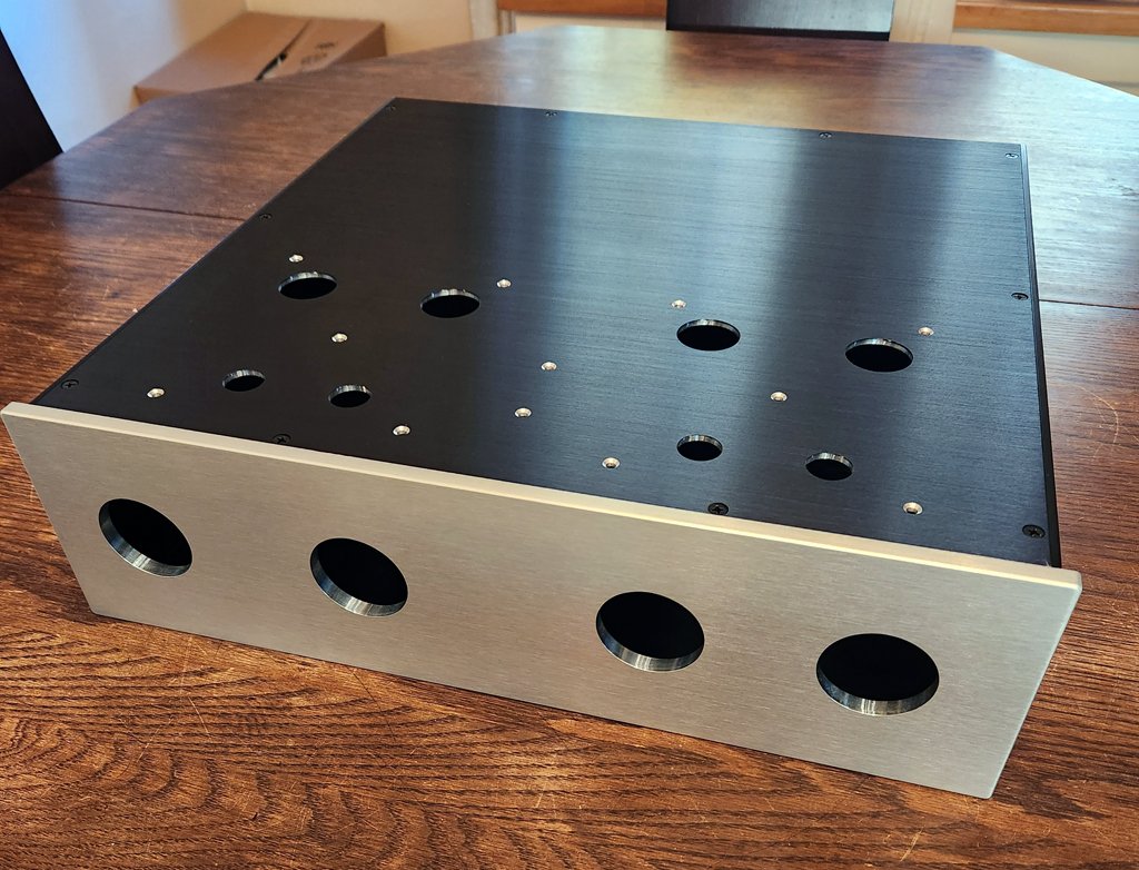

Let the games begin! The new chassis has arrived. Now we are officially over the 40 lb. mark with just chassis and transformers. Definitely in need of handles of some kind. I found a person in the 'Orient' to build the chassis and cnc cut the board and panel meter holes. The front panel is 8mm thick with top and bottom @ 3mm. To me it would have proved very daunting getting those holes made so perfectly. Ordered on the 23 October and arrived about an hour ago. 42cm x 41cm x 12cm (rough external measurements) should leave tons of room for everything. Would it be worthwhile doing a sort of 'inept newbie' build thread? I know I had tons of questions getting just this far with many more guaranteed to come up.
