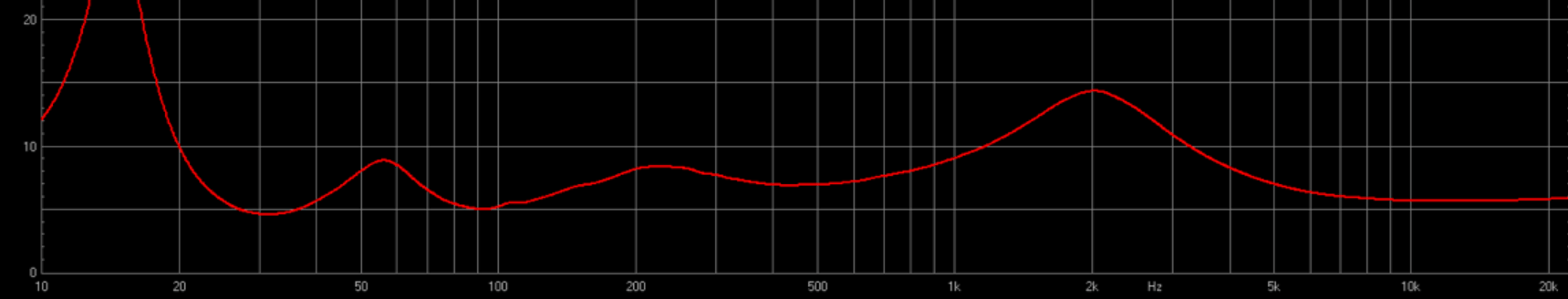

Transformer impedance matching question. I am using the 8K Edcors that Pete called out. Below is my speaker impedance curve. Based on this curve, would anyone recommend a different xformer primary impedence (into 8 ohm)?

1. Welcome to the un-flat impedance versus frequency curve of loudspeakers.
In your case it dips to about 5 Ohms, and peaks at perhaps 30 Ohms or more.
I believe your circuit uses global negative feedback.
Pentodes and Beam Power tubes in their Native Operating Mode: almost always require negative feedback, such as global, Schade, cathode, etc.
Negative feedback helps with the damping factor and ability to deal with varying impedance loads.
Hopefully your global negative feedback is also able to deal with the output transformers gain phase curves, and with the elliptical load of the loudspeaker at many different frequencies.
Stability is the first order of the day.
I do not design global negative feedback into my single ended, push pull, and balanced amplifiers.
But my output tubes are either Triodes, Triode Wired Beam Power tubes, or Triode Wired Pentodes (one amplifier was Beam Power in Ultra Linear).
Most of my 8 Ohm rated loudspeakers have minimum impedance of about 6 Ohms, So I use the 4 Ohm tap to drive the loudspeakers.

The amp won't drive your speakers? What are they?Transformer impedance matching question. I am using the 8K Edcors that Pete called out. Below is my speaker impedance curve. Based on this curve, would anyone recommend a different xformer primary impedence (into 8 ohm)?
jeff
1. The amp sounds fine, actually its the best sounding amp I have right now. It sound glorious and handily beats my Music Reference RM9 with the same speakers. REW measurement of the frequency response is reasonably flat.
2. I am not using GNB and I want to keep it that way.
3. I have seen worse impedance curves and I think that one is pretty good relatively.
4. @6A3sUMMER I have since matched my driver pentodes and output tubes using utracer. I have alot of 6CB6's and 6JN6's. I did not hear much of difference pre and post matching of tubes.
I am just wondering if there is a better nominal value to shoot for.

The amp drives the speakers fine. They are Troel Gravison's 3WC-15. A nice 95db/W loudspeaker I built for my SE807 amp. But it yearned a bit for more than the 6-7W's it gave.The amp won't drive your speakers? What are they?

Change the nominal impedance of the output transformers?
1. Assuming that the primary impedance was correct for the original amplifier design (and that there were no modifications of the amplifier),
Then . . .
If I had an output transformer with a single output tap impedance, and I was going to spend money on another output transformer,
it would either be:
An Output transformer with the same primary impedance, and two output taps, 8 Ohm and 4 Ohm.
OR,
A Monolith Magnetics transformer with the same primary impedance and a 5 Ohm OR a 6 Ohm output tap.
2. If you changed the negative feedback (added, removed, changed the type of negative feedback) . . .
Then the complete modified amplifier circuit needs to be analyzed, before deciding on whether a new primary impedance is a good thing or not.

I've often wondered what the amp would sound like with some real fancy OPT's. I see no reason to change the primary impedance. That's what Pete chose for the operating point of the tubes.
jeff
Scattered throughout this long thread you could find my experiments with this board in configurations from about 30 WPC to over 200 WPC, but the most popular build made 125 WPC. Every version I built worked well without GNFB since there is an internal "Schade" output plate to driver plate feedback setup. The impedance of the OPT can be tweaked to pick a point on the power output vs distortion tradeoff curve. A lower impedance OPT will produce more power and a higher THD from the same tubes up to the power limit of the tubes. I would keep the 6JN6's to less than 50 WPC. I don't remember all the details, but I think 5000 ohms would be as low as I would go with 6JN6's, or any of the 18 watt plate dissipation tubes. 200+ WPC requires BIG output tubes, a 2500 ohm OPT and over 600 volts of plate supply voltage. The 125 WPC builds used 6HJ5's with some board mods, a 3300 ohm OPT, and a second power transformer to put 625 volts on the output tube plates.
If you like the way it sounds, and you have plenty of reserve power for anything you want to play with your speakers, don't mess with it. Lowering the OPT impedance will bring a bit more power but will reduce the damping factor and increase THD. Raising the OPT impedance will cost in power output.
