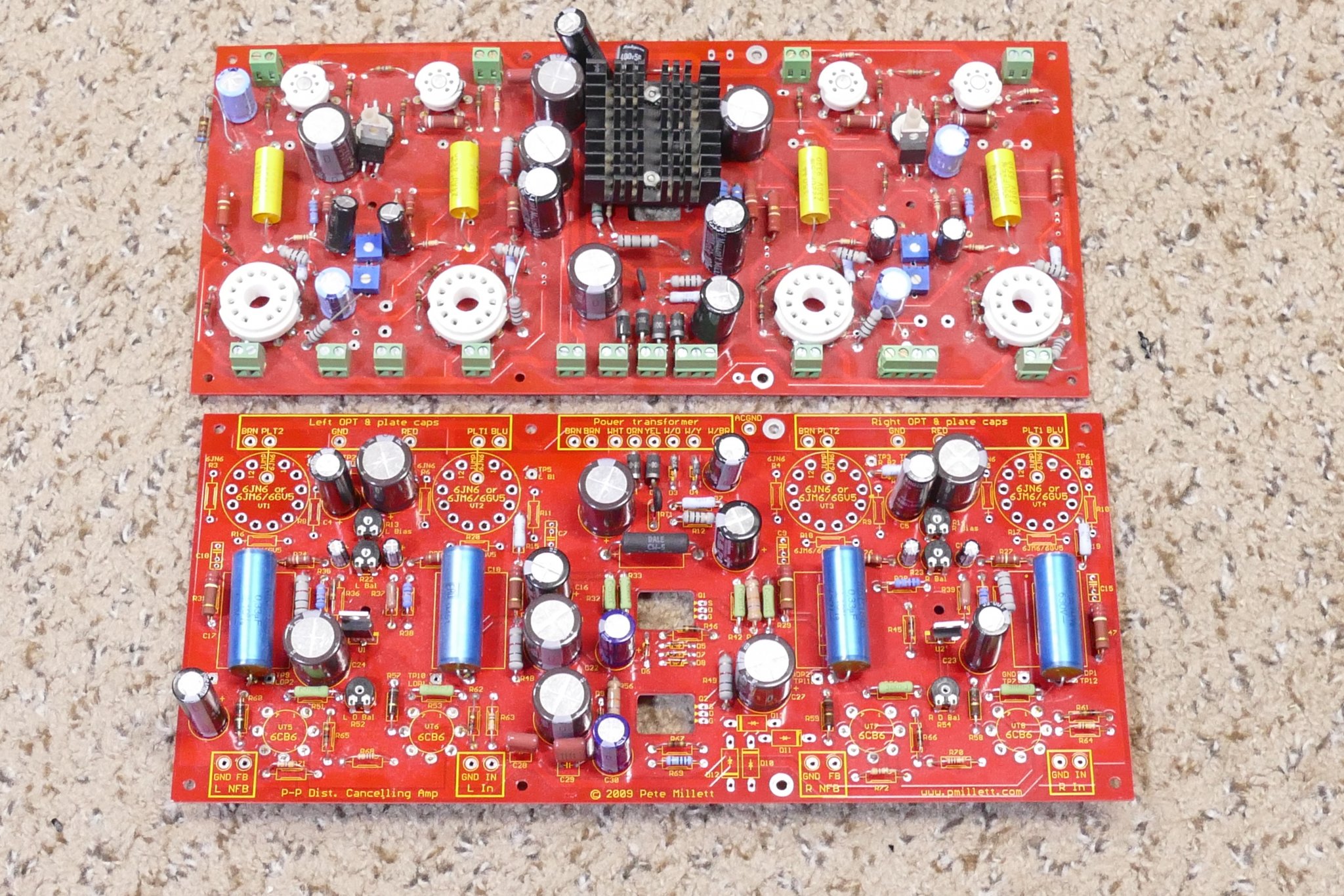

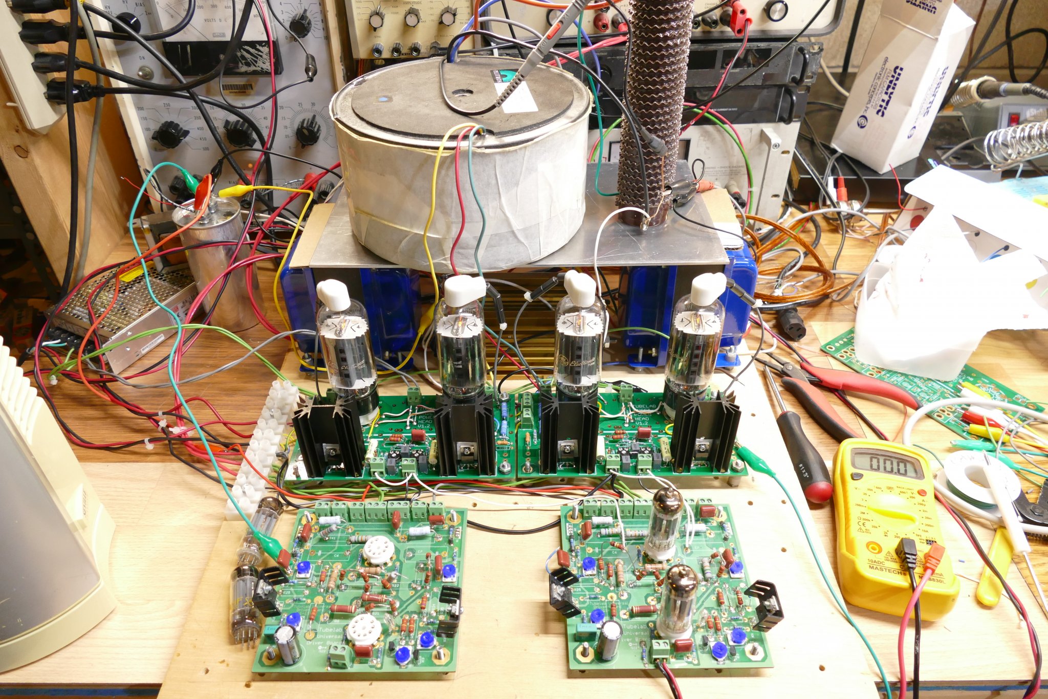

I recently opened a box full of red boards. It wasn't what I was looking for, so I put it back on the shelf. I just went back to find that I still have my original test mule from all those experiments, and another partially populated board that has never seen power. The board with the heat sink in the middle is the test mule. I was also experimenting with Pete's driver boards (also red) and there were some of them in the box, but I know that one fell victim to a power cable that was plugged in backwards making for some crispy and messy parts.
I doubt that I'll ever get back to these since I have found new ways to make big power. Those experiments start at post #445 here:
https://www.diyaudio.com/community/threads/unset-beta-board-build.376124/page-23

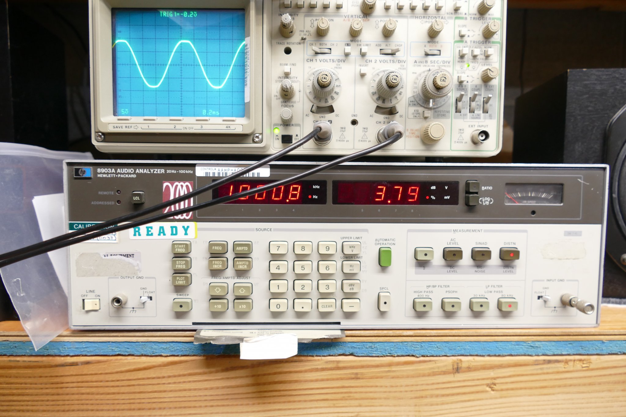

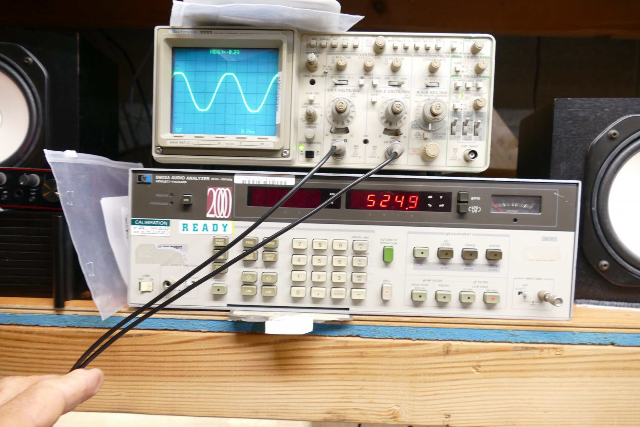

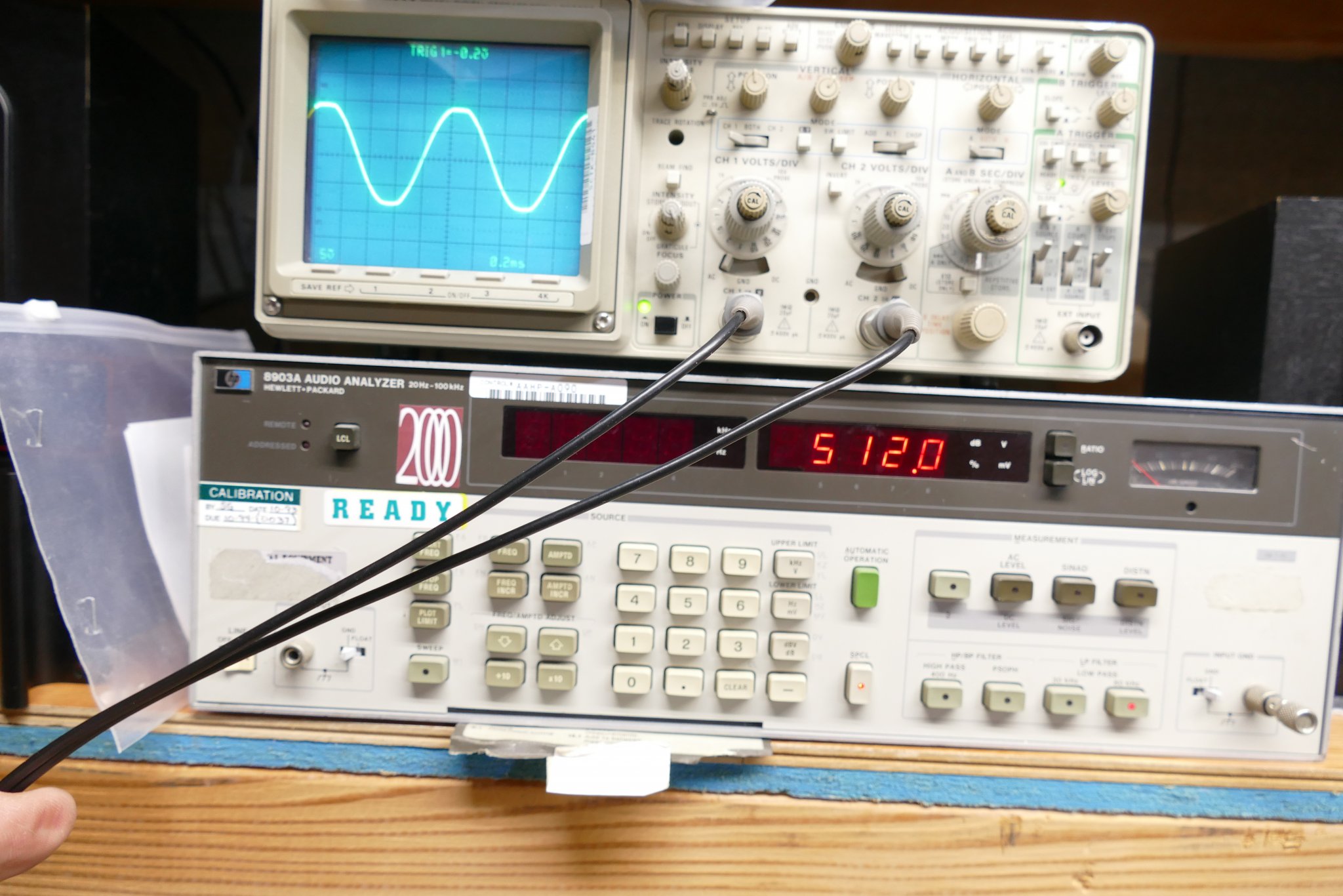

Somewhere back in this long thread there is a big red board 4 X 35LR6 tubes and a reading of over 500 watts on the HP8903A. Here there are three small green boards and 512 watts at 3.79% THD. I saw 525 watts @5% but the 15 amp bench breaker blew before I could get a picture or turn it up further.

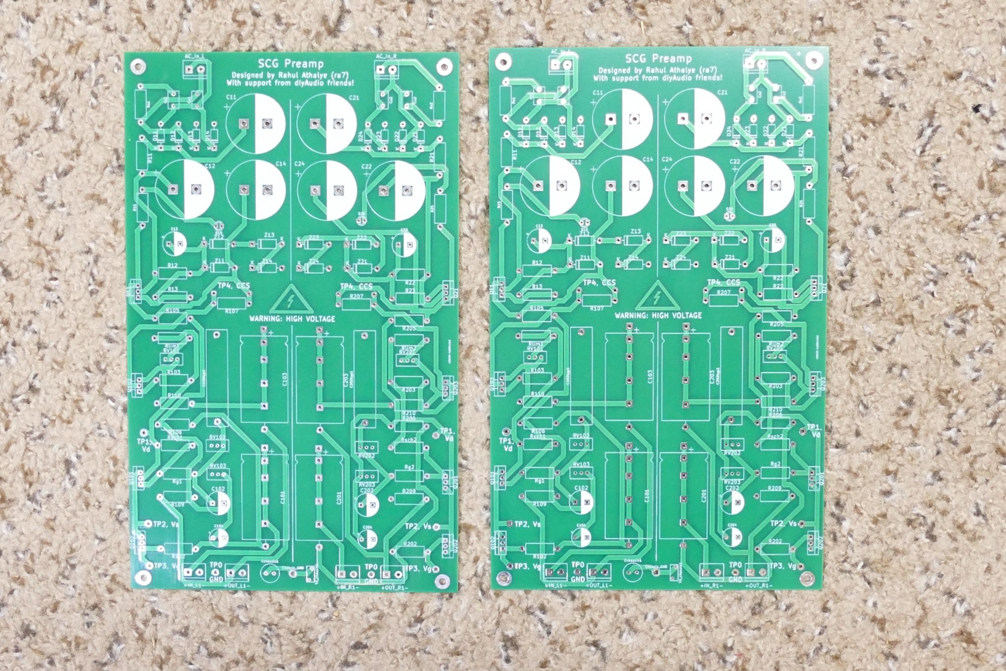

Then there are these two shiny green objects on my bench calling my name. These are solid state amp boards based on the UNSET design. Can we say FETSET? There is a box full of BIG mosfets and J-fets on my bench near those boards, and a pair of 600 ohm SET OPT's from Toroidy. It would be cool to build a tubeless SET that made 30 WPC. I can hear the cries....Why don't you change your name to Transistorlab?
https://www.diyaudio.com/community/threads/schade-common-gate-scg-preamp.380487/

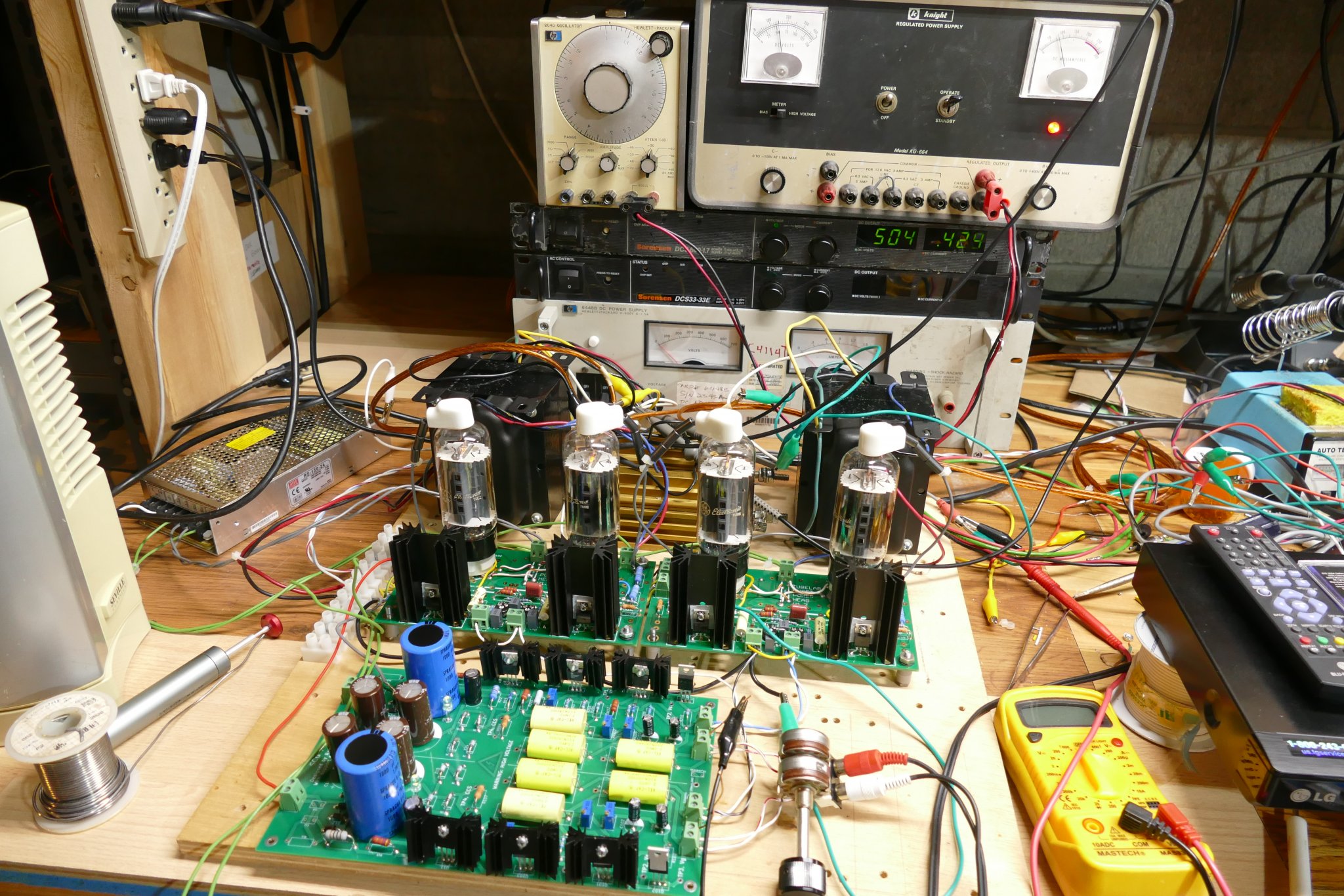

BTW, what kind of Single Ended amp has 12 mosfets, 4 vacuum tubes and makes 30 to 35 WPC with 0.61% THD @ 25 watts?
26HU5's. They are fed by the Meanwell SMPS on the left side of the picture. It's a 24 volt unit turned up to 26 volts. The output stage uses the same UNSET design as the push pull version that made 525 watts in post #1766 here. The driver is the board seen in post # 1768. I am now working on an all solid state output test board. The details of this madness is scattered throughout the SCG thread in the Pass Labs forum, starting with post #761:Neat amp, love the big tubes. 21 volt heaters?
