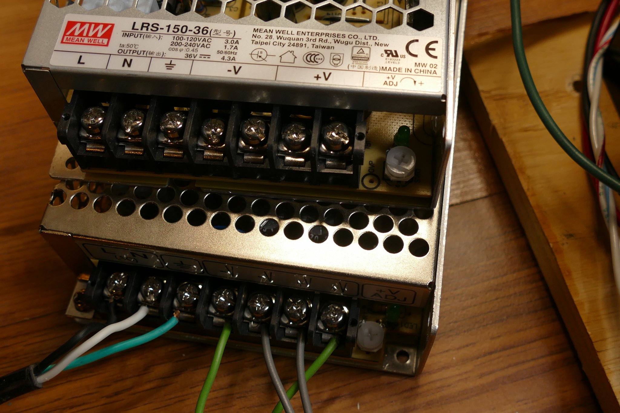

The Meanwell RS series and LRS series have voltage adjustment pots. Some of the cheaper clones do not. The pot is good for about 10% adjustment range, so it is possible that some 24 volt supplies will not go to 26 volts but both of mine do. Both of my 5 volts supplies will not go to 6 volts and neither 12 volt will go 15 volts, but I wouldn't expect them to. I don't think I have ever turned the screw on the 36 volt supply because I use it for 36 volt tubes.
A tube heater will draw as much as 10 X it's rated current at cold start. Some switchers will not start up into this load unless they are rated for considerably more than the tube heaters draw.
I love those things! I used two 5V units to power a 327-A filament (10.5V, 10.7A). I just stacked the outputs and set one to 5.5V. Meanwell made powering that monster oddball filament easy.
The 7.5V units are great for old directly-heated types and 6.3V tubes (but you have to use a dropping resistor for 6.3V types since the supply won't quite adjust down to 6.3V).
I don't bother making filament/heater supplies anymore. I just buy them from Meanwell.

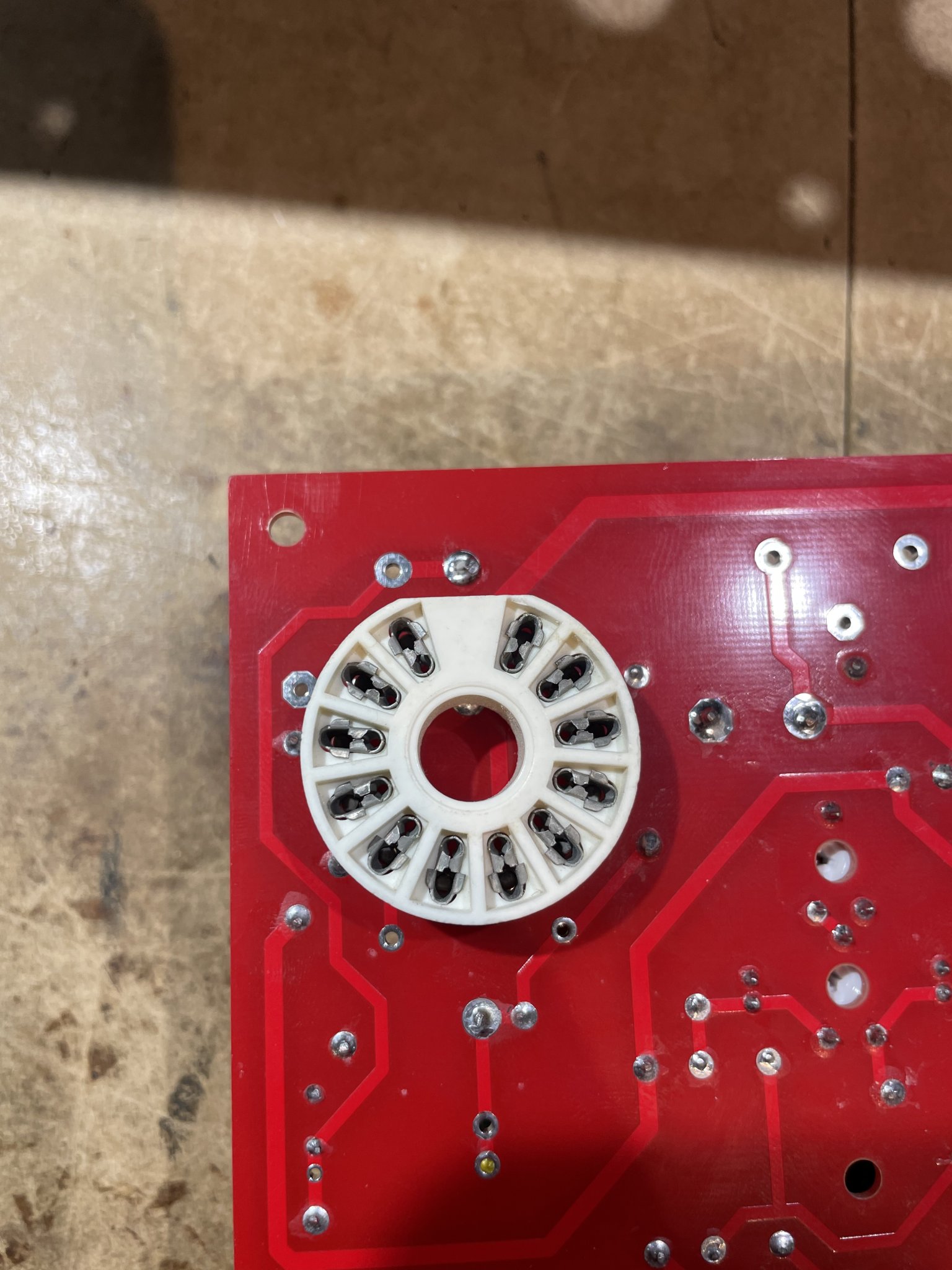

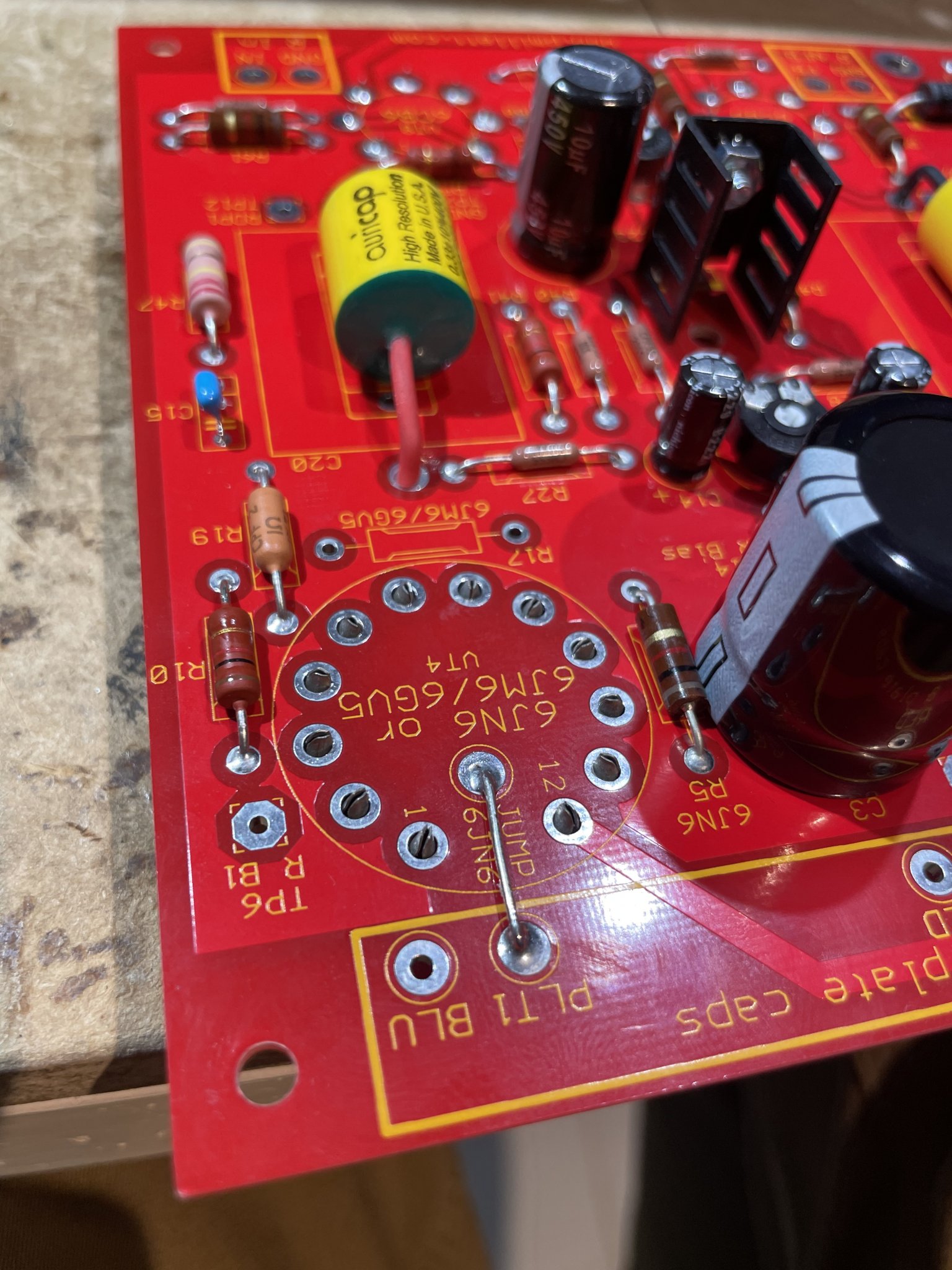

How hard should it be to fit the 12 pin tube sockets in to the PCB?
The pins are very tight in the PCB. I am not sure if I should force the sockets in more so they fit flush (parallel) to the PCB.
As they are fitted now the pins barely poke through the otherwise of the PCB.
