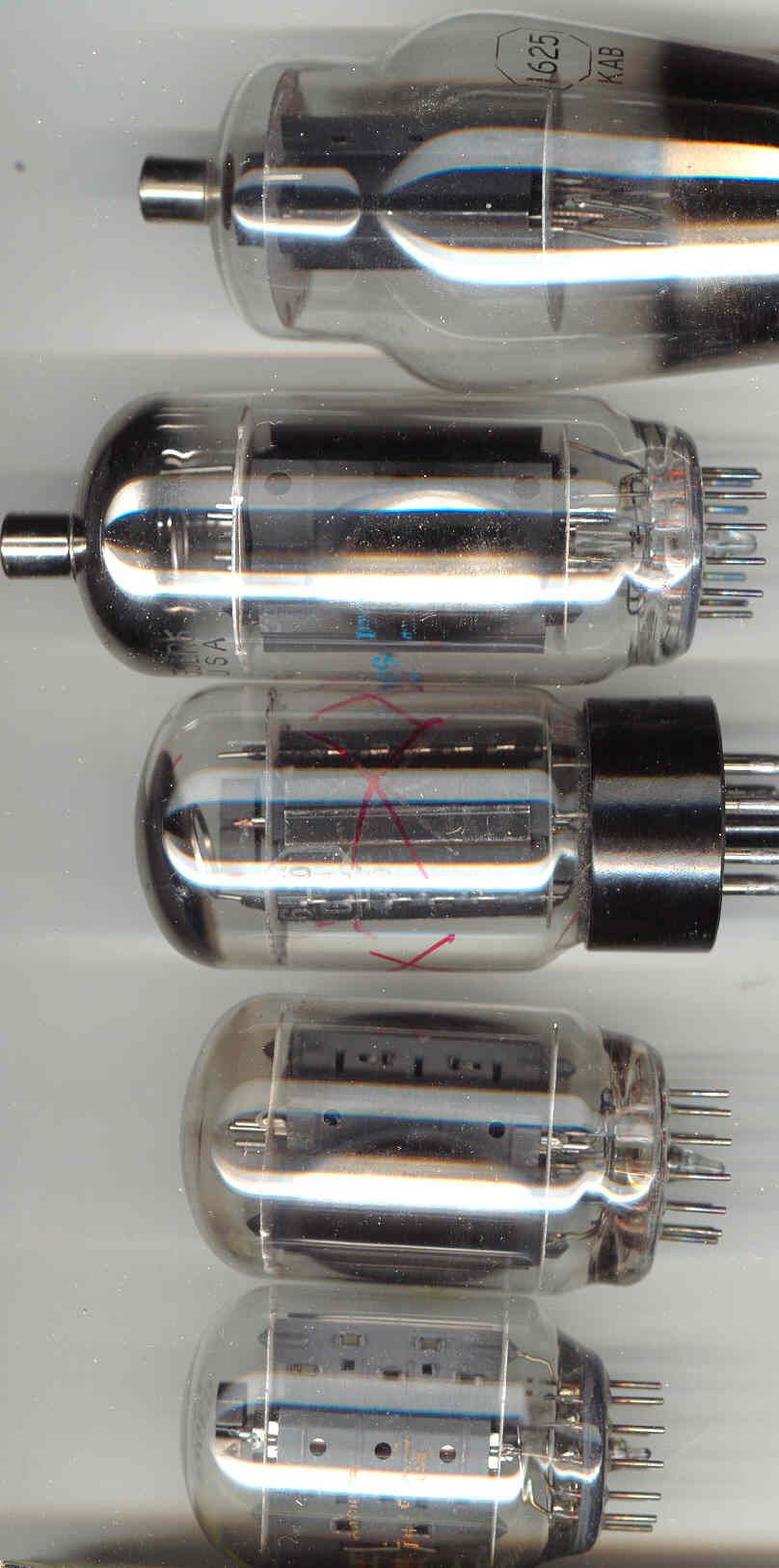

Tube comparison pic:
1625 (807) top
35LR6
6L6GC
21HB5A
6GE5 (6JN6) bottom

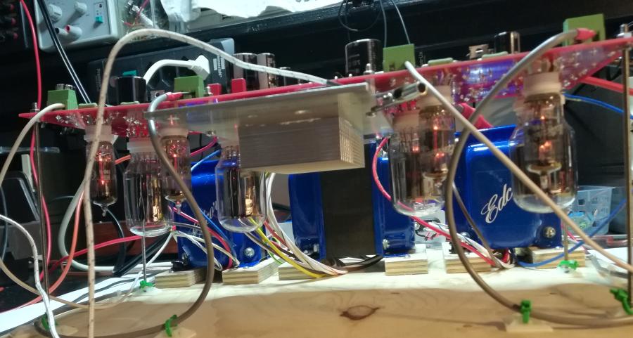

Hi all,
I have built the 1st tube power amp in my young career and I am ready to test it. I hooked all the things to a Variac, digital multimeters, etc, and read the adjustement procedure outlined by Pete.
Inputs are shorted, NFB disconnected, as I'm not sure about the plate polarity being correct, so I want to avoid putting positive feedback in while I power it for the first time.
What I'm not sure about is whether I need to put loads on the output. I have fake HP loads as power resistors in 4, 8, 16 ohms values. My guess is, better test with load but Pete isn't really precise about this. Hints welcome !

Thanks Jazbo8. The amp is going great, now playing music. No trouble to match the biases, loafing along with everything I throw at it, from soft Mark Knopfer till In Flames metal. Impressive sound. Now on to build a case. Pete: respect, that is great work you did !

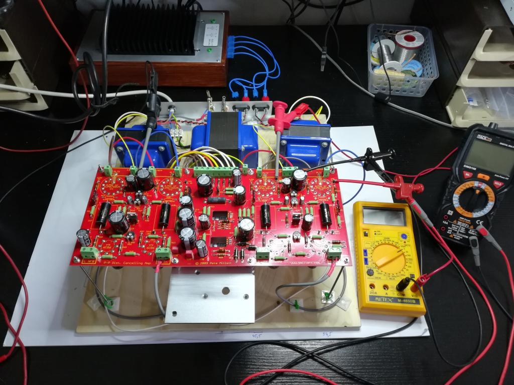

Dear all,
Even if the amp sounds fine, I re-made all measurements, and I think some values are a bit too high. I measured them without input signal.
Can I test Q2 or D9 with a DMM without de-soldering them and without risking to freeze them if not already done ?
- my wall power is 228V AC, 50 Hz
- after RT1 : 396V
- B+ : 390V
- G2 (screen) : 140V
- C- (bias) : -68V
- plates : 384V
- RDP1/2 : 216V
- LDP1/2 : 219V

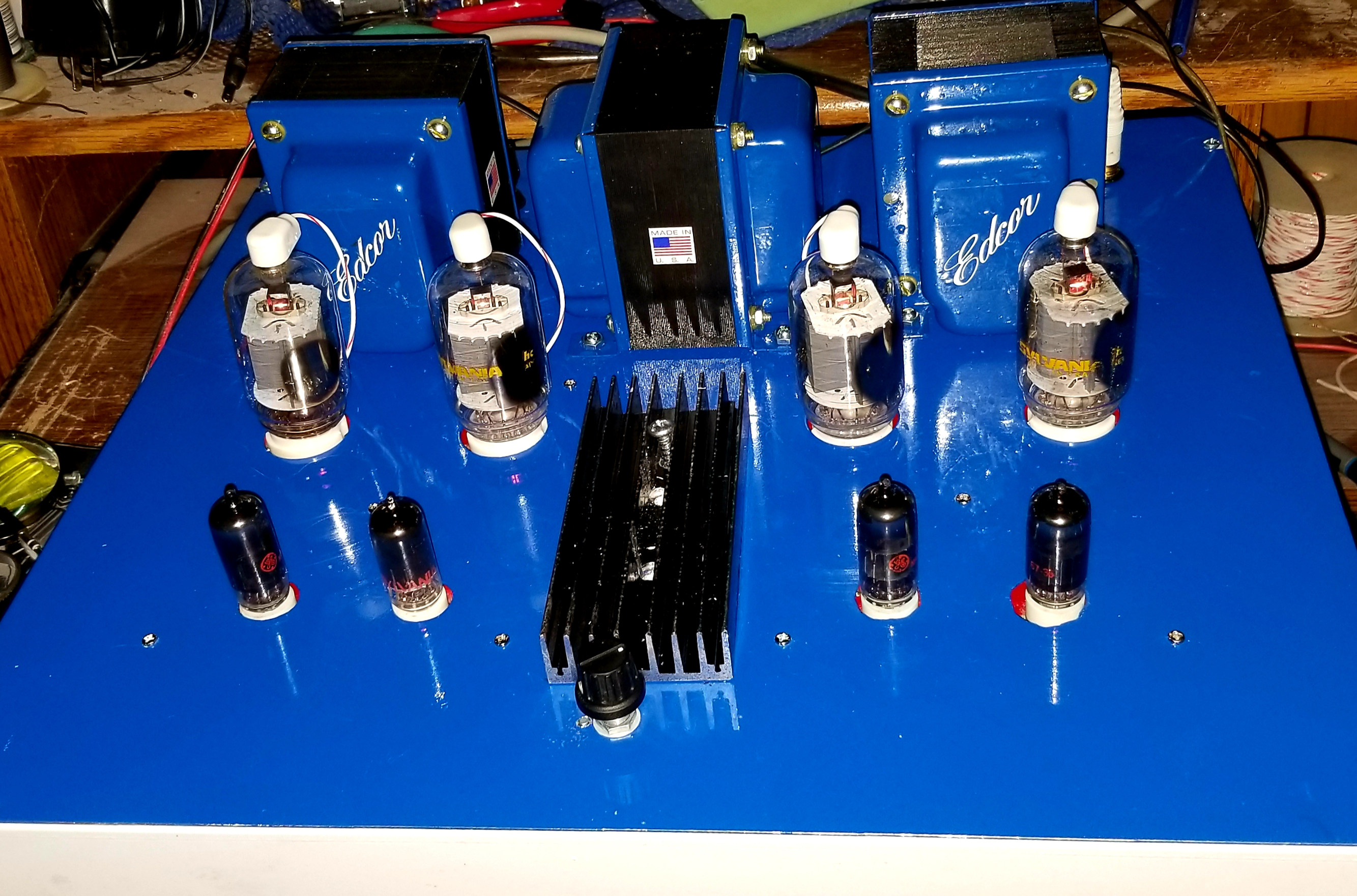

Hello everyone:

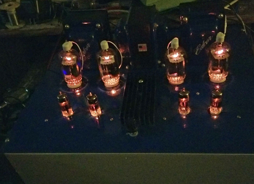

Another engineer's amplifier is now alive! Got the board 2 and a half years ago, stuffed it quickly and then patiently started to wait for Edcor transformers. Since I could not leave well enough alone, I upgraded the power transformer slightly (xpwr205, only difference being a slightly higher 300-0-300 winding from the stock xpwr139) and kind of overdid it with two cxpp50-6.6 . Once I go them, I kind got sidetracked by all kinds of other things so the entire project went dormant.
Yesterday I finally finished the wiring and passed the first smoke test. But no working amp 🙁
This morning I checked q1, and realized that my soldering job to the Drain pin of q1 had not succeeded. Fix that one and I had ...sound!
Everything adjusted right up and it now sound pretty nice. Happy camper!
This is tube amp #3 (Tu-8200 kit, SimplePP by Tubelab and now this). When is enough enough? I think I know the answer but... 🙂

Hello Phy, congrats for your build ! seems your wife likes blue 🙂
After having read all the thread content, I would like to build the same amp (got two more PCB from Pete) but with more power with the so-called boosted-B+. My idea is to buy OPT and PSU transformers from Toroidy in Poland. Not that I'm unhappy with Edcor good products, but the shipping costs from USA to Switzerland plus the non-EU customs taxes are dissuasive.
I still have to talk to Toroidy wheter they can make the stuff I want, and check what power and setup I can get from my 6JN6 stack.

Dear all,
The small voltage diff over Q2 is suspect to me : did I freeze Q2 or D9 ?

I swapped Q2 and D9 and the B+ is still about 388V. I checked all the resistor values, etc. Now I'm not sure how the circuit around Q2 works...
Maybe I do not have a real issue, if the voltage is high only because my power tranny gives higher voltage than expected : it produces twice 313V instead of the expected 280 of its spec.
Hints welcome.
I think someone would have said something by now if this was a problem.
