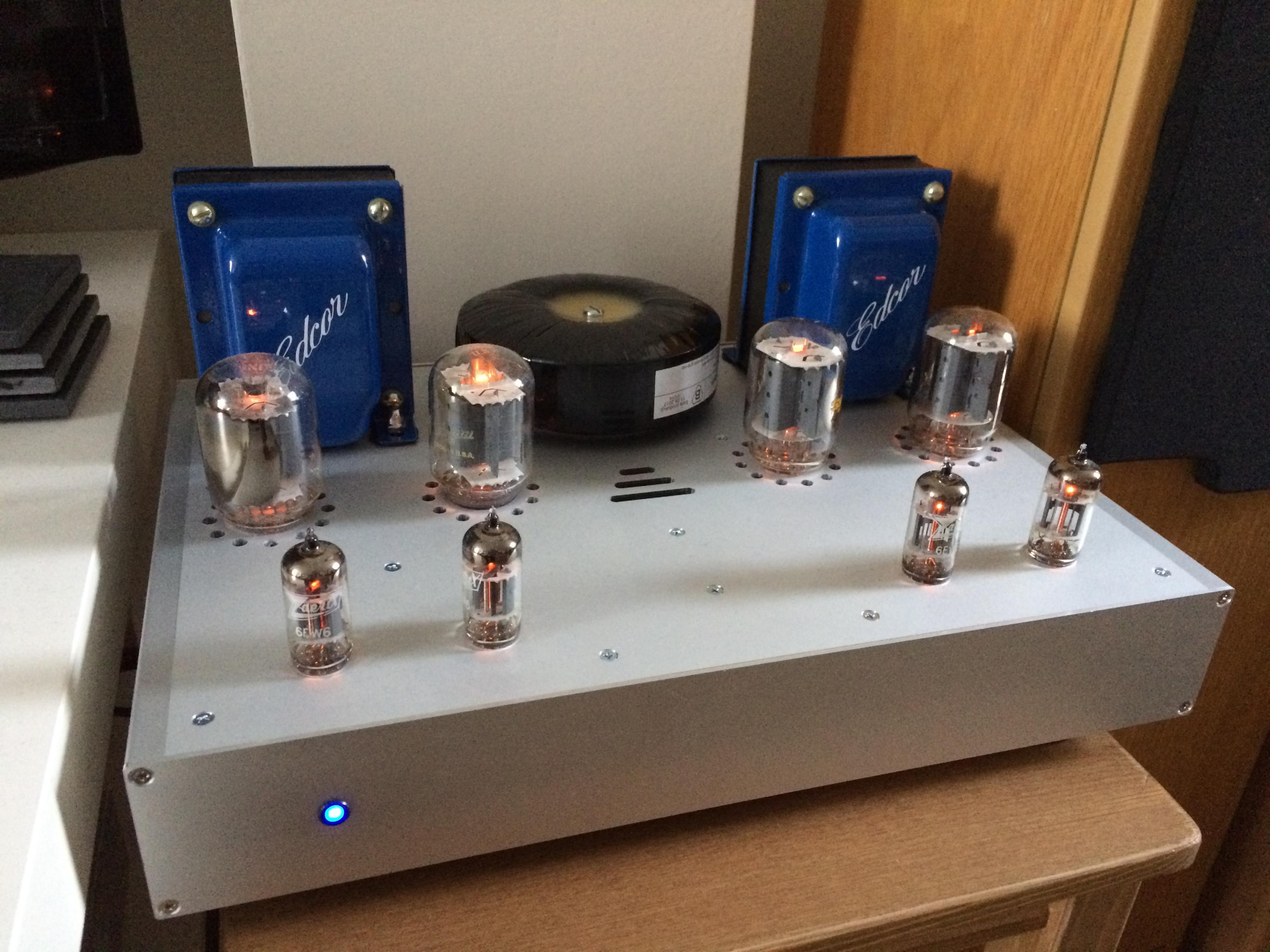

I had the same 'issue'. Th Edcor PT got very hot, probably well within spec but it made me a little nervous. So I ended up getting a custom PT made by Toroidy with the same windings but for 50Hz and a little more capacity. I also got a thicker top-plate made with vents. Much, much cooler running, especially with the fan. But I'm always looking for ways to go back to passive cooling.

I purchased the engineers amplifier PCB in 2013 and finally built it. There is a front panel express .fpd file on Pete Millet’s webpage but Pete said on the site that he was not sure if it’s correct. Has anyone used this file to get a top chassis made, or can you share a file known to be correct?
Here's are a couple of files I used. I took the autocad file, imported to FPE and edited it to what I needed (moved the IEC inlet / audio inputs to a rear panel). As far as I remember all the dimensions for the PCB mountings were correct, as were the transformer holes. Rename the flies from .txt to .fpe.Has anyone used this file to get a top chassis made, or can you share a file known to be correct?
Power-Top.txt is my first version using all Edcor transformers, _2 is a 2nd version using a toroidal PT.

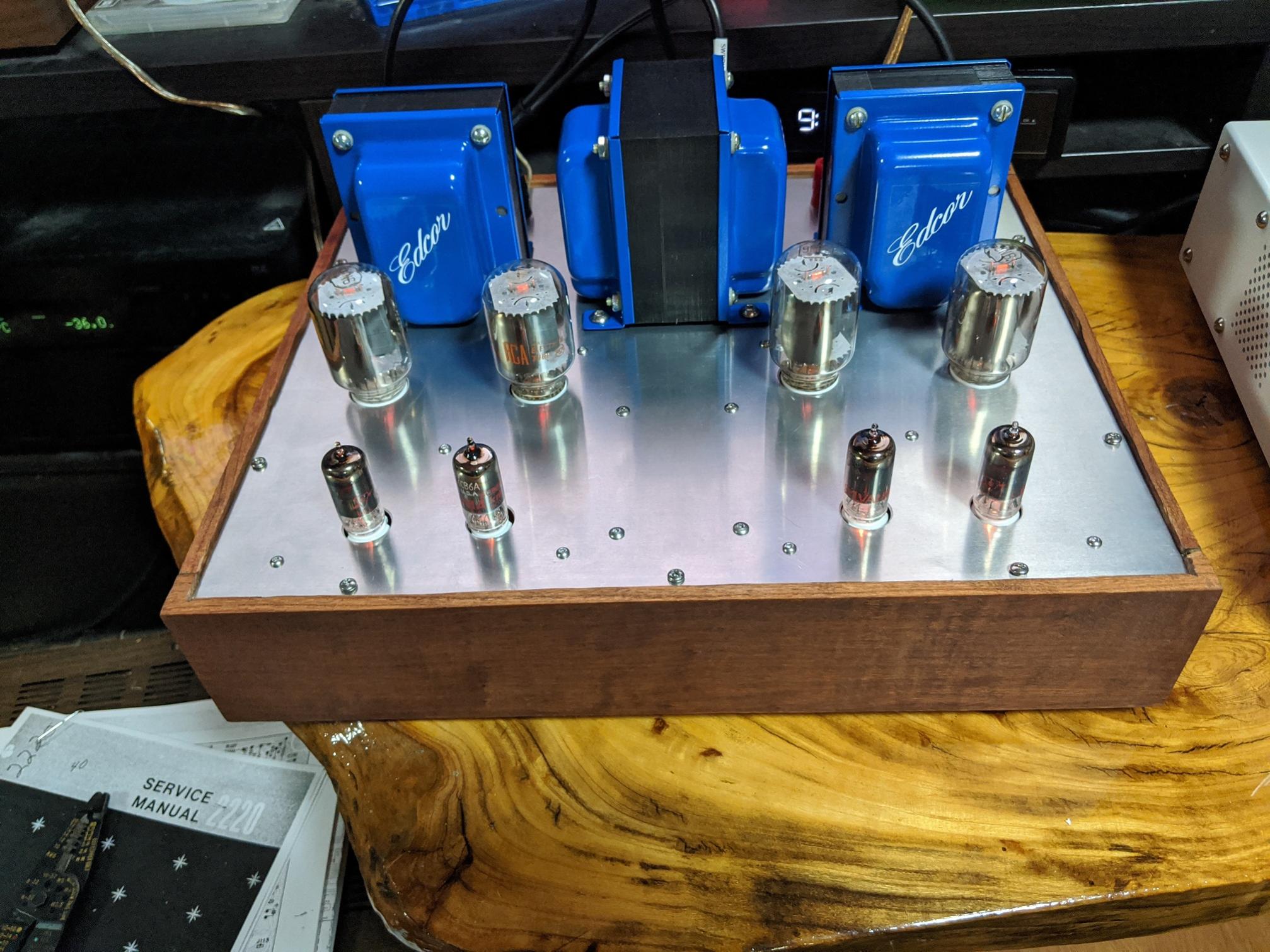

So, only 11 years after buying the pcb for this I finally built the amp.
I fired it up last night for the first time and got the bias dialed in and tonight was the first time I hooked it up to a decent pair of speakers. I'm listening to it with some Dynaco A25s and it sounds pretty sweet.
Its a stock build using the specified Edcor iron, I screwed a 3" x 4" x 1/4" copper plate to the bottom of the top plate as a heatsink, seems to work great, its only a little warm to the touch.
The only issue I have is the power transformer is producing a minor hum that can also be heard in the speakers, and its also running a little hot. It was worse when I had it plugged in at my workbench on a normal power strip with some old Klipsch PC satellite speakers. I have it plugged into an isolation transformer now and it is humming slightly less. If I put my ear against the speaker I can hear the hum but nothing at normal listening distance with the Dynacos.

So I've been thinking about this amp, and re-reading Pete's adjustment procedure. He mentions that the bias pots come from the factory turned all the way down and the balance pots are centered.
What I remember when I started the adjustments last night was that the bias pot was centered and the balance pot was all the way counterclockwise.
So I think what I may have done is installed them in the wrong positions so I have 5k pots where there are supposed to be 10k. Could this have any adverse effects if all the tubes biased up correctly?
I think I'm going to take it apart tomorrow and pull the trimpots out and check them out of circuit just for peace of mind.

Hi Coreyk78, good to see your project getting done... as for the pots, the bias value is important so be sure the pots can bring you the desired value of 0.4V across the measuring resistances as described in the "Adjustments" chapter. My original amp needed days to stabilize the tubes current, and after a few weeks one tube developed "cracking" and needed to be swapped out. No problem since then (~ 2 years). I have a 2nd such amp in the workshop on Toroidy PT and OPTs, more within a few days.
About the hum : I have a similar problem, in my opinion the original Edcor PT is somewhat at its limits, this is why I went for Toroidy for the 2nd model, and I will replace the PT of the 1st build if things go well. Simply too much mechanical noise on my 235V wall power.
I had another issue, a defective voltage regulation, see my post #1638. That caused 100Hz hum due to passing PSU ripple unfiltered through the FET regulation. You can use a free spectrometer app on your smartphone to identify the hum frequency, I have had issues to distinguish 50 from 100 Hz with only my ear... put it on lack of experience.
