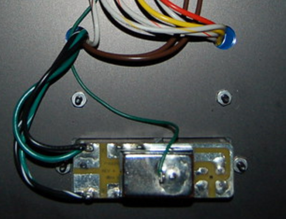

I notice in your underside shot that the copper traces of the power input module are very close to the aluminium top plate. Or is it a view issue and you do have enough space there ?
For the sake of liability & insurance would it pass a UL inspection?
OK if for yourself but be careful what you put your name on.
If your stuff causes injury or fire its not a good day!
Many underemployed lawyers are always looking for an opportunity.:eek:
