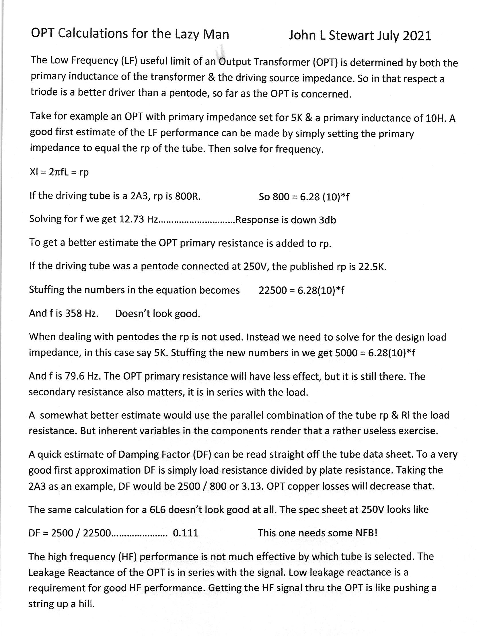

If a single ended amp uses a Pentode and no negative feedback, and the output transformer has a lot of leakage reactance from primary to secondary, then . . .
The high impedance pentode rp, sees a rising load impedance as leakage reactance becomes significant.
So . . . the pentode plate voltage gain increases as the leakage reactance increases.
That helps to flatten out the high frequency roll off that the leakage reactance to the secondary caused in the first place.

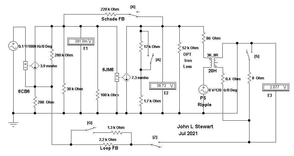

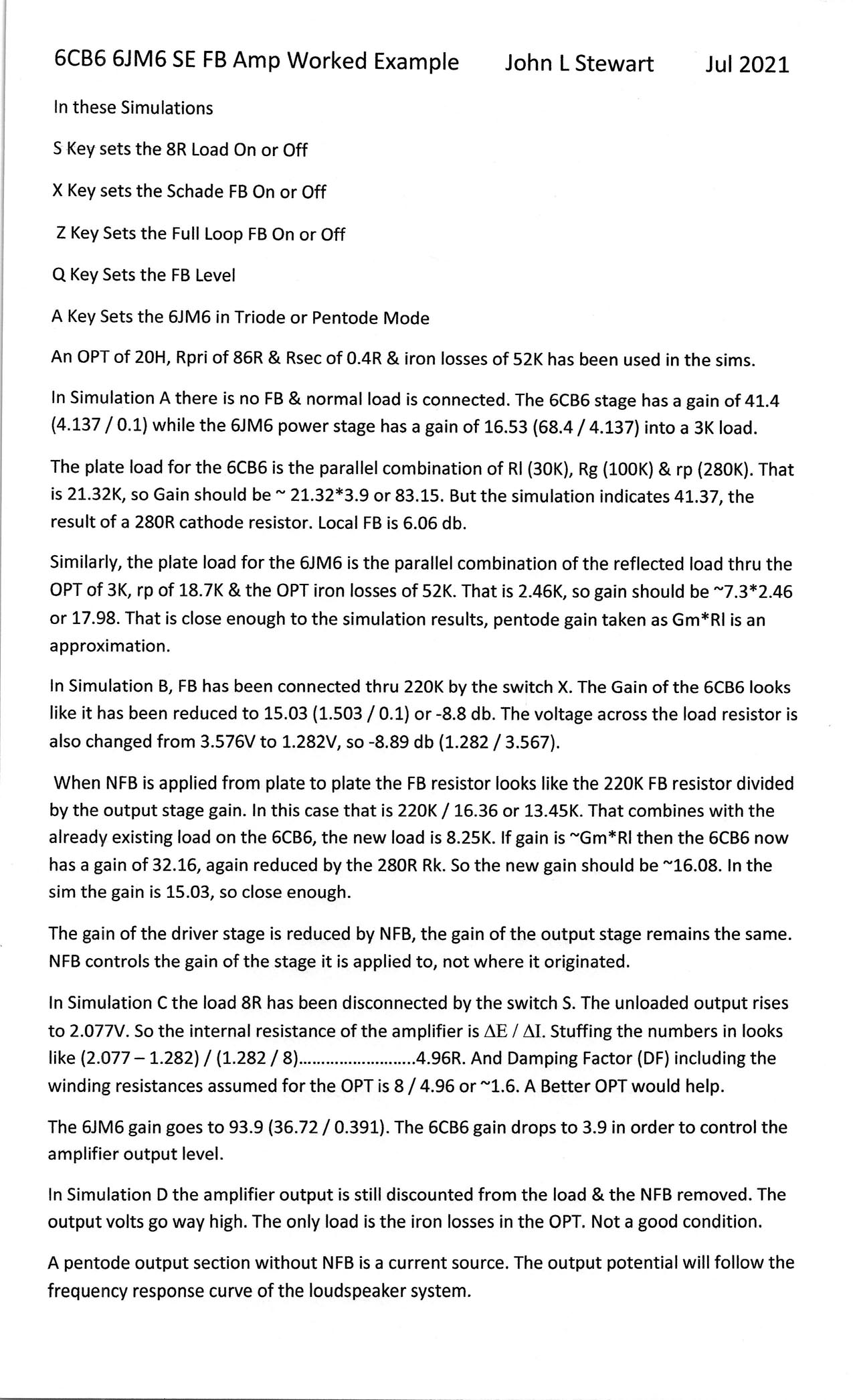

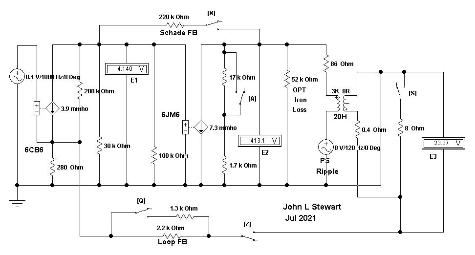

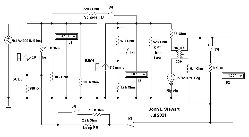

Opus ll- 6CB6 6JM6 SE FB Amp Worked Example
These sim's uses symbols for the tubes that some newbies may not be familiar with. In short, each tube is represented by a voltage controlled current source, ie mA per Volt in parallel with a resistor of R Ohms which is simply rp. The Voltage controlled current source also uses units of conductance, the mho. In this case it is mmho or milli mho which is simply mA/V, the transconductance of tte tube. Conductance G is simply 1/R.
The advantage of this kind of solution is that it gives a good estimate of circuit performance without the complication of all the DC voltages involved. And used extensively in all the textbooks covering electronic engineering.
The circuit constants used are similar to those in Pete Millet's amplifier in this thread.
