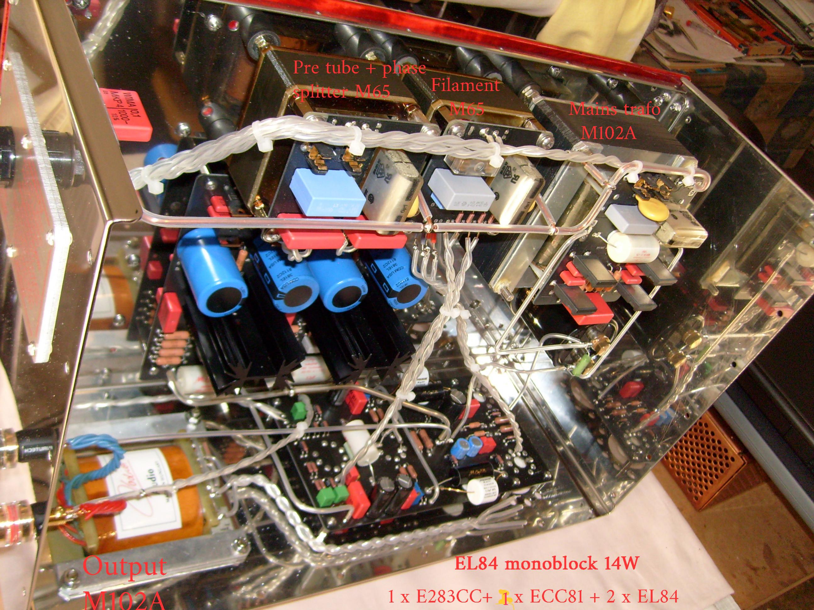

Hi!
I show you when there is no compromise:
I know him well: he studied to be a Hungarian "amateur" railway mechanic.
This is how he builds an amplifier. Nothing heats up here except your wallet. He hasn't made such an amp for himself, only for others, because he can't pay ...
Full silver wiring.
2 x 120VA transformer - own design
2 x 25VA transformer - own design
3 power supplies
(3 transformers) + output transformer
Monoblock!
E283CC - DC filament
Each electron tube has its own heating coil.
The picture also speaks.
The owner is in heaven when listening to music.

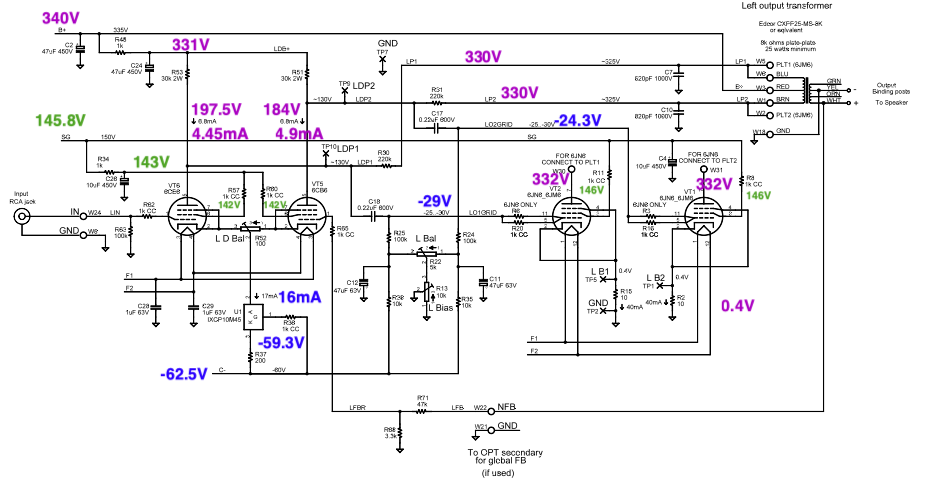

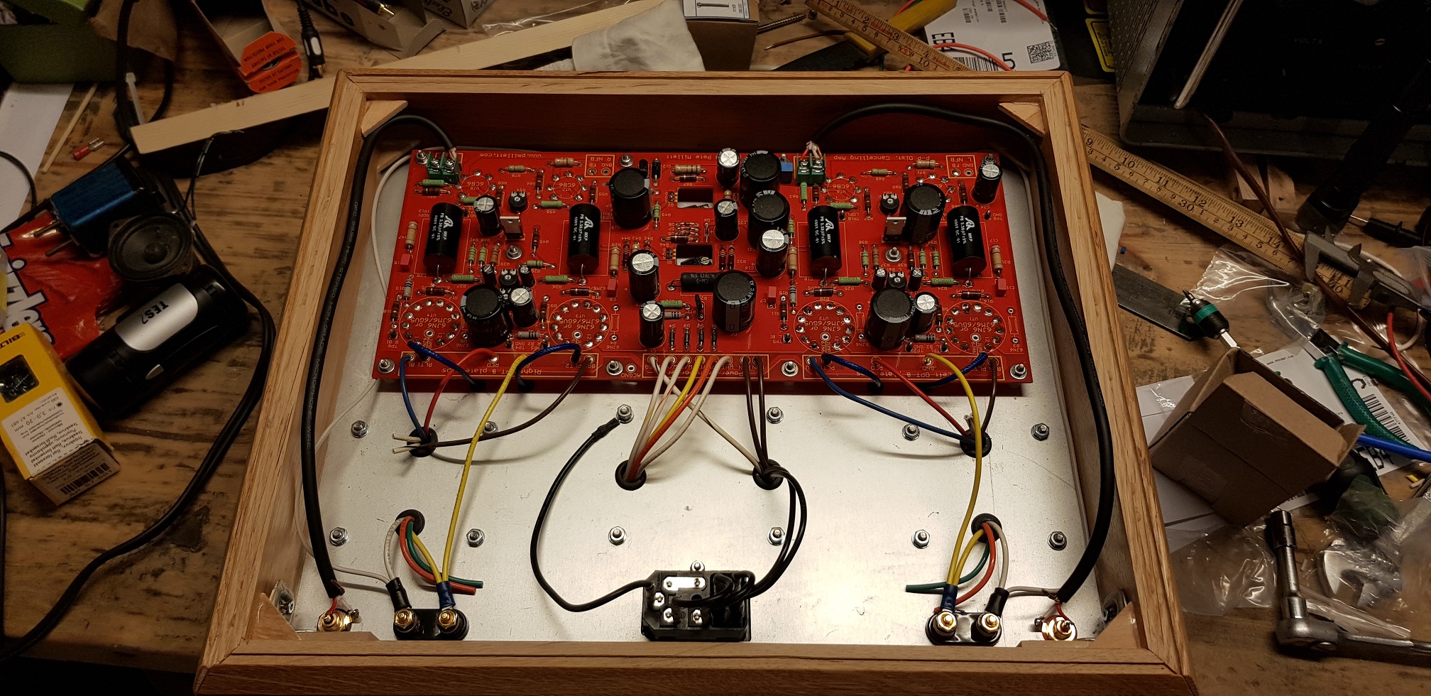

Finally, after many years of waiting, disruptions and collecting parts... I was able to finally finish my amp! And it sounds good, but I am a bit worried about a few things...
The driver bias adjustment is very touchy. Is that normal? I measured a few things, and found that the bias pot measures as 5k in-circuit. So maybe I made a mistake there. In the end I did manage to get withing few mv of 400 though, and it seems stable enough, fluctuating a few mv up and down.
My next concern is the driver bias. The schematic shows 130V, but I have 210(Left)-220(Right). They are balanced without any problem though.
Overall the voltages seem to be a bit off, but I wonder how much is ok?
B+ says 340 +/-20, I have 365 (was 400 until I got bias adjusted)
C- is -65 instead of -60
The 325V are 355-360
-25-30 is -22-25
Should I start investigating or relax and enjoy the music?

Attached are my voltages if that helps you relax. I could never get the driver stage plate voltages to what Pete measured. Somewhere in the thread someone suggests this is valve-dependent. Or R37 needs adjusting. But I get the same current as Pete...
That is very helpful, thank you! Will check some more and compare with your measurements. Looks like yours are a bit off in some places too. How did you measure milliamps? Disconnect, measure and then reconnect? Or is it all done by measuring voltages and calculating?

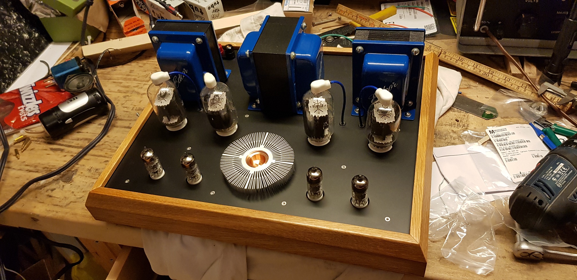

Great look Holtet, I like the top caps and blue cables !
To calculate the current, measure the voltage across the resistors and apply ohm's law. (I = U/R). Eg over R51 : (331 - 184) / 30k = 4.9 mA
By the way the dissipator look great but you will need to use a vacum cleaner from time to time or the management will complain

Measuring voltages & calculating. So all approximate.How did you measure milliamps? Disconnect, measure and then reconnect? Or is it all done by measuring voltages and calculating?
I balance the driver stage using a USB scope's FFT for minimum THD% - which is very fiddly. And I bias the power stages using 2 multimeters - one on each test point for the channel, swapping back and forth as one channel alters the other's bias. I try and 'pre-match' the valves in to pairs using my uTracer. So this helps minimise adjustments between valves.
I have tried this as well, but my Siglent Scope's FFT is too weak to help anything. So I have embarqued into the analysis chain : Jan Didden's Autoranger, a sound card (Steinberg UR-22) and REW... still soldering the autoranger so can't say if it will be better for this purpose. I guess so as the AD converter of this sound card is probably much better than the 8/10/wathever bits stuff in my cheap scope.

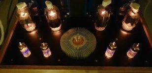

Thanks! The cables came from the cooking top of my parents' old kitchen that we were throwing out. They looked at me strangely when I said I needed those... It was too hard to explain that they would fit perfectly with my latest project
The dissipator is from an old intel cpu. I thought it looks quite cool. But obiously not optimal since it's designed to be used with a fan. And yeah, will be a PITA to clean after a while
