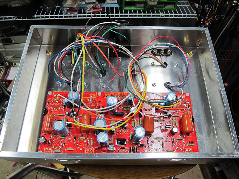

Posted new P-P power amp design
Live ... again ..... testing
Definitively stock power transformer is better, there’s plenty of power and I feel more comfortable with voltage.
These days I’m testing different combinations of 6HJ5 and 6CB6 brands, have RCA and Mullard (International) for 6HJ5 , Philips and Sylvania for 6CB6.
Using "good" loudspeaker, self build Cornu with Jordan's Eikona.
Now the problem is that the amp produces an (almost inaudible) buzz that is annoying and after some time (15-20 minutes) gives me a mild headache.
Don’t know how is possible that something barely audible makes me feel uncomfortable and gives headache….
Probably it depends on optimize the balancing of channels, or changing the tubes….that's what I'm working it these days.
On other side working on the case, Ikea baking tin is made of strong inox…..
Almost done:
700 volts is probably too much for the 6HJ5's. They will eat the voltage OK, but they need about 30 mA of bias current in this amp to sound good. That puts the tube dissipation at 18 watts per tube with 600 volts on the plates, which is OK, but about as hot as you want to run them at idle since the current goes up when you run audio through the amp. 700 volts will run the tubes at 21 watts each at idle.
Whatever transformers you use, do not run the second transformer on the output of the voltage regulator. Any issues with peak currents, momentary overloads.... will result in the aroma of fried parts.....like mosfets. Connect the CT of your second power transformer to the positive end of C6. If you have the filter cap on the second transformer wired as shown in your schematic it must be rated for the entire B+ voltage (700+ volts). Move the negative end to the CT of the second transformer.
PRR mentions that the original power transformer is only rated for 200 mA. This is marginal since the amp will idle at about 140 ma (4 X 30 mA + 4 X 5 mA). If you plan to listen to music at a reasonable level through reasonably efficient speakers it should be OK. Things like cranking something loud to the edge of clipping and leaving it to play at that level for hours, or plugging a guitar preamp into it, and setting it on KILL, would require a larger current margin. I have done both of these with my amp and it still works today with the original tubes in it.

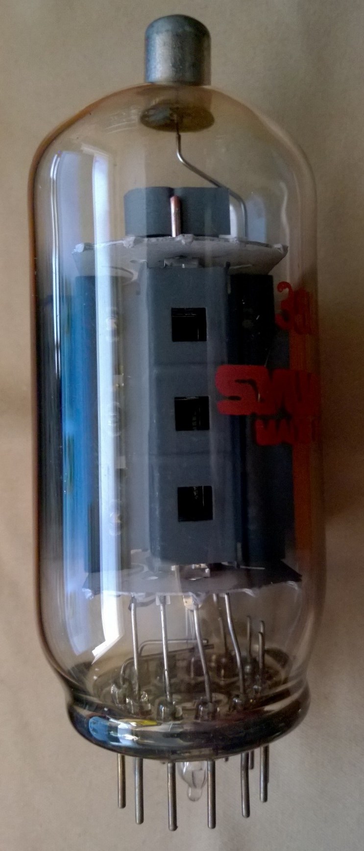

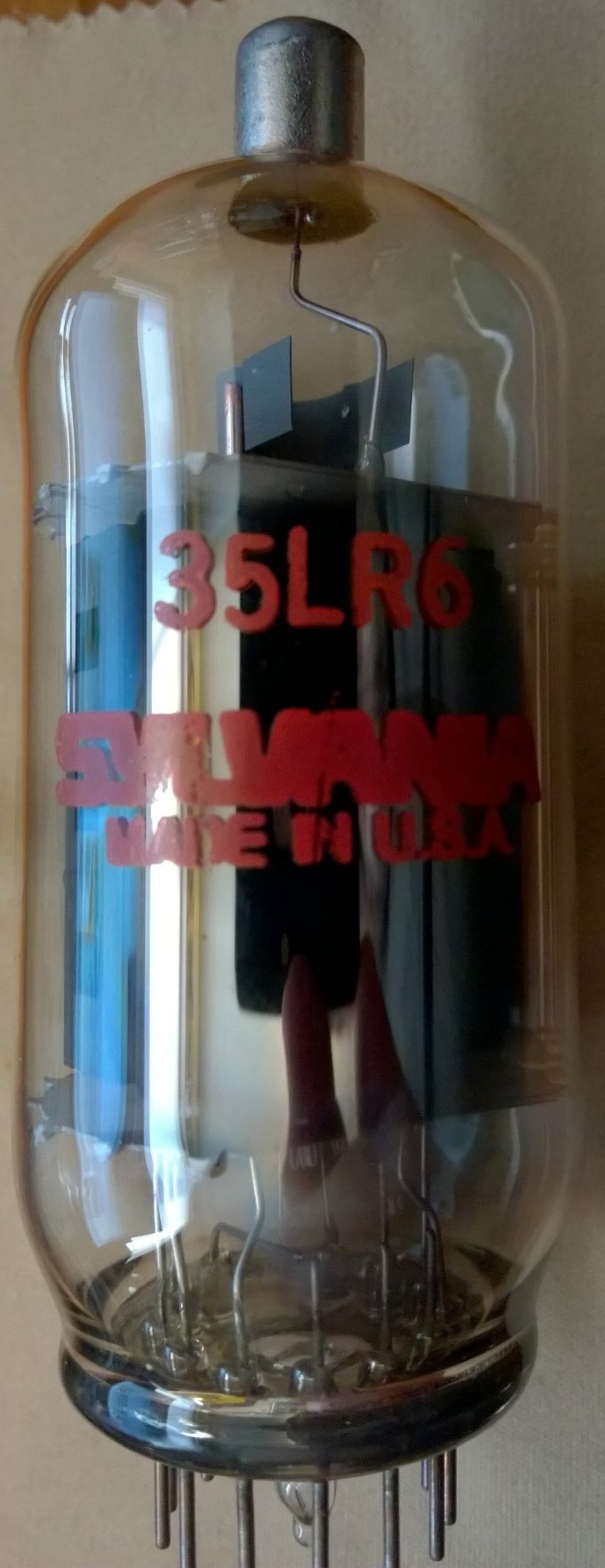

If anyone by chance is looking for 35LR6s, I just got 8 Sylvania from Roy and Dale but unfortunately need to turn them around again as our "accounts" have been hacked by a not so nice daughter/step-daughter to the tune of $2500. So I am offering 8 brand new Sylvania for $60 and I pay shipping. At 57yo, I should not have to deal with this stuff.....
Ray
