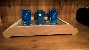

Finally got round to finishing the PCB build on this and powered it up. Luckily had no problems. Valves balanced all OK and when playing through some old Kenwood speakers the sound quality was excellent. Still building the box as you can see in the picture. I hope to have this finished soon. Thanks Pete for a great design and very easy to follow for a newbie

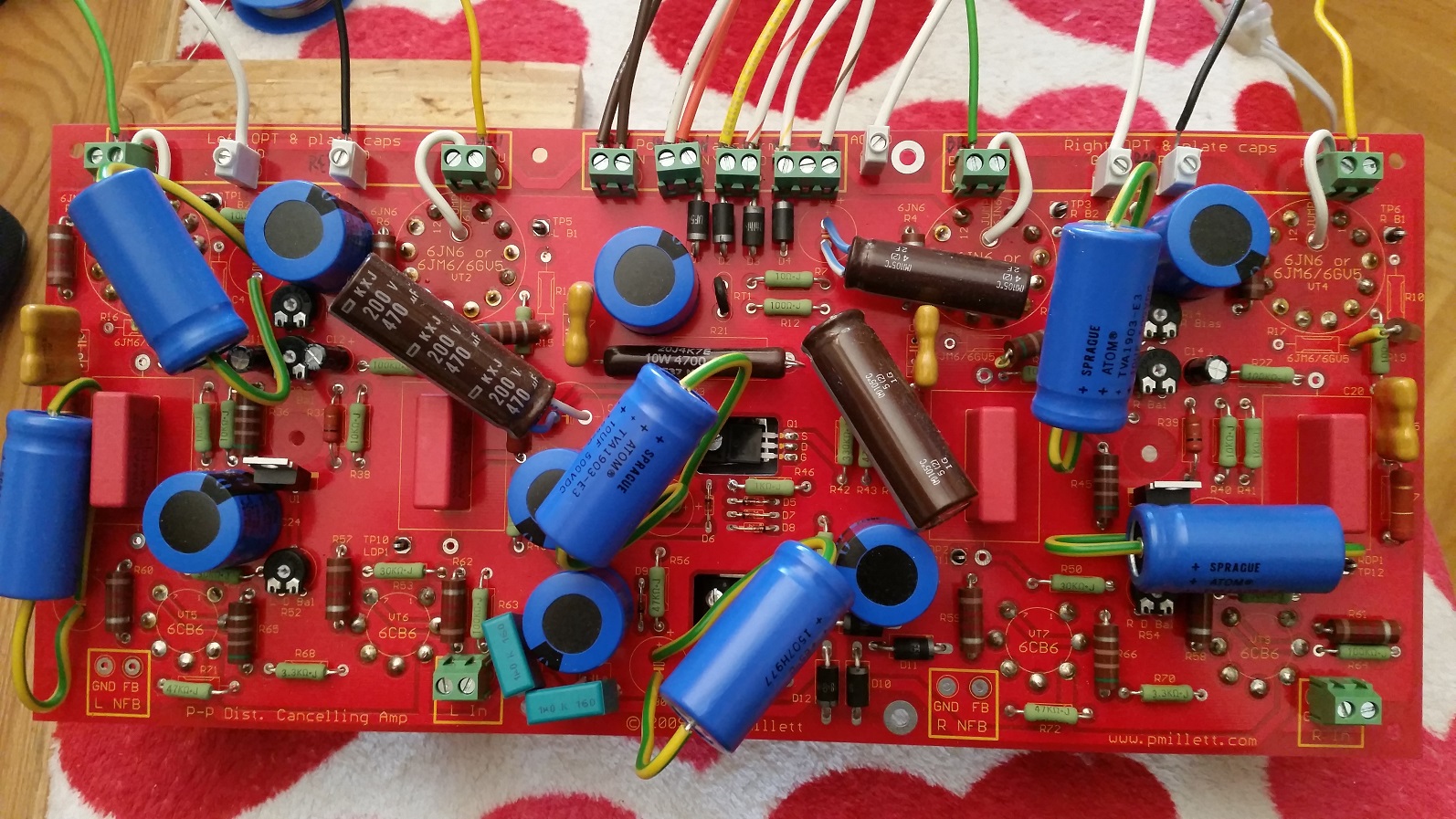

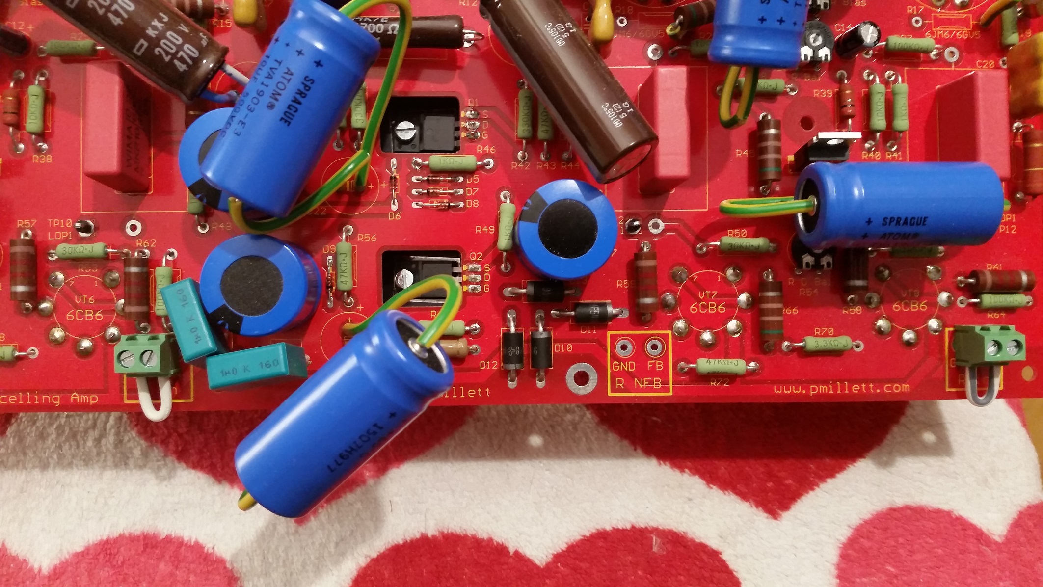

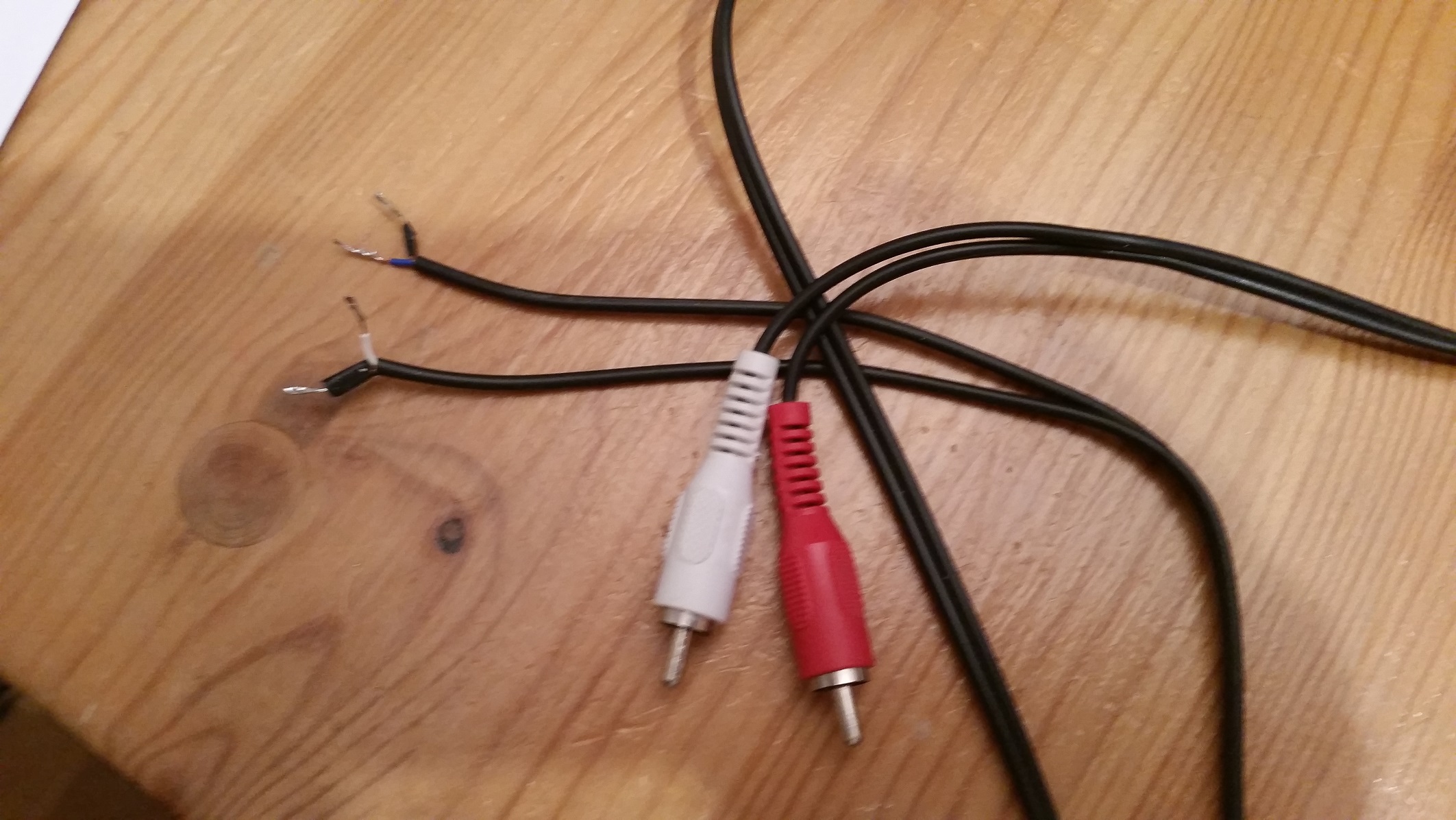

Hi all, so after some months have had time to complete the red board (photo1 and photo2).

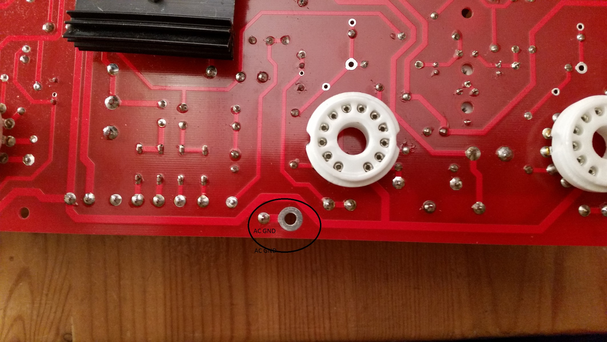

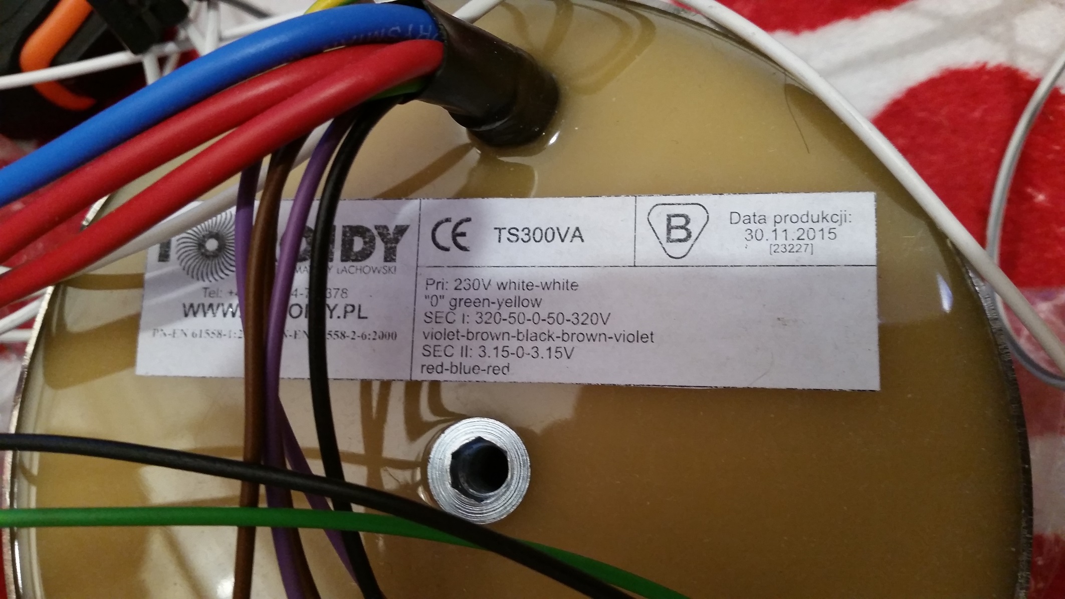

I’m doing the version using 6HJ5 and a slightly tougher power transf (photo3) [toroidal custom made]

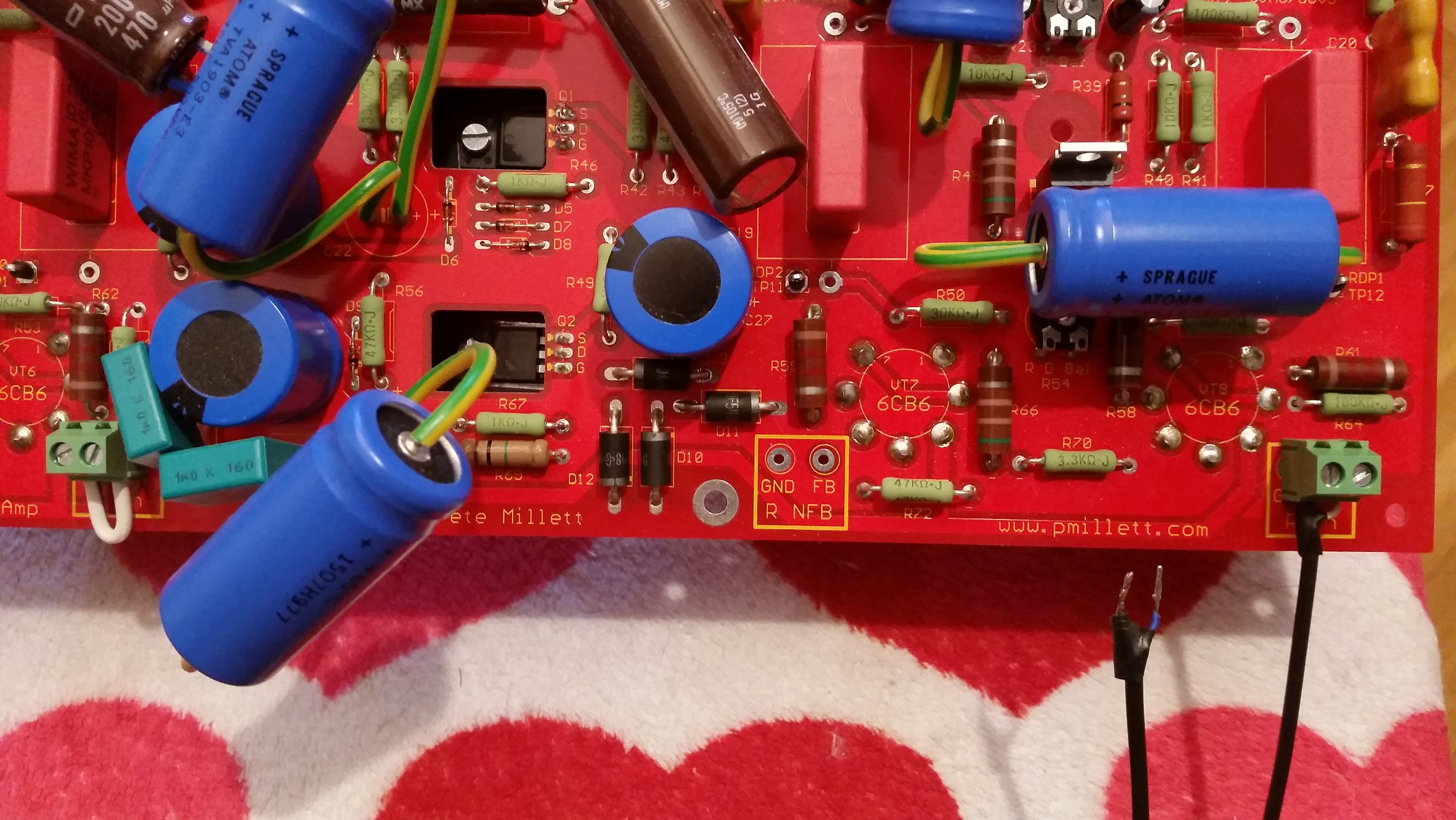

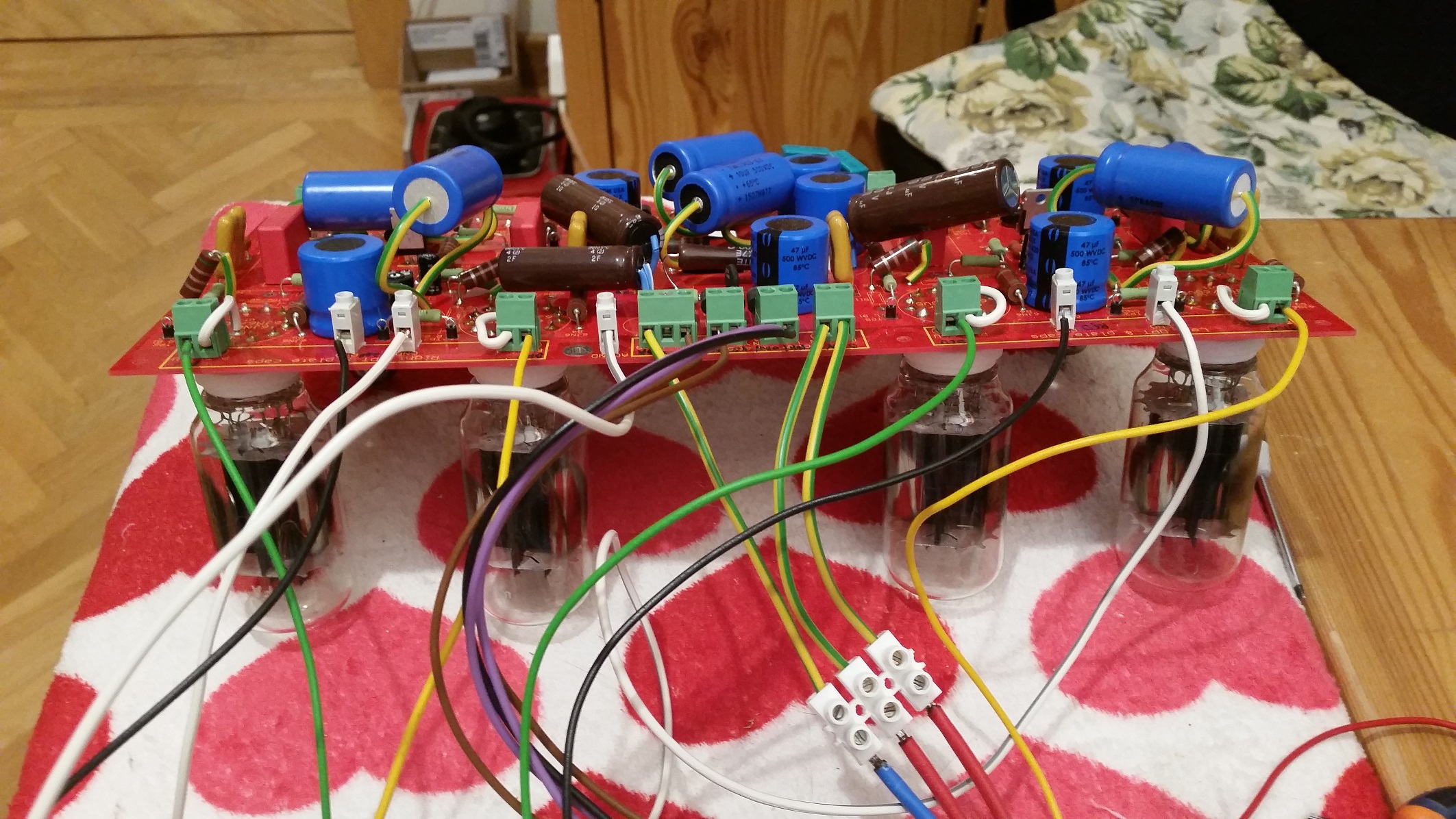

First powers up were made using a variac (photo4), when nothing exploded made the bias adjustment following Millett’s web

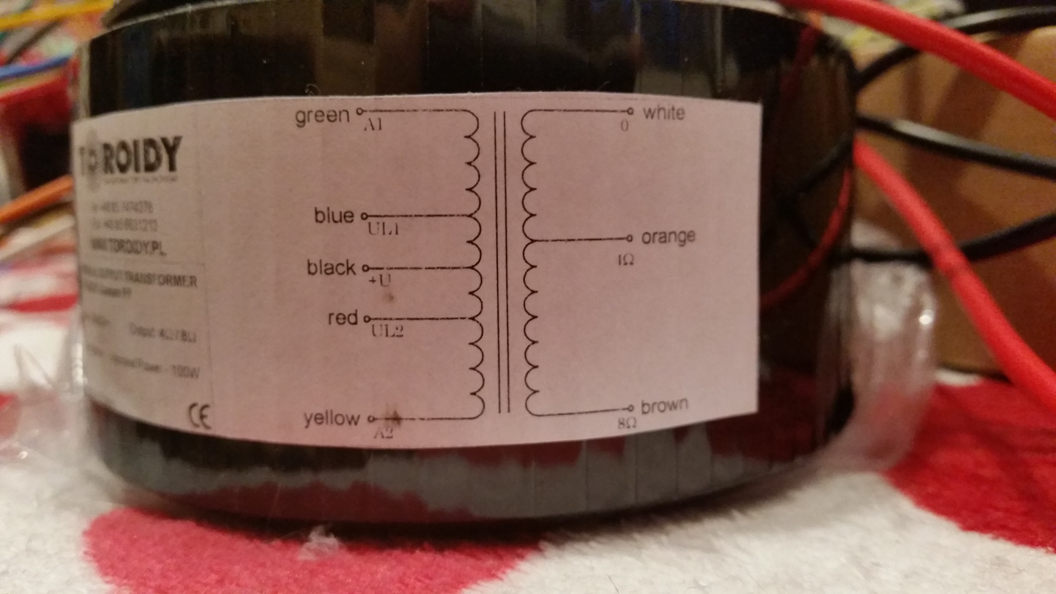

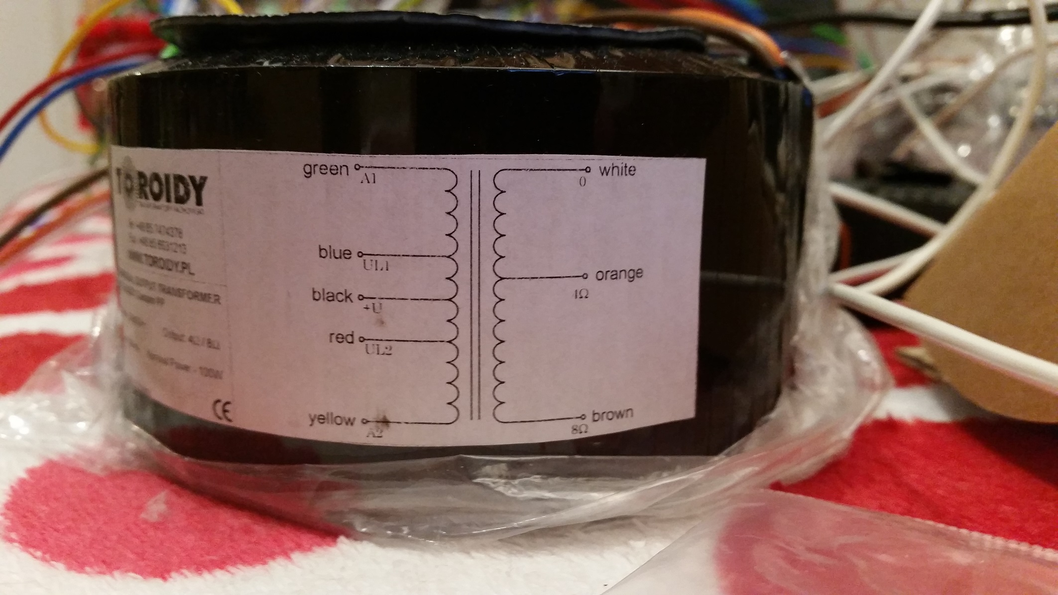

The output transformers are 3.3K custom made too (photo5)
Now, I have a big hum problem, something must be missing or incorrect.
With no input attached there is a faint hum through the speakers (4 ohm impedance).

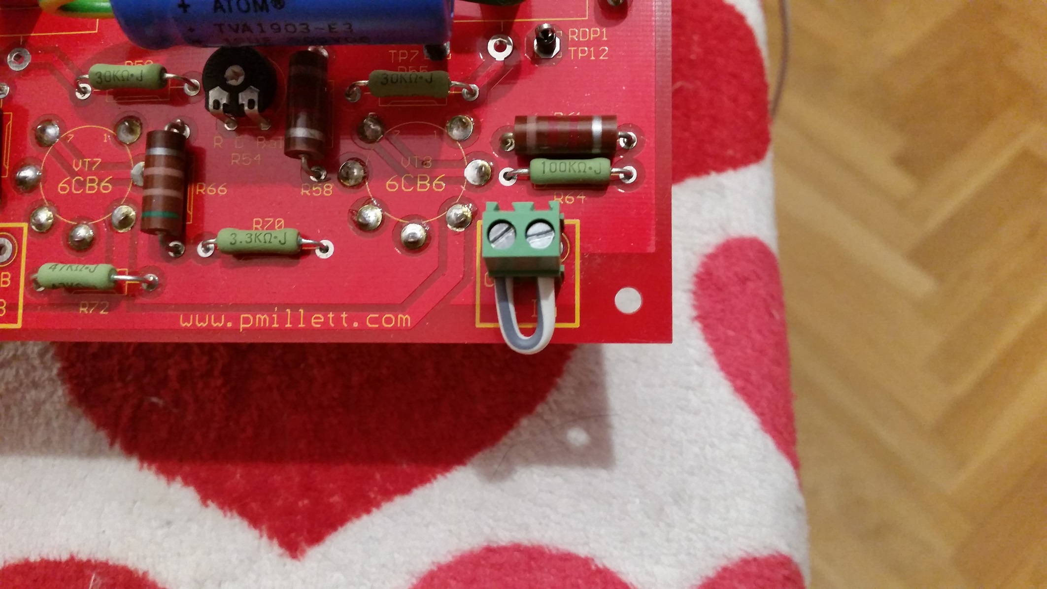

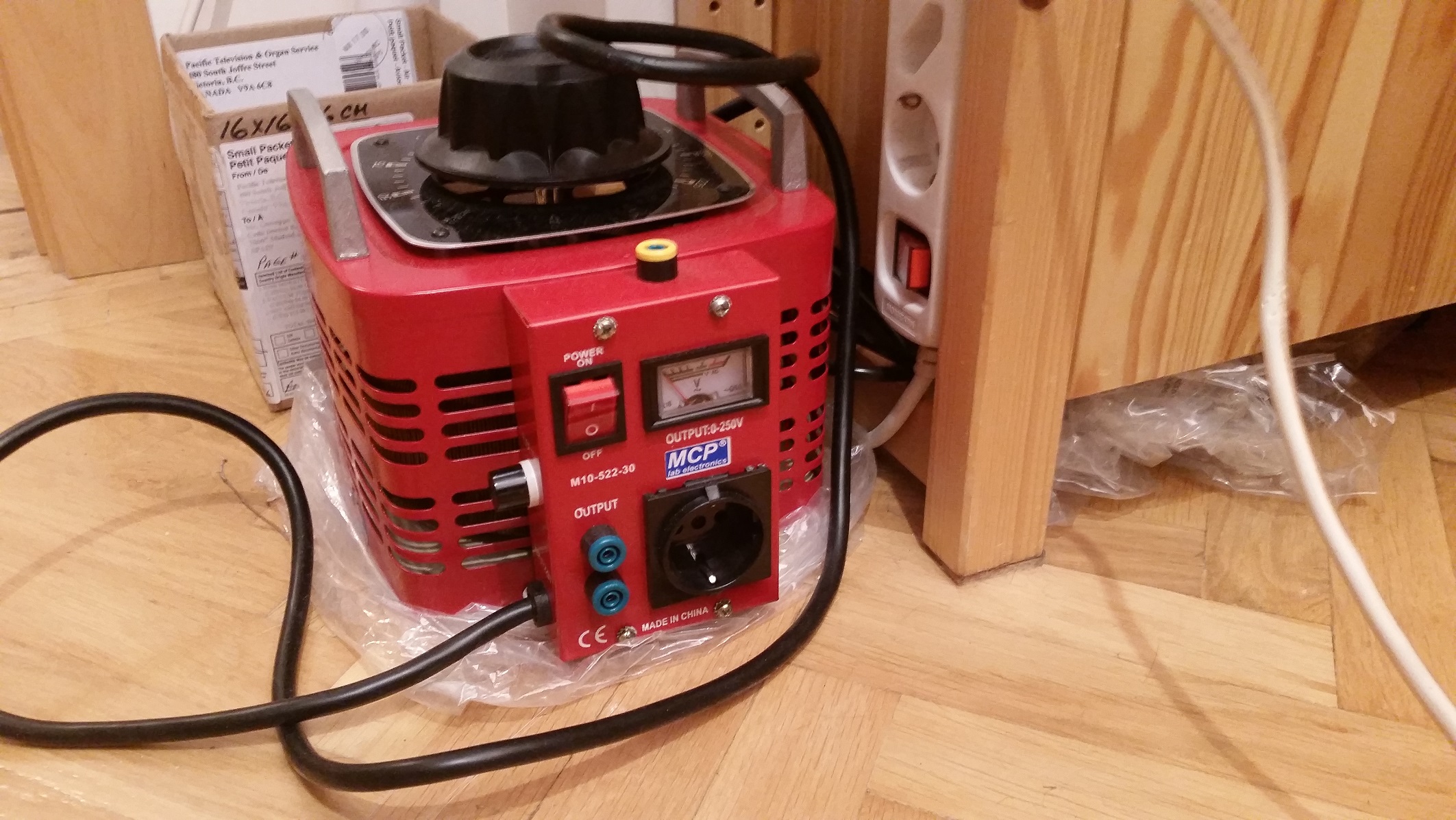

Simply putting an input cable (photo6) with no source attached make the hum grow considerably.
Trying to connect a preamp (an Aikido preamp) makes A LOT of hum.
Must have done something wrong or there’s something missing.
1) Someone had same problem? Any suggestions?
2) Output transformer : being a push-pull amp, am I correct using the A1,A2 (Anode, suppose) instead of UL1, UL2?
3) At the moment there is no chassis so no chassis ground : so where should I use the ground loop breaker suggested by Pete?

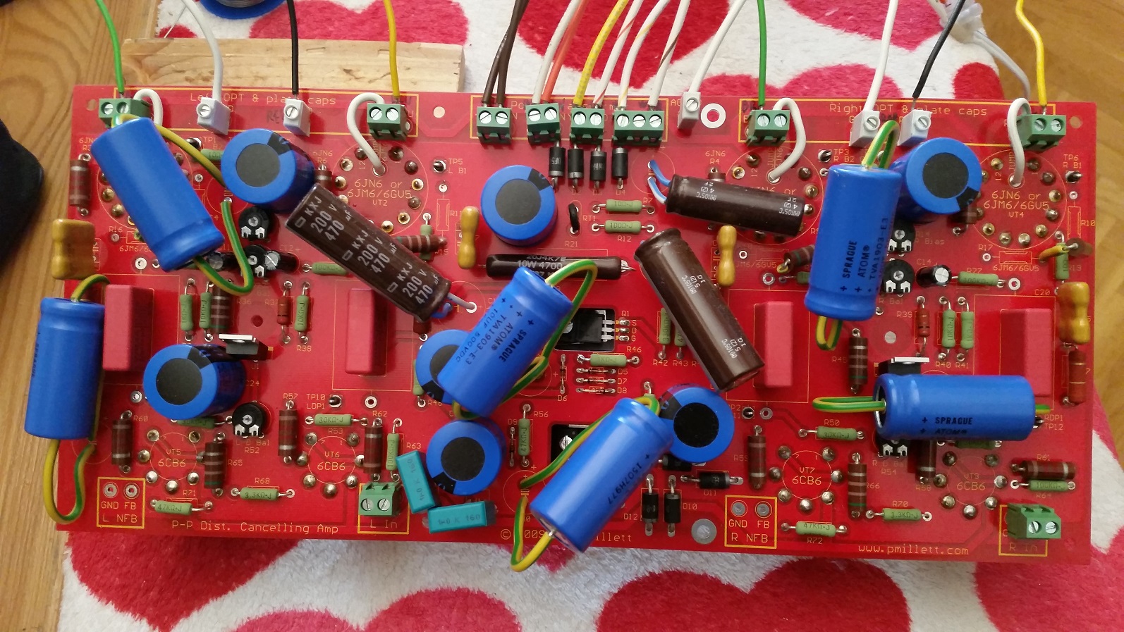

Here.....still with the big HUM on the red board (photo1 and photo2).
I’m doing the version using 6HJ5 using custom EDCOR power transformer.
Output transformers are 3.3K custom made.
There is a big hum problem, something must be missing or incorrect :
Touching left or right input with a metal make the hum grow considerably.
Trying to connect a preamp makes A LOT of hum.
Measuring AC between AC GND and IN (right or left) get around 30V AC
Disconnecting AC GND cable, the hum is still there.

Just to be sure : I'm using toroidal P-P output transformers, I understand I should use the A1 and A2 wires + black for B+ (photo attached)
