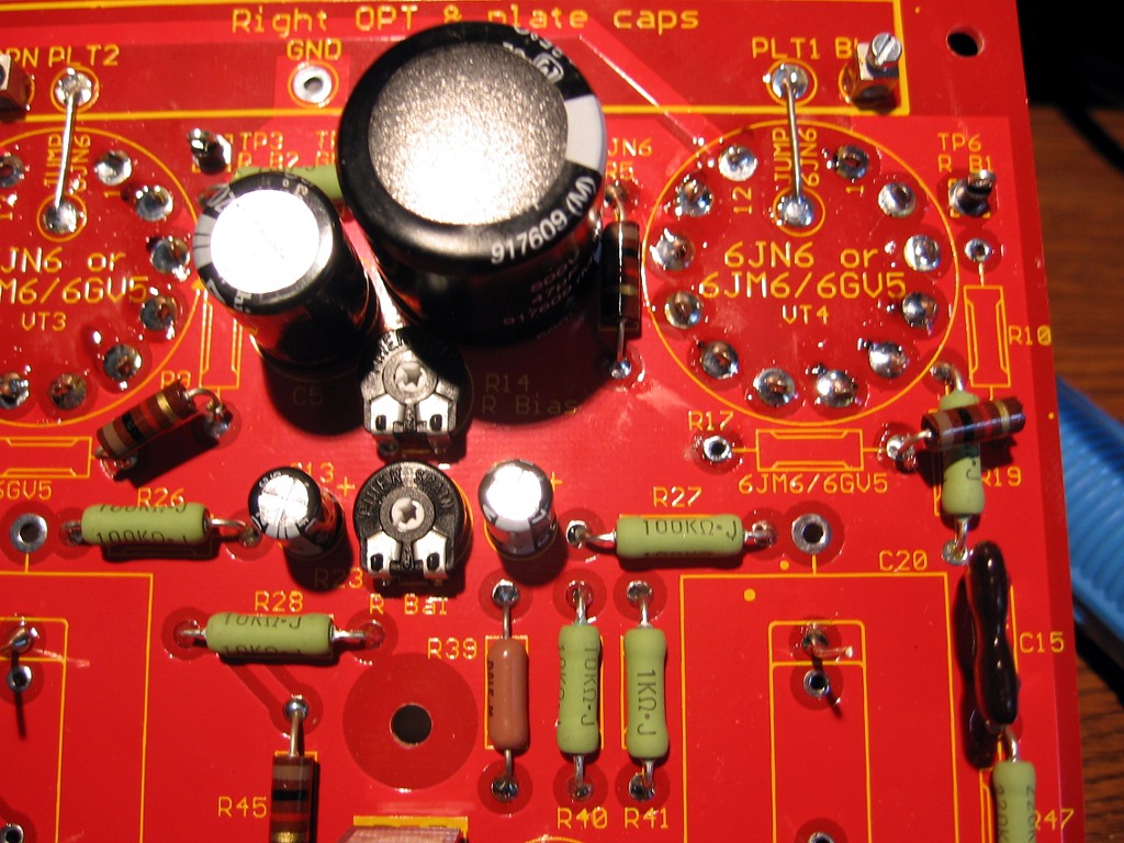

Hello everyone:
I just finished stuffing the "Big Red Board" (BRB 🙂 ). The build is completely stock (only thing R21 is still 4.7K with just a bit bigger dissipation at 7W instead of 5 W).
In an timid effort to get a little more out, instead of the Edcor XPWR139 (280-50-0-59-280), I ordered a XPWR205 (300-50-0-50-300). This should give me a bit higher B+ (perhaps 10% higher). Not enough to worry about caps, I think.
For output transformer, I think I may have been too "optimistic". I ended up ordering a pair of CXPP60-8-6.6K . I don't think I am going to see 60 WPC, but in the future, should I make more mods, I should be set.
Do you think I'll see about 40 WPC ?
Marco
Oh yeah, I read a lot of the posts. is that I am simply not savvy enough to run this thing with a 600V B+ and changing components on the fly, nor I have large transformers and /or power supplies to try.
But I have seen suggestions that a modest increase in B+ coupled with lowering the impedance of the OPT can help. We'll see when the transformer get here.
