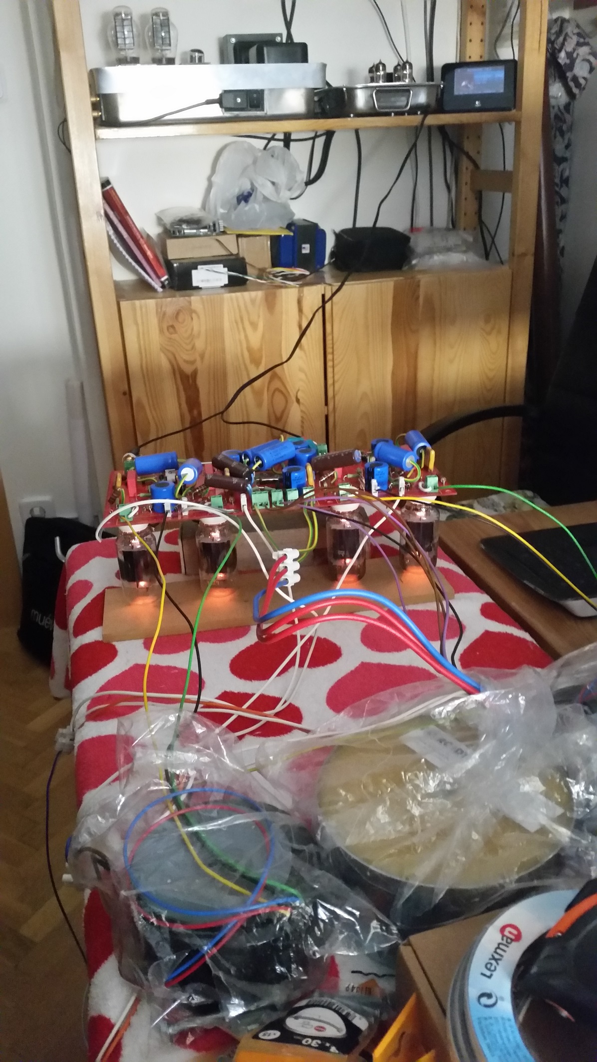

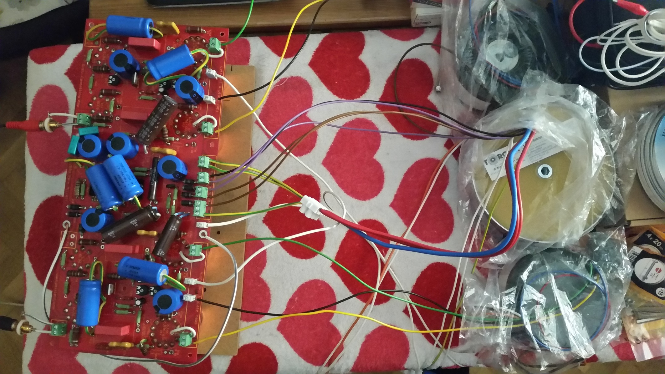

So, just tried right channel, (photo and video_1) there's same hum.
Video right ch : https://youtu.be/GPc9Te02h6M
Tried left channel (video_2), unlikely same result.
Video left ch : https://youtu.be/XDCX3hDdKk0
It seems that hum is present independently on both channels.
Just to be sure : I'm using toroidal P-P output transformers, I understand I should use the A1 and A2 wires + black for B+ (photo attached)
to me your amp seems normal, when you touch the input with test lead, the lead acts as an antennae and pick up hum....
just input music and see what happens....enjoy, do not worry too much...
just input music and see what happens....enjoy, do not worry too much...[/QUOTE]
IT WORKS ! ! !
Probably it was working well from the start, but didn't make correct input connections and there was an antenna effect.
Here's a video : YouTube
Now it's working very well.....
Next steps : balancing channels, building a case......
But above all, DEEPLY THANKS to all people that answered .....
Along this time when I was looking hopelessly to the amp, answers from helping people even if only encouraging, have been of great help.
Thanks again.

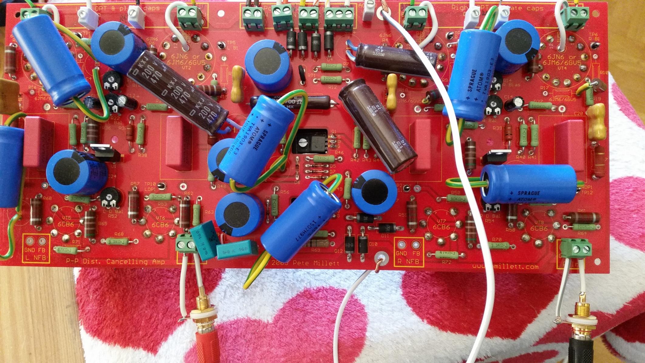

Regarding sound impressions will make better comparisons between DCPP and TSE 300B this weekend.
The problem I see now is that on right channel there is a big voltage difference between the two 6CBA (input), probably depend on tubes...will try to switch them or change.
Thanks again
No, the voltage difference is more than 50V
There are trimmers (pots) to adjust the voltage difference but where on left channel I've been able to adjust with a few voltage difference, on left channel best adjust still makes a 65V difference.
That's too much, I think that unless make some big error with some resistance (will check) there must something with one tube.
Luck is I have more 6CB6 to try.
In my case there must be something wrong.
Left channel is perfect.
On right channel without input source best situation is a 60V difference between the two 6CB6, changing or swapping tubes between channels doesn't change the thing.
So must be something "hardware", thought maybe a resistor but yesterday verified values and compared channels .... all seem the same.
Will keep looking.

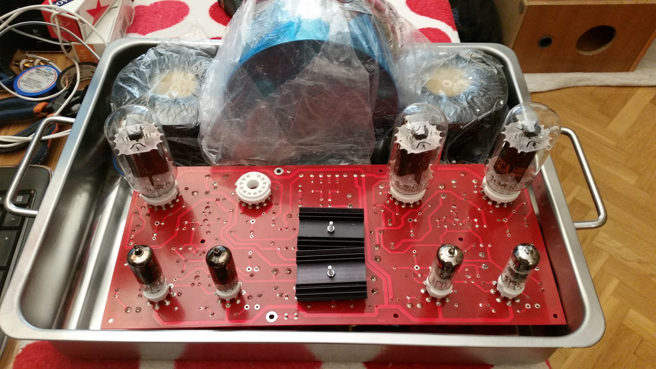

Should had left all that way....working... stock power transf...but devil of changing things made me decide to put at work the special bigger power transf (320-50-320 instead of 280-50-280)
First error : power cables in wrong order. Checked it three times....all seemed correct....ON and...smoke and bad smell, R7 (10 ohm) bright red and C1 smoking....ARGH
Unable to see my error thought it was a bad diode....changed it and changed R7 too, only to have more smoke....until finally saw my error.
Changed power cables, all in order, amp working again.....
Wise should have been go to sleep and follow today but you know there are days..... so go on to balance power tubes (6HJ5)...I've done hundred times....
Second error : was measuring plate voltages on right channel with two multimeter, what I did was while black cables where on right channel test point, put one of the red on left channel test point, thinking nothing would happen. Result : R2 (10 ohm) bright red and left channel dead.
ARGH...again finally decide go to bed
Today put right channel power tubes on left channel, it works...so one 6HJ5 must be bad.

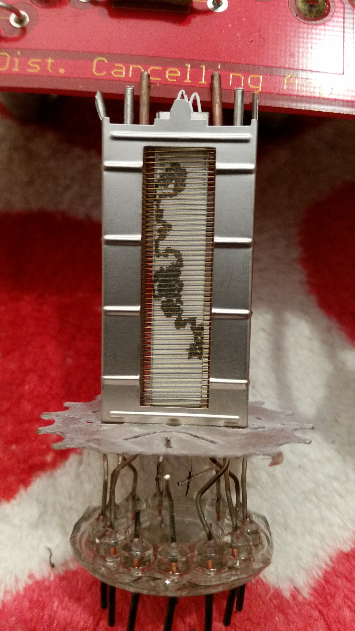

A little work more and find bad tube, have opened it and attached a photo, what may be that strange worm-like draw? Is that the plate?
Ordered some more 6HJ5, hope not to make more errors.....
Just to make you know...
Thanks for reading
That was the cathode. The "worm" is where the white oxide coating was burned away by an arc. The oxide coating is what emits the electrons. The arc was caused by a serious overcurrent situation.
The plate was the outer black element you cut away to get here. What you have left are the cathode (white thing) two grids wound with fine wire, G1 the control grid is wound on the copper rods, and G2 the screen grid is wound on the steel rods. The silver structure is the beam plates, also known as beam formers, or just G3.

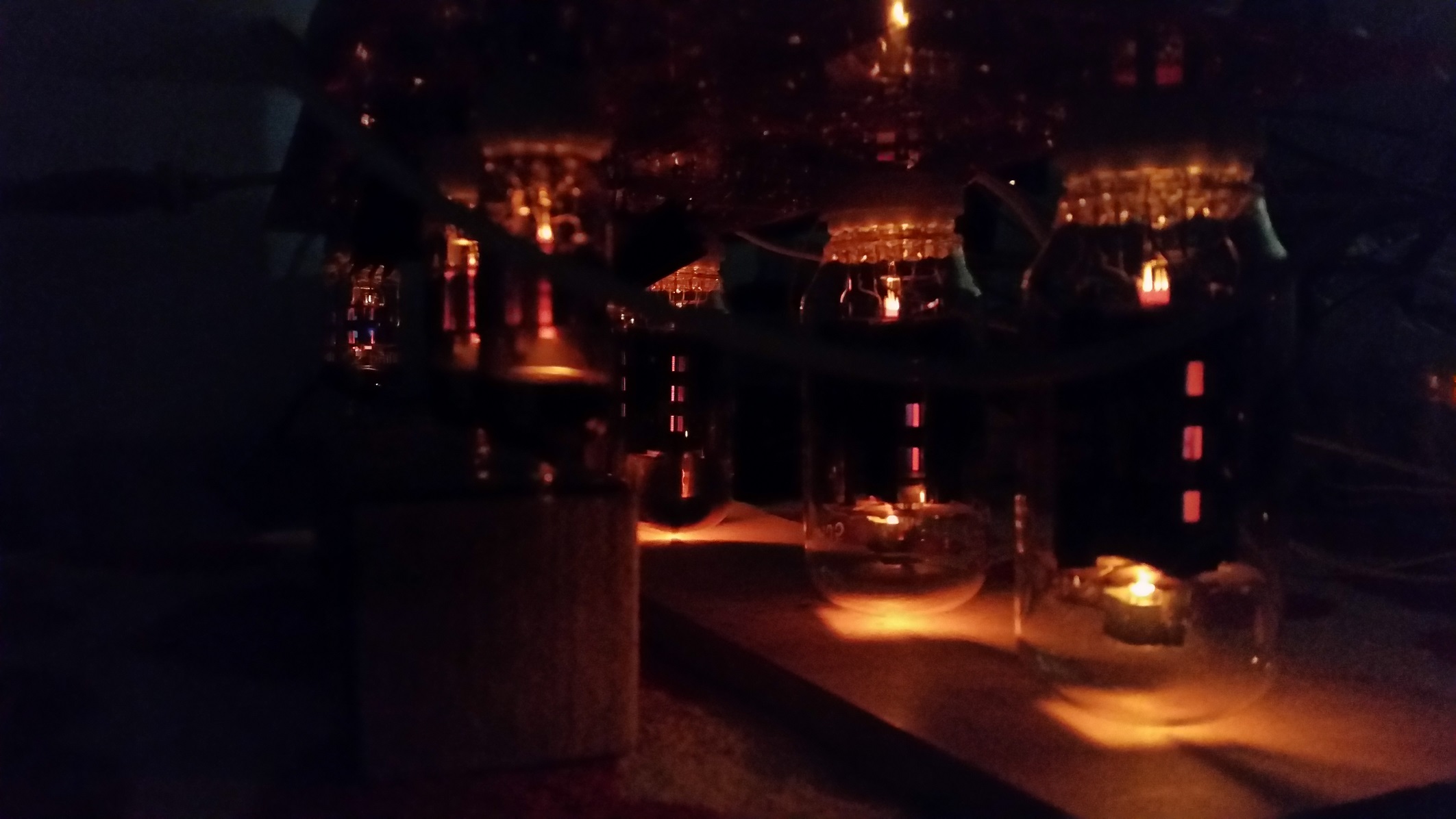

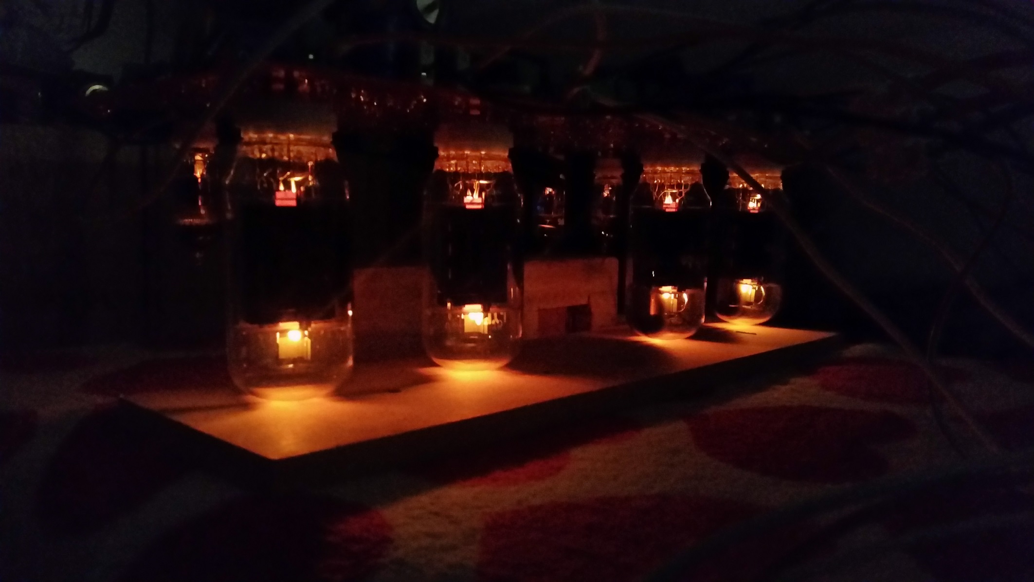

OK, friday received 6HJ5 ordered three weeks ago (must have come to Europe by boat :) )
Saturday put on all tubes, switch ON and .... good!!! No smoke
So go on balancing both channels...good ..... left it ON half an hour....check again...
Next step : music listening
OK it makes A LOT of noise, listen for an hour and sound is very good but at some point feel some hassle, like if it's too much volume (it was around 4), lower it...same sensation.
So sound is good, a lot of it, but at a certain point I don't feel comfortable.
It's not the "easy" sound I found in the other amp (TSE 300B).
