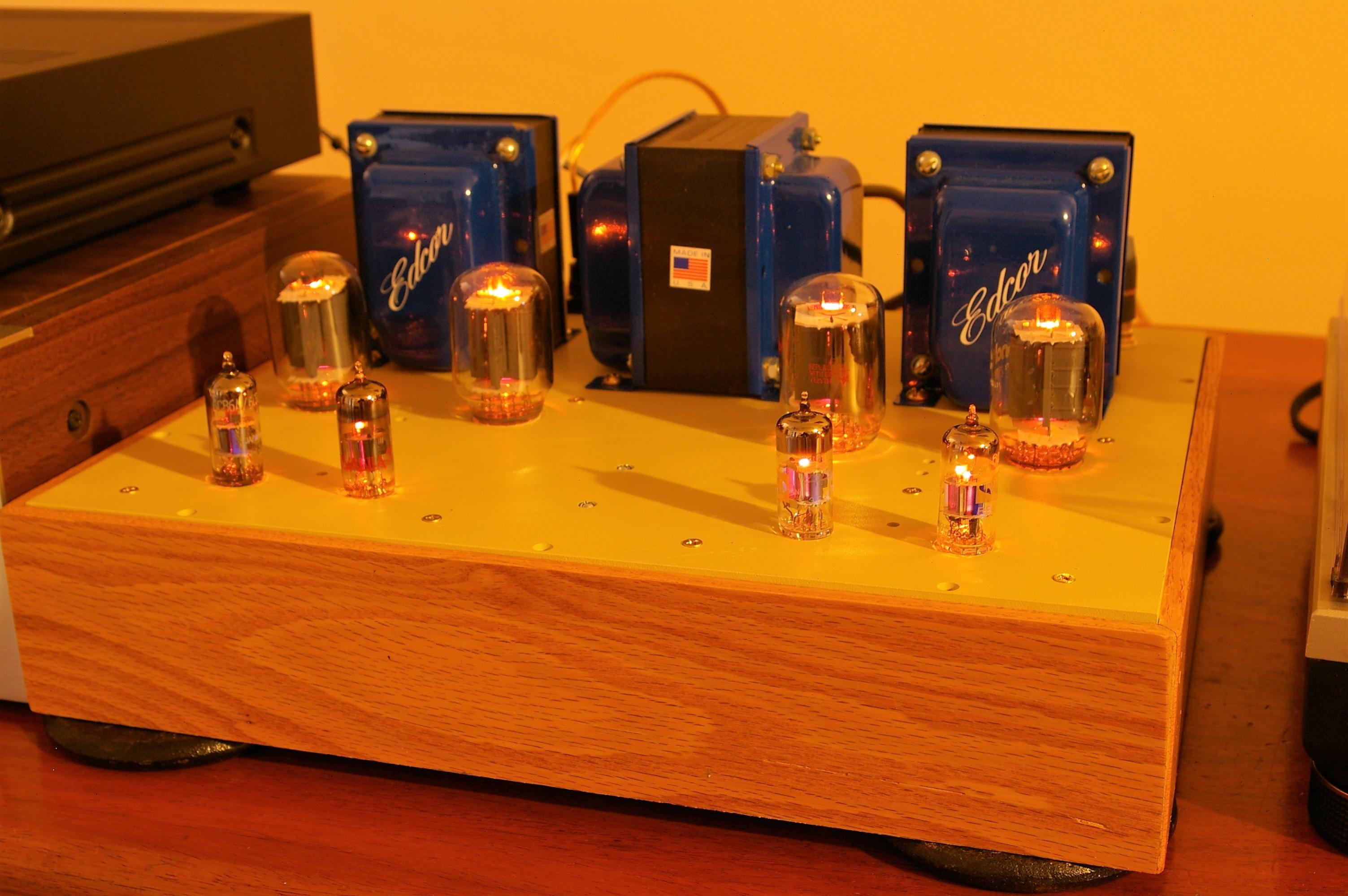

Thought I would post a picture of my stock build of the DCPP.

I've been enjoying the sound of this amp for several weeks now. I added a 100k ohm Alps volume control so I am no longer using the preamp section of my old Sanyo 75 receiver to control volume. But I am curious to try either the 6GU5 or the 6EW6 tubes in place of the 6CB6 tubes. Are both direct drop-ins? I have read through the thread and haven't seen mention of any modifications but just want to check to make sure.
Yes, although tweaking the plate load resistor value may squeeze a little more gain, if that's what you need. I never had any decent 6EW6's, so I never used them, but all 3 of my amps used 6GU5's as does Pete's monoblock version of my 125 WPC amp. They plug in place of the 6CB6 and provide a little more gain at lower distortion.
It seems to be difficult to get good 6EW6 tubes from used pulls. I ordered a bag of 35 of them, used pulls, and only 3 were decent. So I would make sure to get NOS or "tested" 6EW6 tubes. I suspect 6EW6s in radios didn't get replaced very often, so used ones are burnt to the ground. Probably just caused the weak stations to fade out.
I'm not familiar with 6BX6 or 6AM6 except just took a look at their datasheets.
6EW6 has got a nice low and sharp knee voltage around 50V versus more like 100V for those two. 6EW6 also has nice triode curves on the curve tracer, Mu 78-81. And high gm (14000). Oh, and the 6EW6 is quite happy with low g2 voltages like Sweep tubes use. It's rated for IF amplifier service, so could be microphonic. Pulls seem to be worthless though. Not very expensive tested or NOS from the big suppliers fortunately.

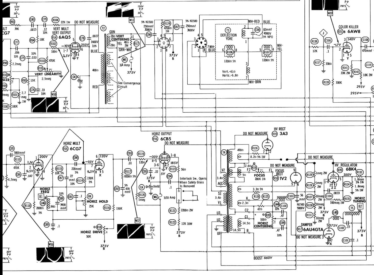

Enclosed is a chunk of a TV schematic from the late 50's showing the sweep output circuits. The vertical sweep output (6AQ5) is in the upper left. The horizontal sweep output (6CB5) and flyback transformer is lower center.
The vertical output tube is usually run in class A, and IS a linear amplifier capable of reproducing audio quite well. I made several audio amplifiers by lifting the entire vertical sweep circuit including it's OPT (T2 in the schematic) and replacing the feedback cap in the multivibrator (oscillator) circuit with an input jack. In a TV set it is responsible for sweeping the electron beam vertically on the screen. It has to be very linear in order for round things to apear round on the screen. A weak tube resulted in people with long legs and short fat heads. The drive signal is shown on the schematic. It is a linear ramp, bringing the tube from cutoff to full current to slowly sweep the beam (trace), then abruptly back to cutoff(retrace). The tube spends almost ALL of its time in conduction, and sees cutoff for a few microseconds while the beam quickly returns to it's starting place, it flies back (again the origin of the name). This is a color TV, so the vertical output tube also drives some "convergence" circuitry to ensure that the right color phosphors are being struck by the right electron beam (1 beam in a B&W TV, 3 in color).
The horizontal sweep circuit is much more complex, since it has several more jobs to do. As with the vertical output, the horizontal sweep tube sweeps the beam left and right. The tube is driven deeper into cutoff during retrace to ensure that the current in the FLYBACK (horizontal OPT) is completely cutoff resulting in a voltage spike similar to that in an automotive ignition coil. This is stepped up to a high voltage (like a car coil) and rectified by the HV rectifier (3A3) to produce 25 KV for the CRT. It also produces 1 to 2 KV for the beam focusing electrode in the CRT via the focusing rectifier (1V2). The entire flyback circuit rings at its self resonant frequency (100 to 200 KHz) and that energy is rectified by the damper tube which is in series with the B+ supply. This action bootstraps the B+ to the 6CB5 up to 660 volts (BOOST B+). Again the tube sees conduction for nearly ALL the time, retrace time is a few microseconds.
Both sweep circuits run full power all the time regardless of what's on the screen.

Tubelab_Com,
Thanks for the reminder of the way the analog TV sweeps work.
My age is showing.
You also reminded me of the waveforms, which tell the story.
I worked on a medical 'printer' that printed out a single frame of a TV image of the imaging doppler.
In order to keep the sweep current linearly increasing, the voltage had to rise very quickly at first because of the yoke inductance. There was a sense resistor in series with the ground end of the yoke, and this signal was used so negative feedback could be applied to the horizontal amp.
The printer used a 'Line' CRT, so there was so little inductance in the vertical yoke that I do not think there needed to be any sense resistor and negative feedback for the vertical amp.
