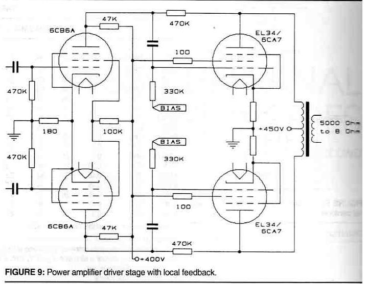

ad 2: What do the experts think of giving the 6CB6 a bigger Plate resistor, as in this Schade design that has B+ of 450 volt. I realize that there is a connection with the feedbackresistor, I will see what happens.
In a typical pentode amp increasing the plate load resistor within reason increases the gain. In this design there are 3 different forces at work here. Increasing the plate resistor increases the gain, but also increases the Schade feedback, and lowers the plate voltage. In my first version of this board the plate supply was 450 volts and I increased the plate resistor to 39K to get a bit more gain. The Schade resistors are still 220K but are partially fried. The 39K value was found by increasing the value until the distortion went up at full power. I was attempting to crank 250 WPC out of the board and was being limited by drive voltage.
I think that the plate resistor and the Schade resistors would need to be tweaked for each individual situation but the original values are a good place to start.

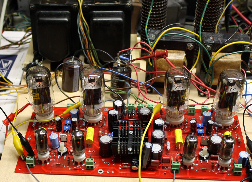

I now have the board running with 280 volts of B+ and 550 volts on the output tubes. It still seems to work quite well with all of the old resistor values but I am running very sensitive output tubes (E130L's) and 6GU5's for input. They have been to 120 watts without incident, but one channel is dead. Investigation underway.
OK, I now have both channels operating, but still using an external power supply for the plate voltage so I can turn it up slowly. The dead channel was caused by improper wiring of the output tube sockets. I have octal sockets sky wired into my board right now.
I have uscovered a new annoyance. When either channel is driven I can hit 120 watts. When both channels are driven, I get big time distortion at 50 WPC. I traced this to the screen supply collapsing under load. The 4.7K resistor is dropping too much voltage under full power so I temporarrily jumped it. I saw both channels hit 100+ watts before the old Fluke power supply went into convulsions.
Time to wire in the second power transformer!
IT'S ALIVE!
I wired in the second power transformer, attached a current meter to every tube, and a voltmeter on the B+. There is a 470 uF 450 V electrolytic across each supply. I wired the OPT's for 6600 ohms.
I hid under the bench and hit the switch. There was no boom. B+ with no load is 623 volts. I set each tube for 35mA idle current and slowly pushed the throttles forward. No explosion. With both channels operating clipping occurs at about 85 WPC. I pulled back to 75 WPC and let it run after about 10 minutes. The heat sink was warm, the transformers were cold and the tubes were toasty but no rednesss was seen. B+ at this power level is 588 volts.

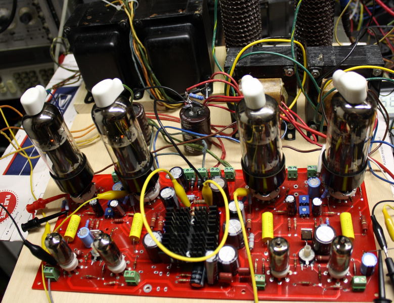

I removed the octal sockets, replaced a few toasted resistors rewired the board for 6HJ5's and tried again.
IT"S ALIVE AGAIN!
The power output and distortion is about the same as it was with the E130L's but the total B+ voltage is 595 indicating lower total current drain. The screen current is much lower since the heat sink is now stone cold even after 20 minutes at 75 WPC.

Were you able to determine the failure mode of the E130L?
The E130L datasheet seems to indicate low screen current for typical operation (at 300V B+), but then the plate curve sets show the screen current on the same scale as the plate current. Most data sheets I've seen have a 4 to 10 times lower scale for the screen current vis-a-vis the plate current. With both grids being frame construction, I wonder if they are aligned in the E130L since the plate curves seem fairly square knee'd.
Also, out of curiousity, wondering how wide the cathode is in the E130L compared to the 6HJ5 or a 6CB5 (similar). Any cooling fins on the top of the grids in the E130L? The fine wires of a frame grid may be more sensitive to meltdown.
