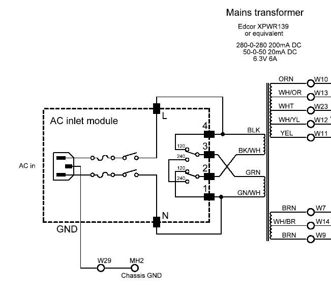

Very basic question here for a bone stock build. I'm using the socket from the BOM but could use some incite getting things wired up.
Could someone take a moment to tell me which wire (green, black, G/W, B/W) is soldered to each of the lettered points? TIA!
I have not used this exact inlet and hopefully somebody who has can tell us, but looking at the datasheet I think it actually matches the schematic:
I believe "A B C D" corresponds to "1 2 3 4" on the datasheet and the schematic. Are there numbers next to the terminals?
Pete
Yes. Your diagram appears to match the part, just "L" and "N" are reversed, which doesn't matter.
jeff
As Pete warned in his website notes for the DCPP, the switch/power module can be confusing. To be sure, I would suggest taking a few minutes with a DMM and check all the terminals for continuity and make/break. As a matter of fact, the module I used although having the same part# as on the BOM, had a different arrangement of the terminals. Also, a wiring diagram provided with the package, was for some other model, and was wrong for mine.
Ugh. Maybe next time I'll fork over the extra $5 for a Schurter
Thanks for the good info Pete, got it all wired up. I want to verify I have the fuse wired correctly and then I can fire it up.
Note that I have terminal 1 wired to B and terminal 4 wired to D. If anyone who used the same socket can give me a quick verification, that would be great. Sorry that I'm being so cautious, but I don't want anything to burn up because of something easily remedied
It looks like everything is in its place.
