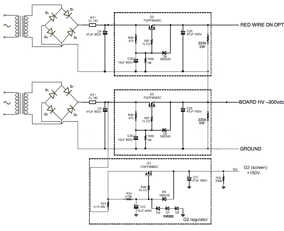

Well I have been trying to figure out the dual 10lber power supply(I will be honest I am more of a builder than designer...can ya' tell). Not sure if this is sort of what you had in mind George for the screen and B+ supply?
Sort of. I have figured it all out in my head, but haven't tried it yet. This is my current "big idea".
Pete designed the board to run from a supply of about 340 volts. Each half of your supply should develop about 320 volts based on some experiments with the $15 transformers. It would seem that the unmodified board should be able to run from the bottom half of the supply. In fact I think that the on board power supply can be used by adding two diodes and maybe a big fat off board cap. I plan to test this in the near future.
The second transformer is wired to a second bridge and CLC filter just as you have drawn and ONLY feeds the red wires on the two OPT's (Edcor may use a different color). That is the only place where 600+ volts is needed. This arangement keeps the big voltages off the board and should prevent the exploding capacitor issues that I witnessed. In fact 450 volt caps should be OK for the PC board.
The only components that will need upgrading on the PC board are the Schade feedback resistors since they will see twice the total B+ voltage under signal peaks. I realized that the poor resistors on my board have been subjected to over 1300 volts on peaks and they are still alive, but others may not be so lucky. 1500 volt rated resistors aren't on the shelf at Walmart so 2 or 3 two watt resistors could be wired in series.

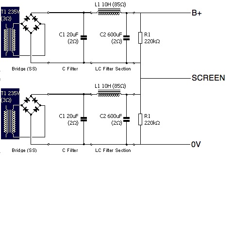

I like the sound of being able to use 450v caps. They are easy to find and Digikey seems to have stopped selling the 500v panasonics they used to stock. I just found some Nippon Chemicon KXG 450v caps for $1 a piece.
I have been attempting to determine the choke current ratings but I am unsure of my math. Any idea what the minimum current rating I could get away with for the power supply chokes I have shown? I have found some military surplus chokes that are reasonable, certainly not as cheap as the triad chokes.
Using the schematic as shown both chokes must pass the full current drawn by the output tubes. This could be 500 mA or more on peaks. The top choke must be insulated for 650 volts or more. The cheap Triads might catch fire in this application. With the 600 MEGA FARAD caps we might not need any chokes if we can figure out how to keep the diodes from exploding. I think inrush limiters on both sides of the transformer will be needed here.

Alright I got to thinking some more and realized I had enough parts to build a second power supply just as it is seen on the schematic. So both supplies are wired in series. Anyone see anything wrong with the proposed schematic? I too purchased a bag of those nichicons. I think I am now set for life.
