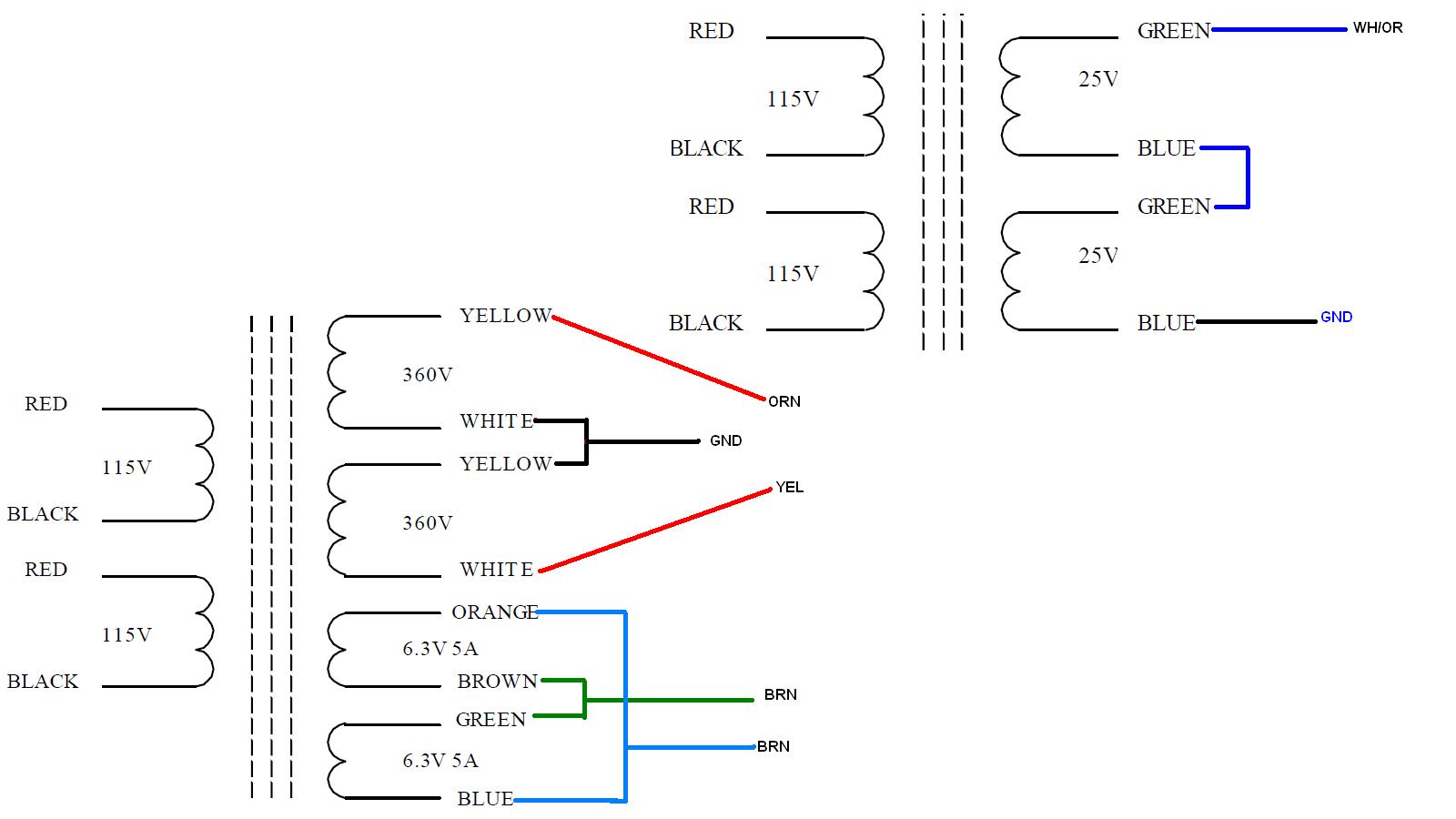

I have been working to finish this amp and I had a question about my transformer wiring. Since I am opting to use other iron my wiring is a bit different. The two transformers I am currently planning to use are the Antek an-4t360(HV and Heaters) and an-0225(bias supply)
1. First major difference is the transformer I currently have lacks a center tap on the 6.3v winding. Will this cause any issue if I just float it or should I look to find a transformer with a center tapped heater winding?
2. I have a smaller bias tap transformer that will be used with this. I was planning to wire the two windings in series and hook one end up to one of the diodes on the bias tap and run a half wave rectifier. The other end connected to ground. Sound correct?
3. Have I got the wiring of the high voltage windings correct? I have a feeling in my diagram I should have tied the white wires together and put those to ground and have the yellow wires go to "ORN" and "YEL" on the board. Or tie the yellows together to ground and the whites to "ORN" and "YEL"?
4.Now that I look at the diagram again It looks like I even drew up my heater wiring wrong. Should it have been Tie Orange and Green together and Blue and Brown together so that they are in parallel?
Please see the attached photo to see my proposed wiring....I just wanted to make sure I have all my "I"s dotted and "T"s crossed before I end up firing this up.

B+ is wired correctly in the diagram. You took 2 360vac units and made one 720ct unit which is correct. Dont second guess yourself 🙂
ya fix your heater wiring the way you described (parallel). Jumper wh/br(ct) to brn. That will raise the heaters to the right level (your hooking 1 leg of the heaters to a voltage divider to keep the B+ from arching to the heater).
Your bias is wired correctly at the transformer(series), but you will have to make and off board full bridge rectifier (standard 4 diode like most electronics) and then jumper it in at R7 and ground.
Also make sure you check your bias voltages before you hook them to the board. Remember you want negative bias. you hook it up backwards and you will have +60v bias and some exploding bias caps. I guess you could say positive to ground and negative to the R7.
If you want to make it idiot proof, jumper the full bridge in at wh/or or wh/yl (or both if your want) and ground. Then when you fire it up, worse case scenario is zero bias (diodes will do their job of blocking the wrong polarity) instead of blowing up your bias supply caps.

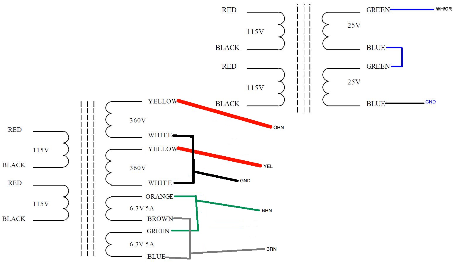

Here is an updated diagram....which I think is now correct?
The high voltage supply now should be 360-0-360
Here is where I got the bias wiring from. I don't think I will need a fwb rectifier circuit

That doesn't work, since the B+ CT is grounded. But no problem using a single 50V bias tap as opposed to the two on the Edcor. Just connect the single 50V tap to one of the two diodes, and leave the other unconnected. It makes a half wave rectifier, but it works fine - I was running a Hammond 300-series transformer that way before I got the custom Edcor.

Nic, I think the B+ windings are now incorrect, but they are correct in the first diagram. One way to check is connect the inner white and yellow wires together (the centertap), and put a multimeter on the outside white and yellow wires, and you should measure 720V AC. But first check your multimeter can safely measure 720V AC. If you have the windings wired incorrectly, you will measure around 0V AC. On the only Antek tranny I have, wired like this with a centertap, I had to connect a white wire from one winding and a yellow wire from the other winding to ground (centertap).
Alright...I thought I was originally correct but I wasn't 100% sure. It is easy to confuse yourself by over analyzing.Nic, I think the B+ windings are now incorrect, but they are correct in the first diagram. One way to check is connect the inner white and yellow wires together (the centertap), and put a multimeter on the outside white and yellow wires, and you should measure 720V AC. But first check your multimeter can safely measure 720V AC. If you have the windings wired incorrectly, you will measure around 0V AC. On the only Antek tranny I have, wired like this with a centertap, I had to connect a white wire from one winding and a yellow wire from the other winding to ground (centertap).

Look i made a real simple diagram were you just have to air wire 2 diodes across the power input spot. So its just popping in 2 diodes from WH/OR and WH/YL to WHT
