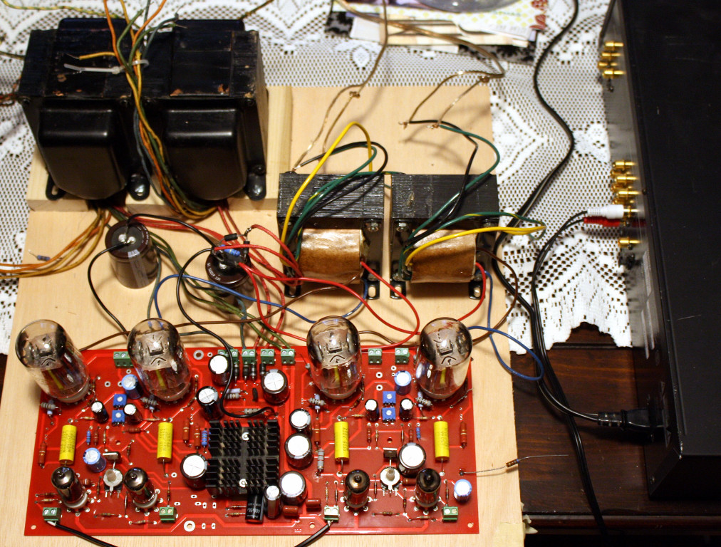

The ugly (and highly unsafe) breadboard has been sitting in the middle of the living room coffee table and has seen a lot of play time, some of which has been quite loud. There have been no issues, it just rocks.
I have decided to name the ugly breadboard the Flamethrower 250 since it makes about 250 watts when fully cranked. I think that I am going to leave this one exactly as is. I will build another Flamethrower 250 in a pretty box and this one will then be available for further experimentation. I think I have all the parts for the build except for a few resistors. Of course the build will be documented and posted here. I think the only change I will make is to parallel the heater windings from the two power trasnformers to even up the load. I see no issues but there is another thread here about another amp using these transformers and the user is having issues with hum and heat. Mine are slightly warm and completely cold after hours of use.

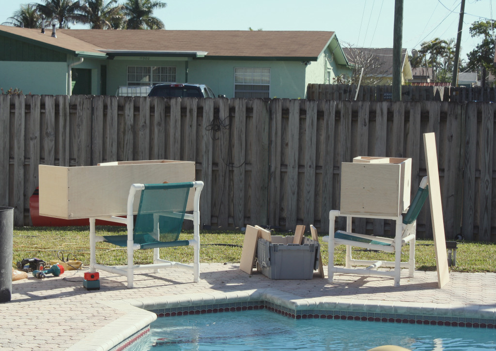

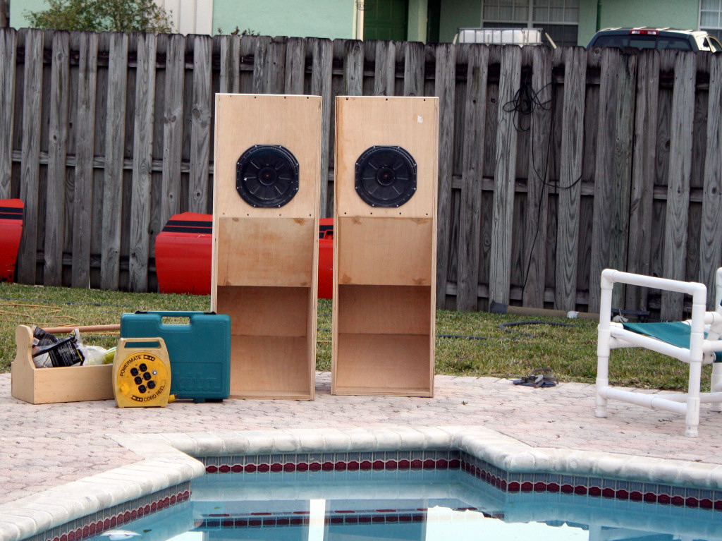

Today was one of those "tourist days". The kind of day that tourists pay big bucks for. 65 degrees, clear skies, and a gentle breeze. We haven't had very many this year. I decided that the tubes would remain dark and cold today....it's finally time to work on my speakers. If tomorrow is like today they will be done. Photo of the Back Yard Speaker Lab.

The Back Yard Speaker Lab closed at 6 PM last night. I made it to 8 PM before the EZ10's were connected to the Flamethrower 250. Several EZ10 builders stated that the Audio Nirvana drivers would need at least 100 hours of break in time before they sounded good. There is no damping material in the cabinets yet either. Of course I had to see how they worked, and the Flamethrower was already connected, so they met.

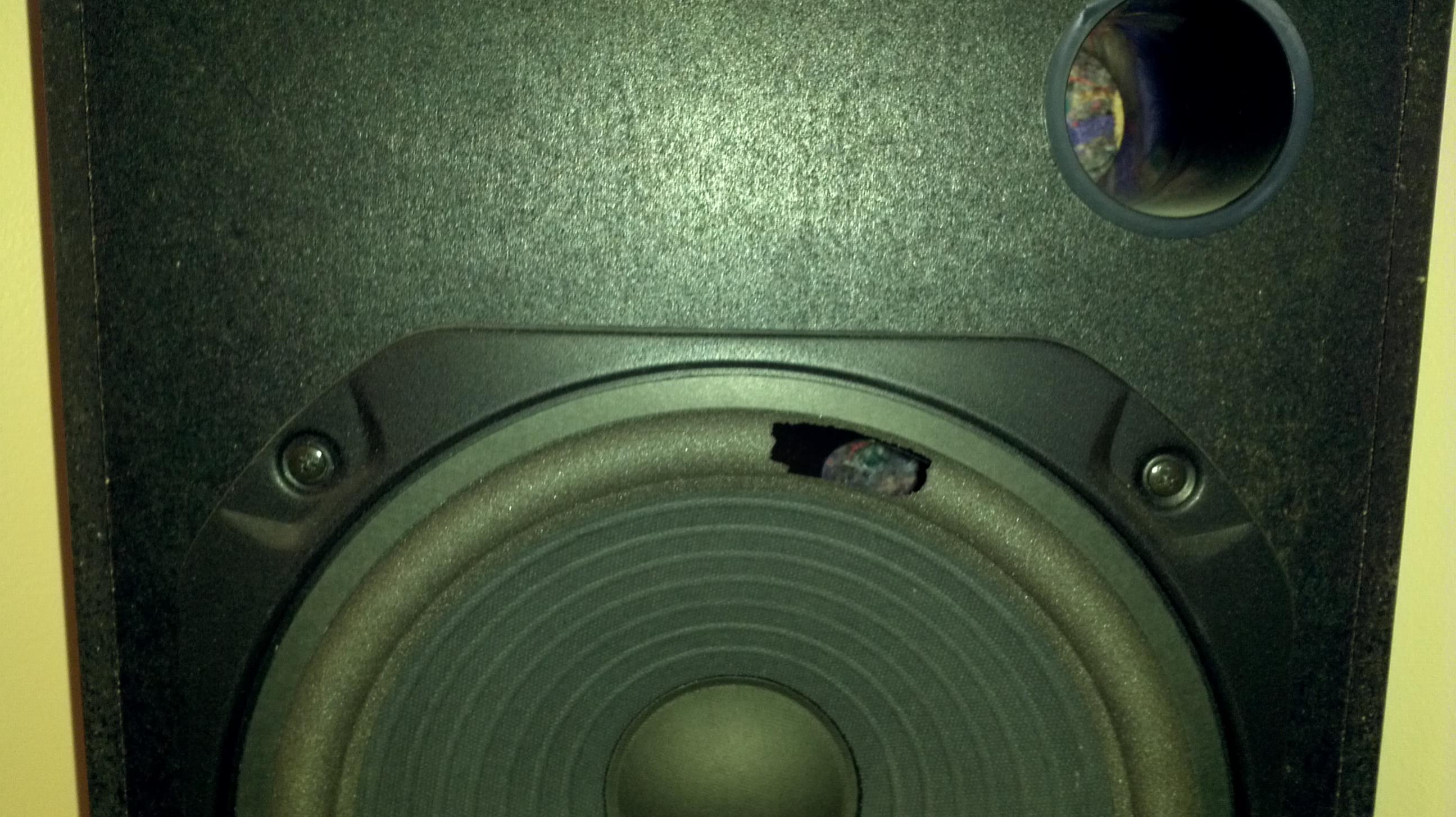

Getting way off topic here, but I can't resist. The cats were away yesterday, so I decided to see if I could get my Boston Acoustic A60s to break in a bit. I refoamed them a year or two ago and it really killed the bass. The new foam is pretty stiff. I use them in my shop and I miss the punch they used to have. Anyway, I slapped them in parallel with the speakers that were already hooked to the ST70 and dimed it for a couple of hours with some Armin van Buuren. That was loud.
After a while, I noticed that the speakers normally hooked up to the ST70 were sounding a bit flabby. They are a pair of old Realistic Nova-18s that I bought back when I worked at the Shack (circa '94, I suppose). I bought them to replace my older MC-2001s, which I also still have out in the garage. The Novas are not the best speakers, but after a few mods they sound pretty good for what they are. I use them as a sort of "rear" channel for our long, narrow basement.
Anyway, when I popped the grill off, some bits fell on the floor. 🙂
