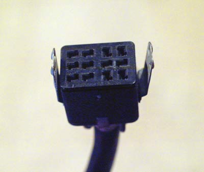

Ah! Cinch Jones! Thank you! I've been racking my brain trying to remember what those were called. This other amp I have has a 10-way on it and it is quite nice.

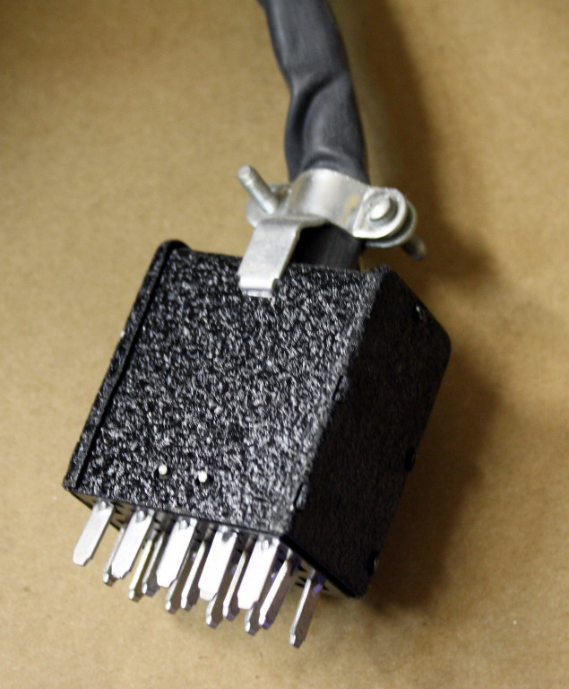

I got a hand full of NOS ones at a hamfest. The ones that were made for the end of a cable have a metal shell. I used an 15 pin version on the 845SE, with a chassis mount female on the power supply chassis and a male on the end of the umbilical cable. I didn't know the ratings so I put the HV wire in one corner and didn't use adjacent pins. There is a wire carying 450 volts DC for the Tubelab SE board and + / -300 VDC for the PowerDrive board. All heaters are DC and each supplies have individual returns. Each supply is individually floating and are tied together only at the star point in the amp chassis. This amp is about 6 years old and has been reliable but doesn't see much use due to the heat that it puts out. Picture of the connector on the end of the cable.

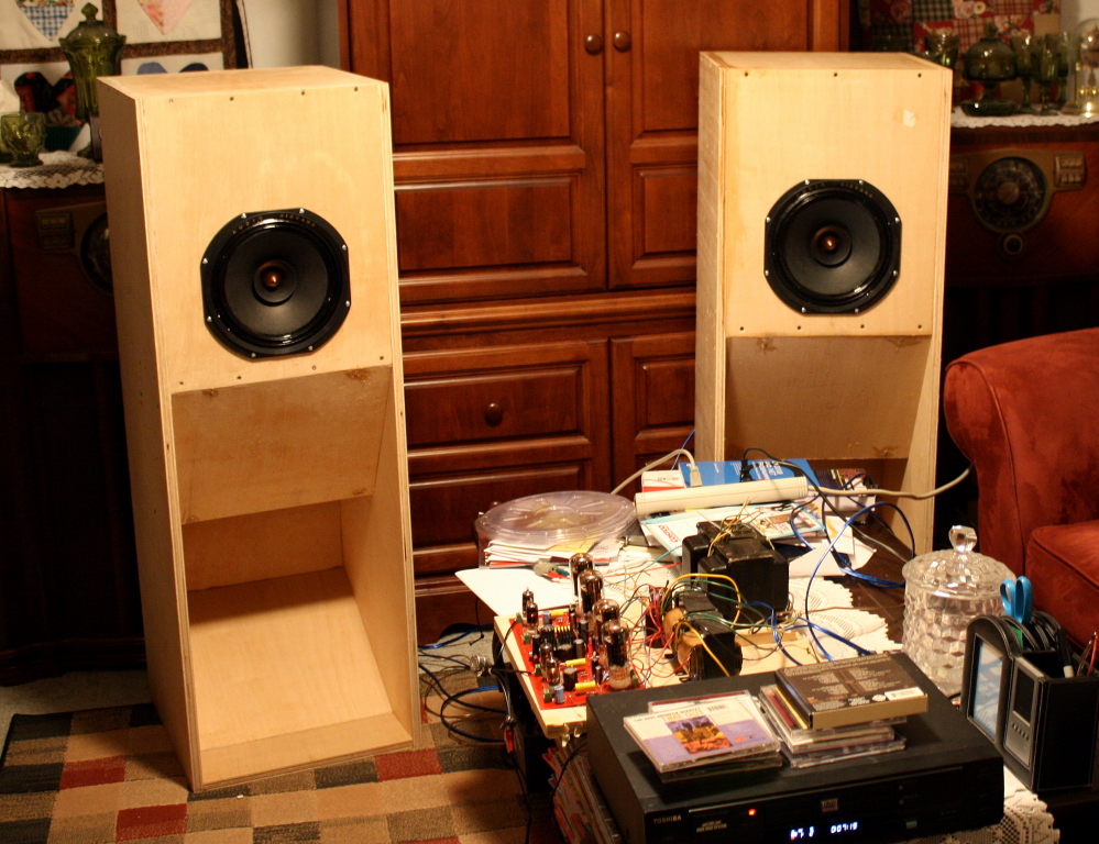

Line voltage is 120.9 volts. I know its winter but the AC is on. Temp has been in the mid 80's for the last few days. B+ is 620 at turn on before tubes heat up. After 5 minute warm up B+ is 605 volts at idle. Put on Elton John "Love Song" and set the volume rather loud. B+ went down to 603 volts. Elton is a wuss, go I cranked some Mark Knopfler as loud as I dared push the new efficient speakers. It was LOUD. B+ went down to 595 volts. Return to idle B+ is again 605 volts. Bias currents are 32.2 mA, 29.7 ma, 31.8 mA. and 29.8 mA. Don't remember exactly where I set them but the OPT's that I am using (cheap guitar amp OPT's that sound good) like a little imbalance, so the imbaance is intentional (set with a distortion analyzer). 2nd picture is amp and speakers from last weekends Back Yard Speaker Lab.
Please ignore the clutter on the table and the exposed lethal voltages. I am the only one in the house right now. Amp, speakers, and mess will all be removed and safely hidden before Sherri comes home.
3rd picture is next set under construction in this weekends Back Yard Speaker Lab. They are much smaller and will never see this amp. Two nice weekends in a row. Lets hope for a 3rd. Next weekend is the Orlando Hamfest (200 miles north of here). Last year it was 40 degrees and raining on Friday, 25 degrees and very windy on Saturday.
