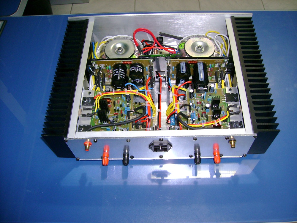

Pehlse from Brazil assembled the Dx Blame ST
These green boards where offered, several monthes ago, inside a brazilian forum..they are no more available.

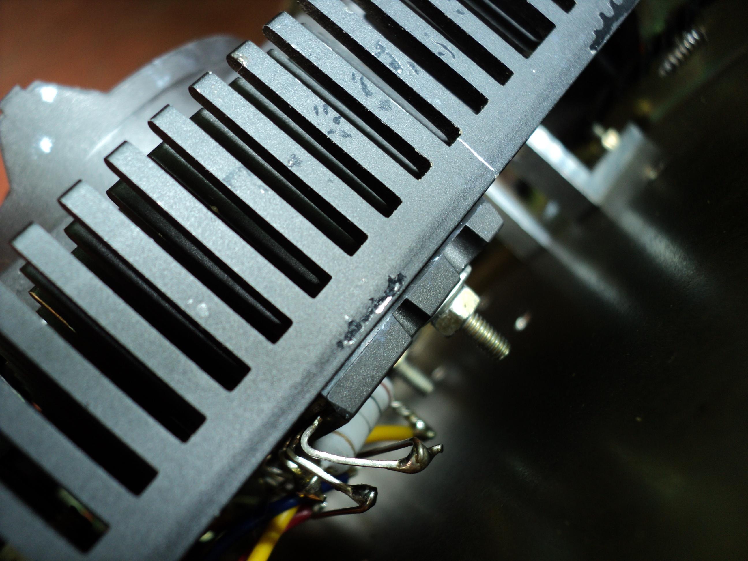

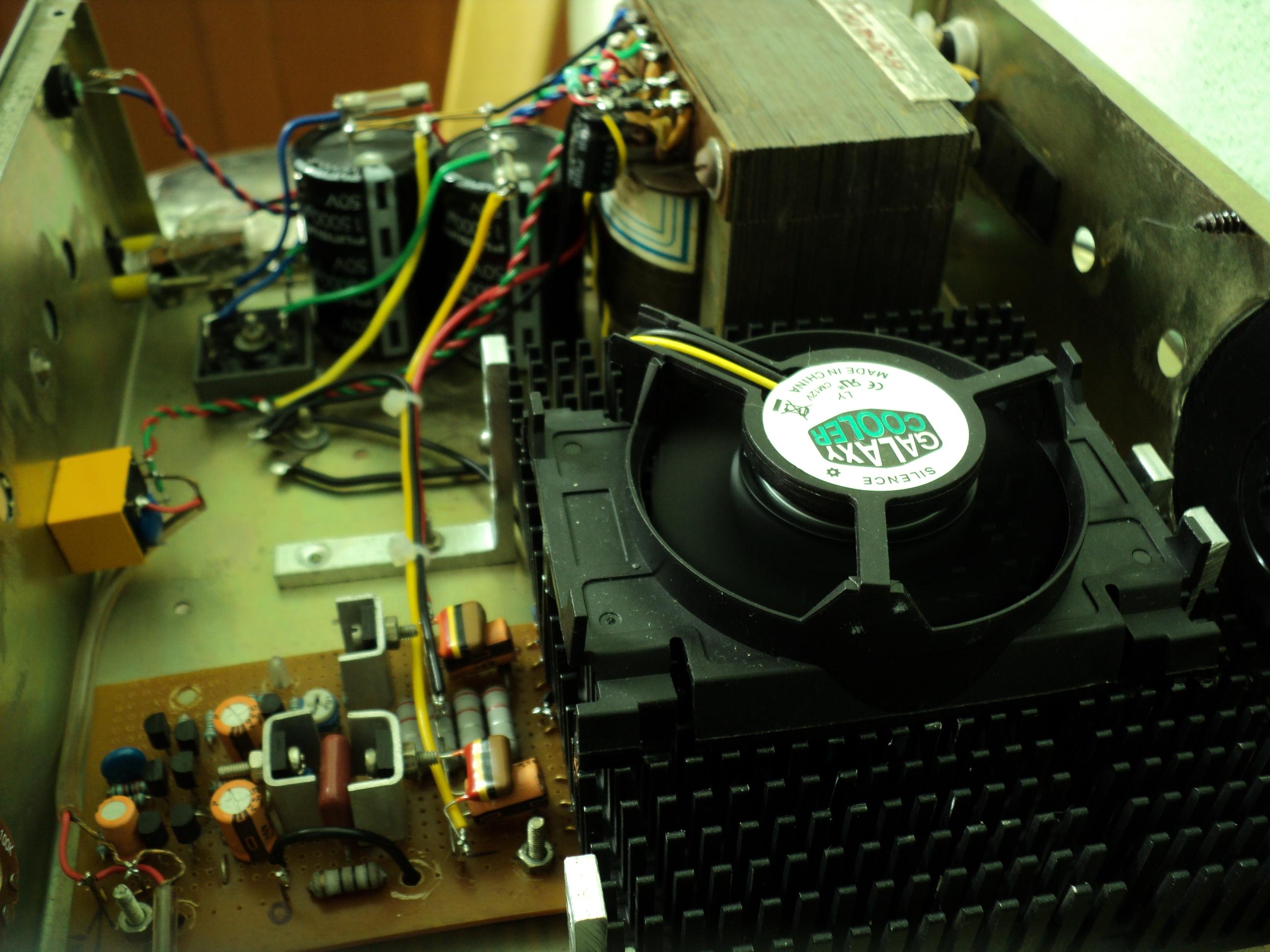

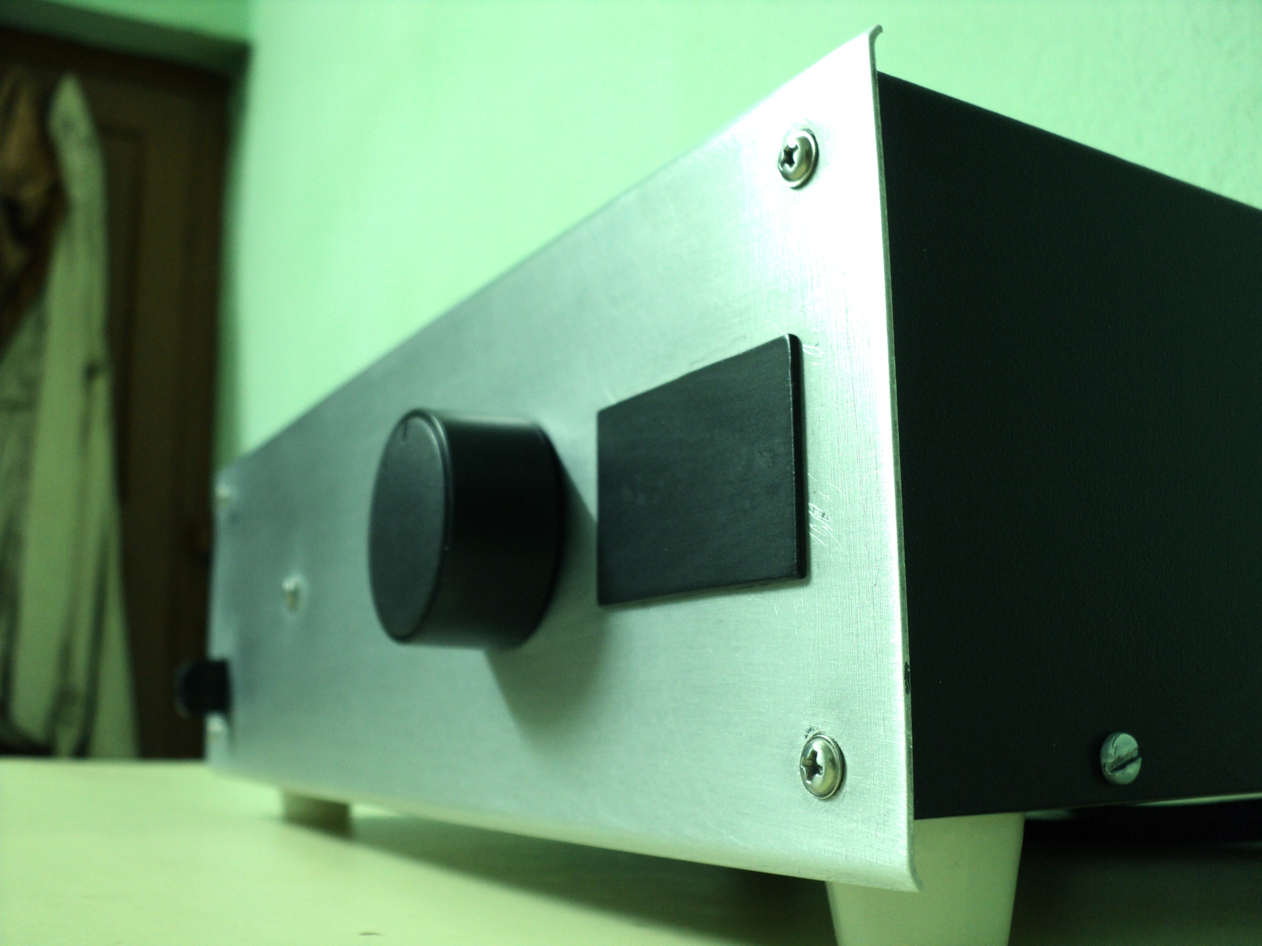

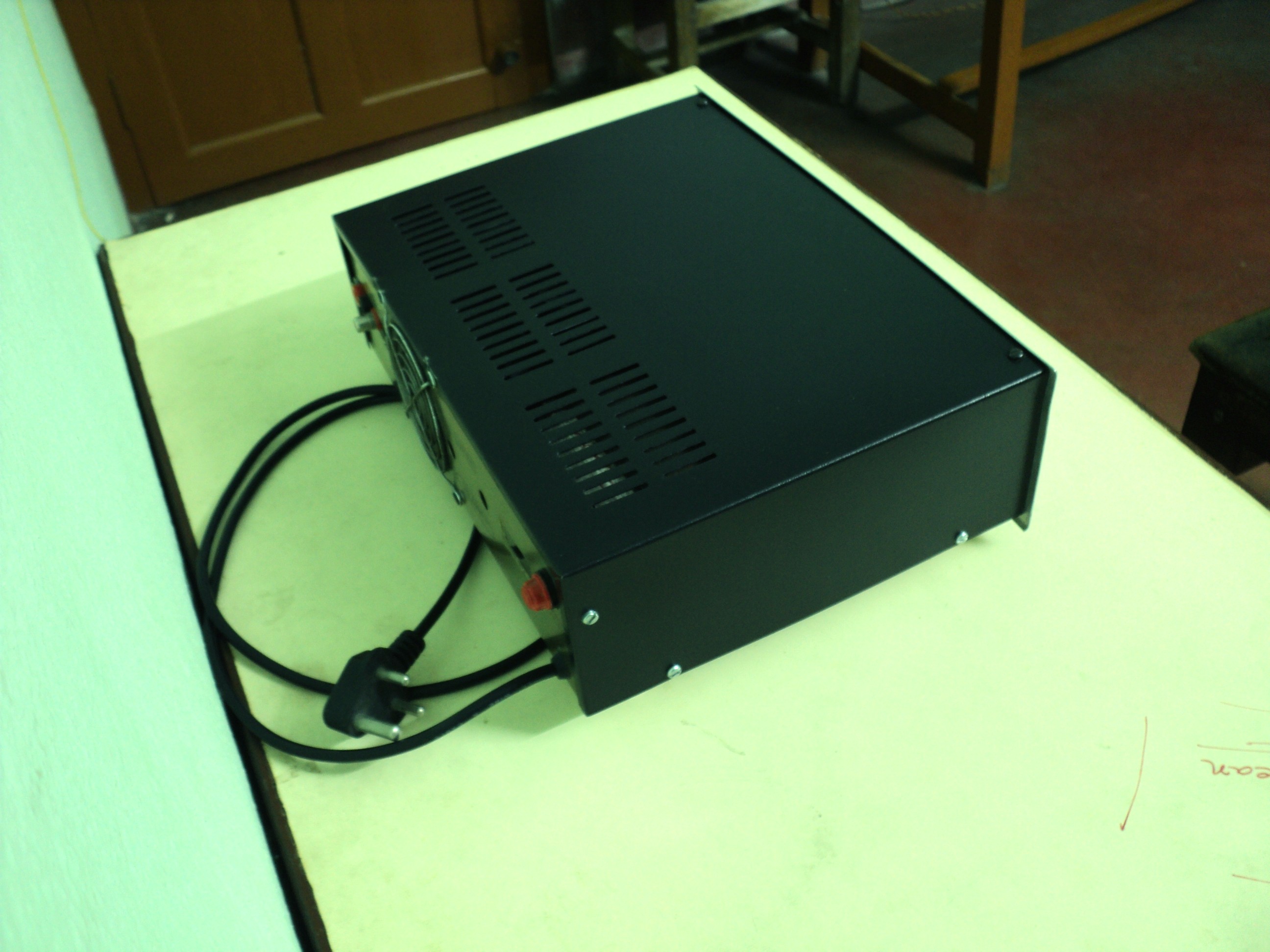

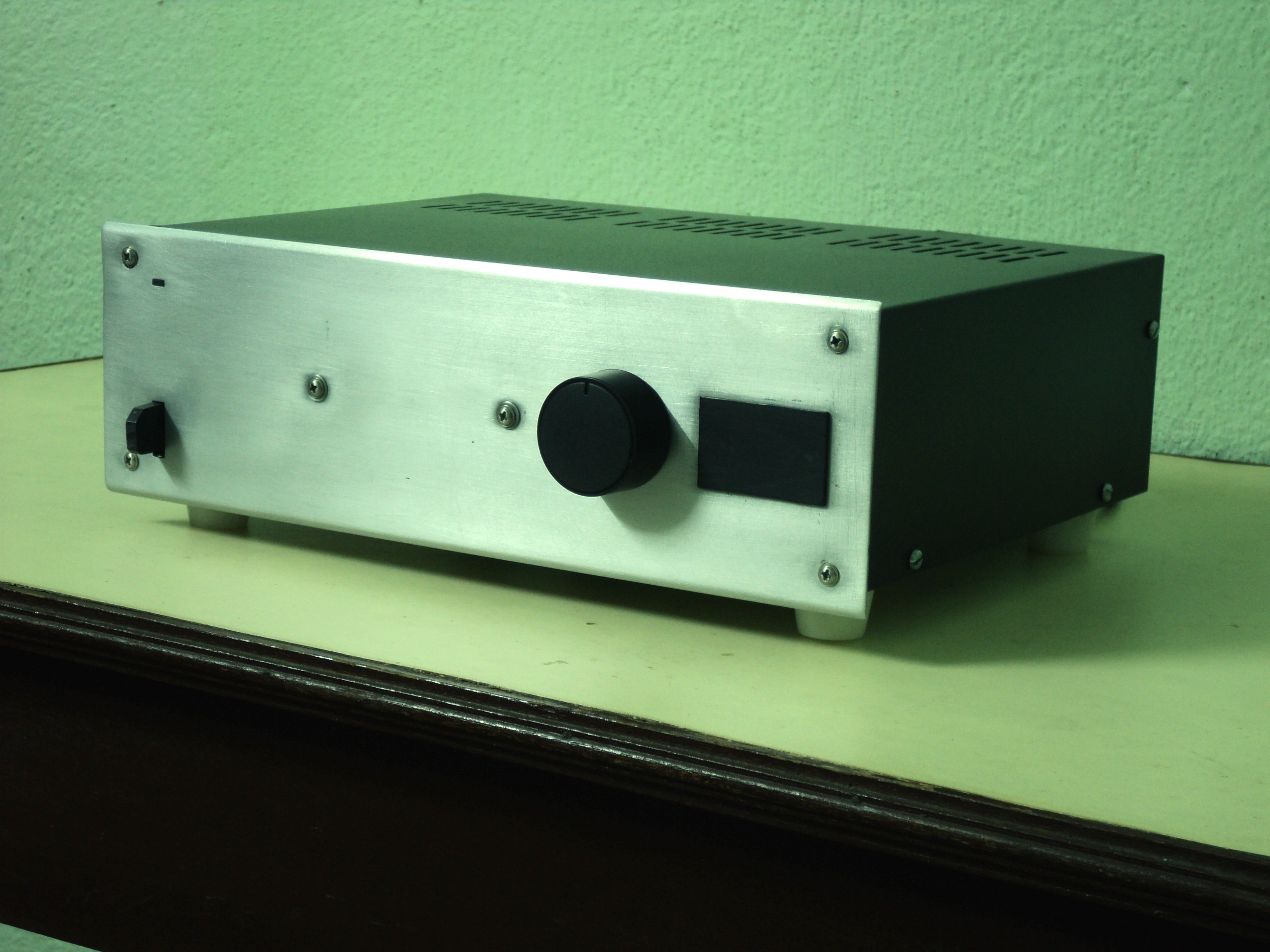

Not upto the level of the more pro looking jobs shown here, but this is my newborn mono subwoofer amp using four 2SC5200s in Q-complimentary on two AMD heatsinks with minimal and fixed airflow; although it looked like the fan is unnecessary even under heavy loading - thanks to 504 radiating fins.

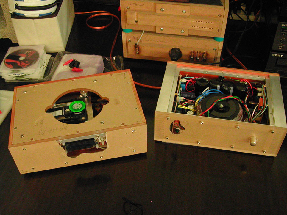

Here attached is one of my latest built amp. It's built based on wimdehaan pencil tube hybrid amp. One of the photos shows the direct heated 5676 triode pencil tube. Since I could not get BUZ in my area I simply substituted them with IRF540/IRF9540 with a slightly modification on the original schematic. As the Vgs is higher with IRF hexfets, i increased the bias network resistor to give a +/-4V around the gates.
The size of this amp is roughly an A4 size, which fit perfectly in my small listening room. Don't bother with the protective film, i've already peeled it off.
Here you can notice the CD-rom player which is coupled with this amp.
Right now I'm working on a SE mosfet amp, the highly recommended power follower circuit (thanks Andrea) placed after a tube mu-stage, to give enough gain. Hope to finish it within a couple of months.

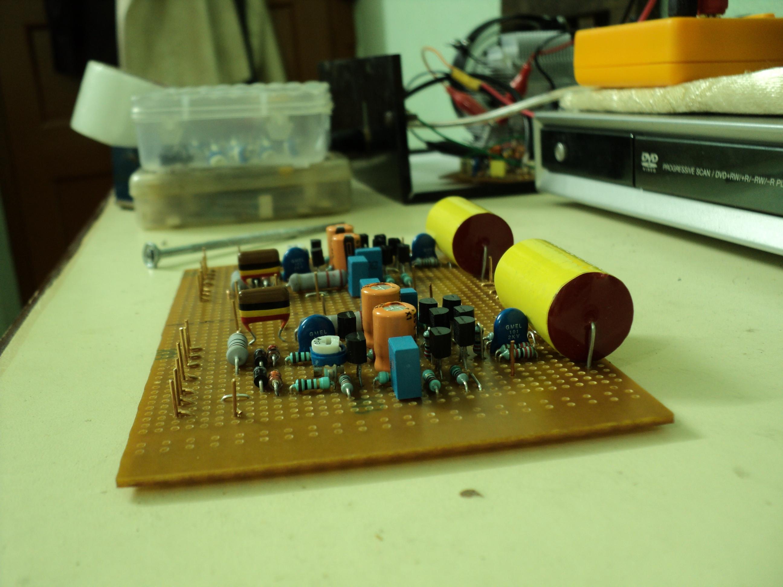

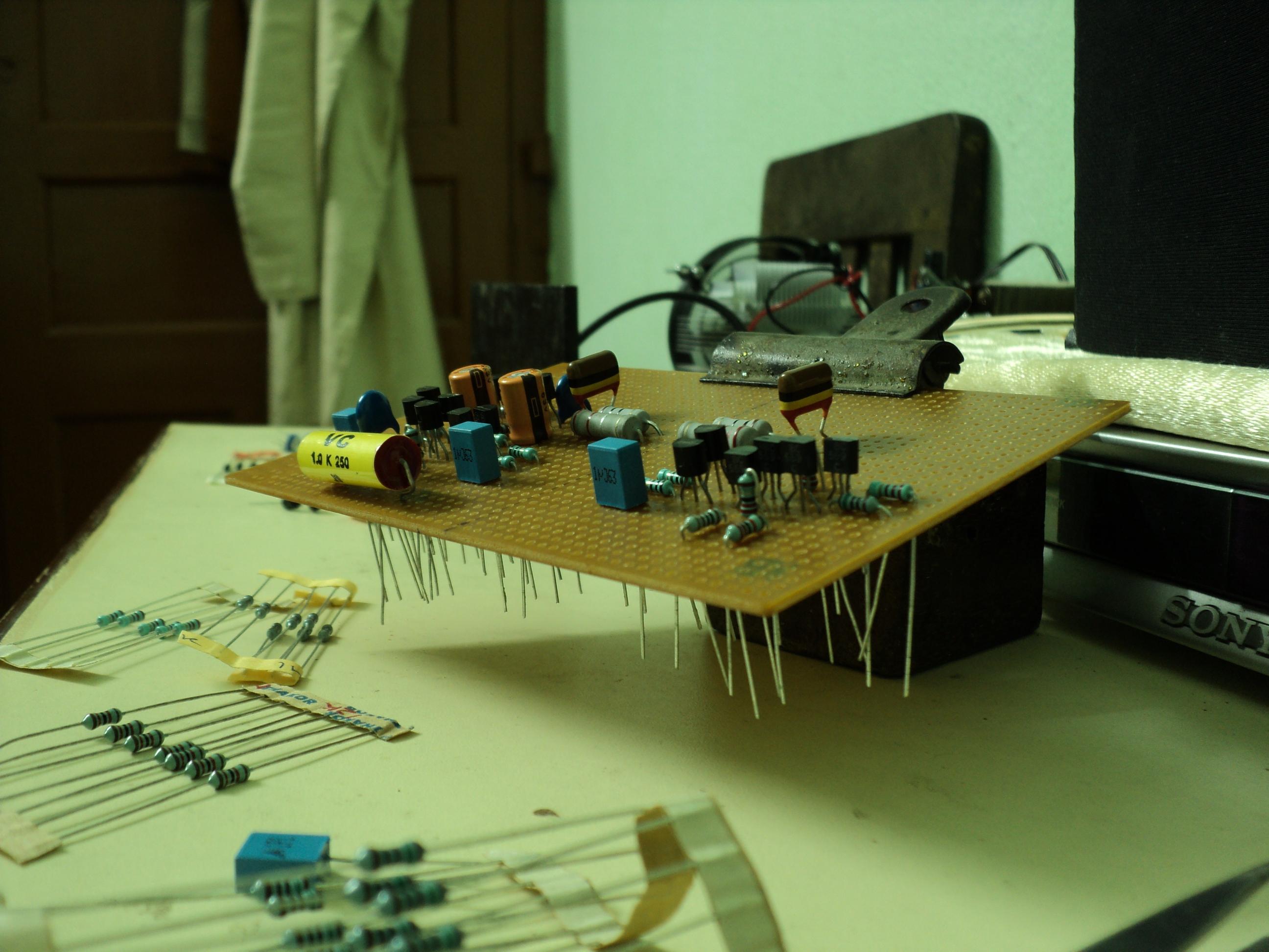

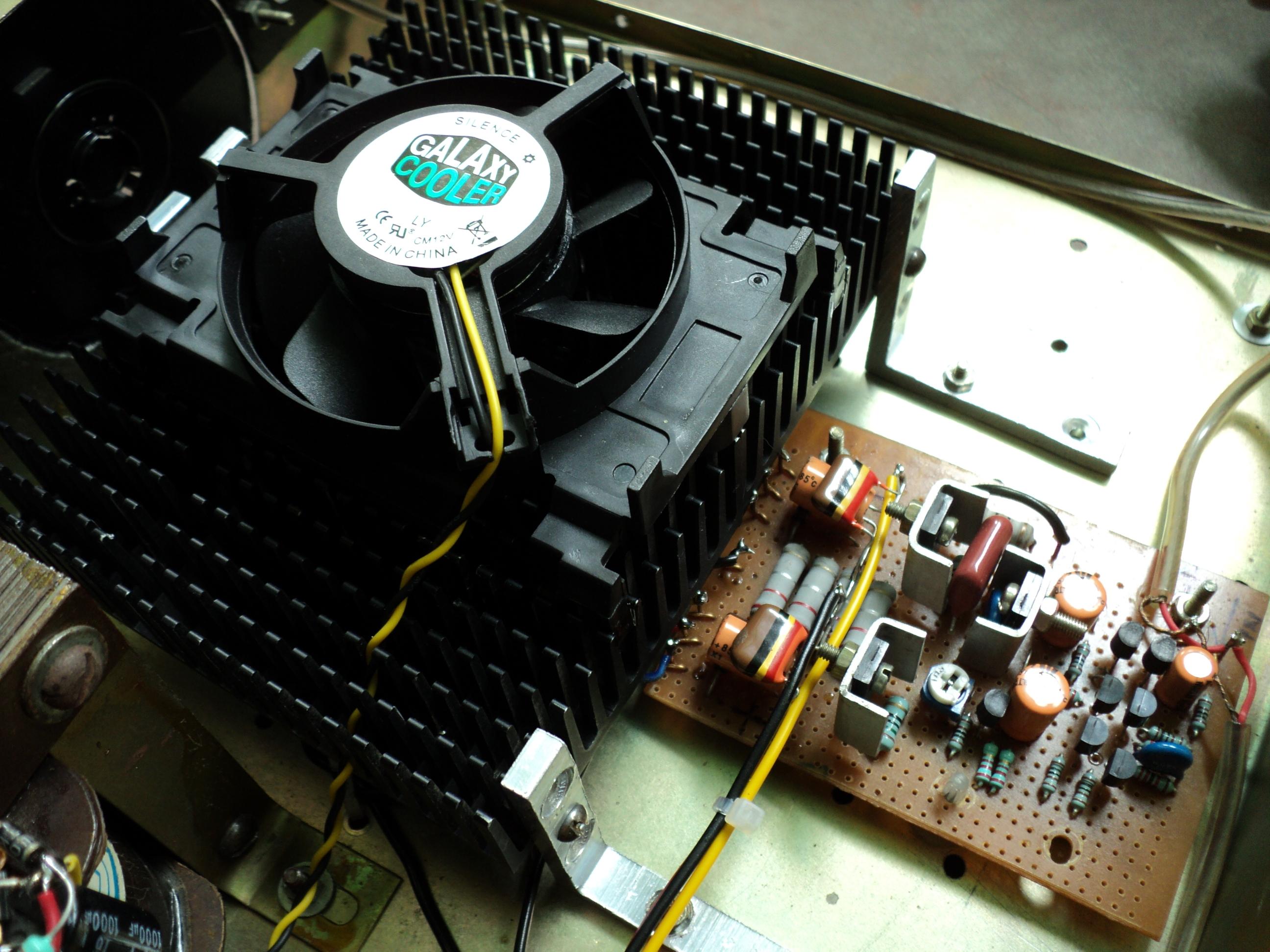

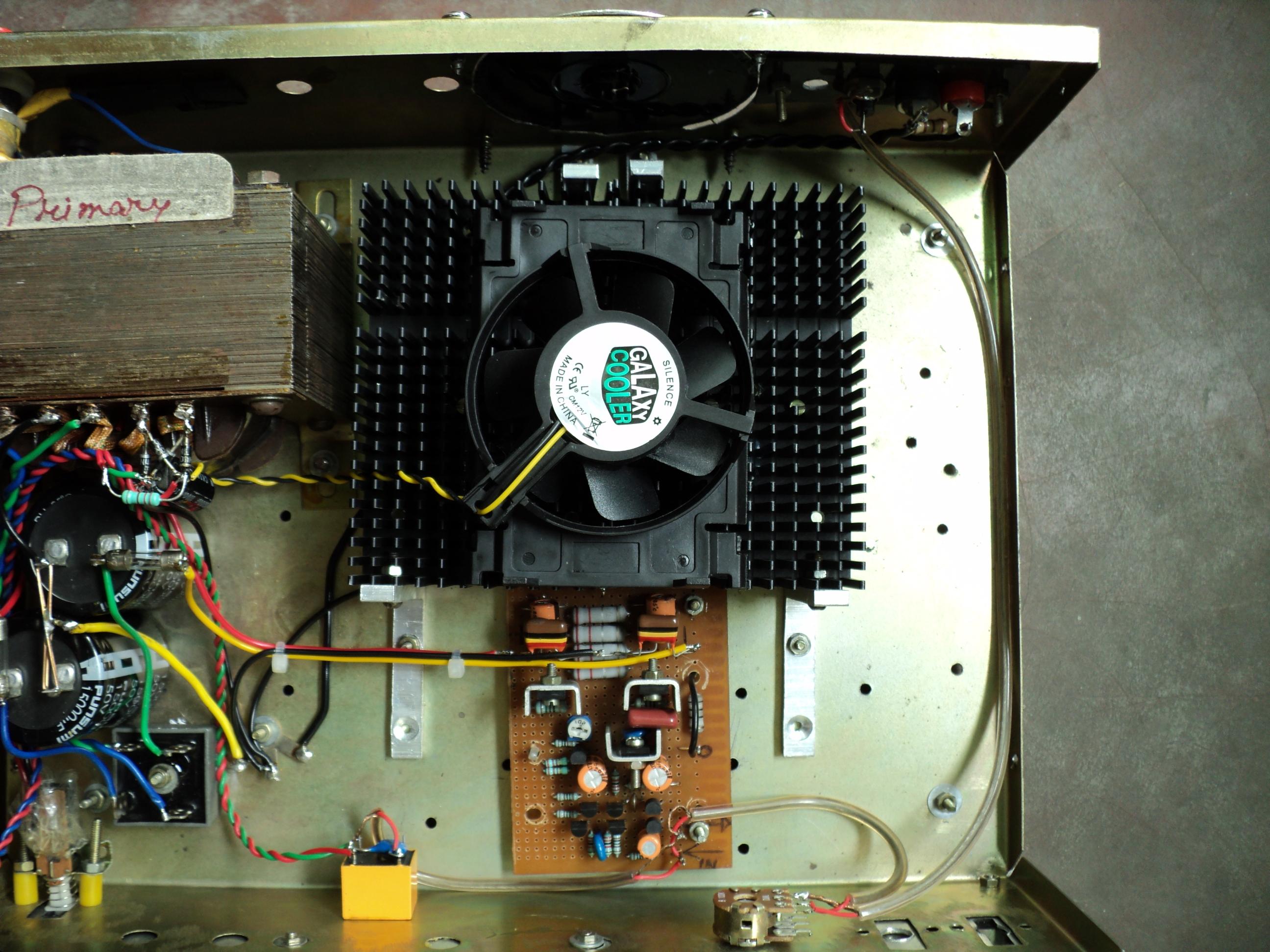

Lateral FET amp for midrange and highs... I call it Magic.
Veroboard-art. hehe...
Test sample. But, but this test sample will be put to my final system. Not gonna discard, precious. Have designed a single layer PCB too... Hope to have it etched SOON. :)

great job Shaan! beautiful layout!
What amp is that precisely? Just wonder why don't you drive the mid and high with your prompt MPF amp? It should sound more delicious IMHO, or maybe you prefer to try different taste :)
Thanks for your kind words.
The amp is a mix of Self-Blameless and ESP-P101. Plus some of my humble contributions like the optional 2.2ohm Zout, lower overall gain and increased LTP current.
I LOVE the MPF. Irreplaceable. Yes it sounds SWEET. SE thing you know. I listen to MPF from October to February. Coz 200watts of heat helps a lot in winter as well as the warm sound it presents. Absolutely no need for a blanket at a night of 5degrees. :eek: :D
I want it in the summer too. But the heat hurts. Has been searching for something that can deliver me that same sound without so much heat... I have found something close, this amp. But not exact same, and absolutely not with the default Zout which I think is less than 0.0000001ohm or so(not really)... LOL It produces really solid bass. Distortion-wise it wins over MPF and doesn't disturb when playing loud. But I will forgive MPF, blessed with innocence.
This amplifier will draw 250+250mA and with the high output impedance it almost mocks the MPF. Almost... This is my Summers MPF. YES it too is a POWER MOSFET amp and also runs in source follower mode, like the MPF.
Seems like I am enjoying old taste in new foods!
