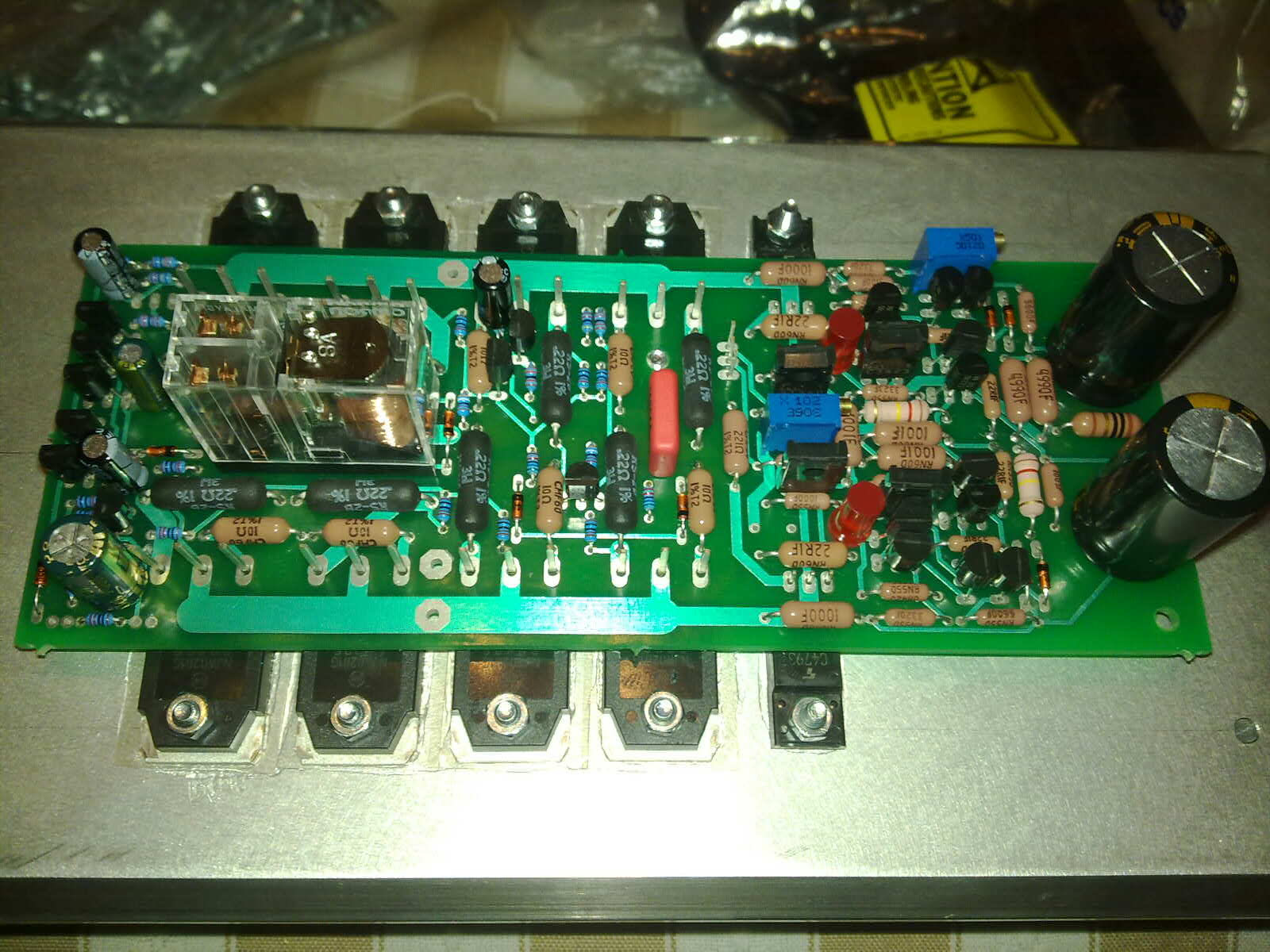

This is the solid state output stage of my new hybrid project. The pcb contains the protection as well.

Nice ,ON - NJW0281/0302 powered 🙂 250W (4 pair). Looks like a full comp. VAS w/ current sources.

Hi OS,
You can check the schematic, and some more details in http://www.diyaudio.com/forums/solid-state/185265-my-new-hybrid-amplifier.html topic.

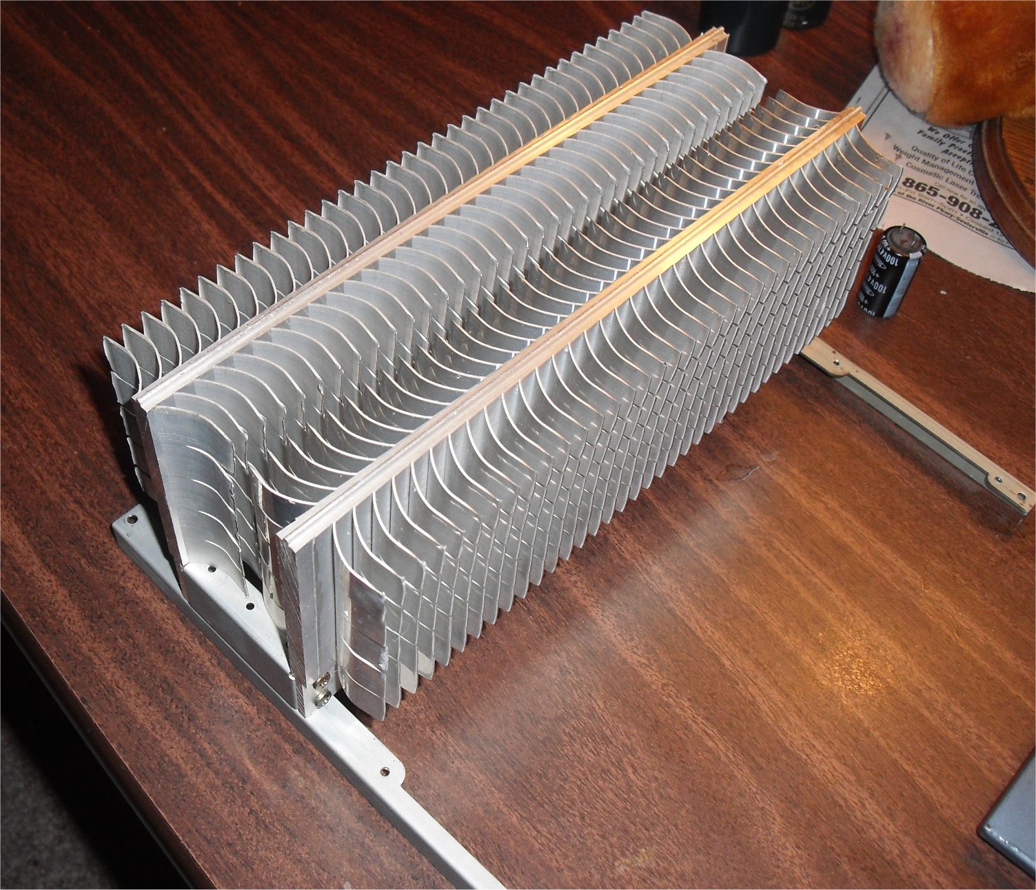

That case's heatsinks should carry 120-150w/8R (class AB-B) per channel , same style and size as most of the DH haflers , yamaha pro 100-125w units. The sony,nikko,jvc's use the "skived" (they shave the fins off of a solid block) aluminum heatsinks (below 1) ... about double the C/watt capacity . That one below can do 480 watts. they are not as durable , most are internally located.

Ahhh , triple .... unique cascoded design. 😎😎 Have you "blasted" (listened) yet??
PS in the real world (OEM) , your 4 pair of NJW's in triple mode can be honestly rated at 300/500 watts (8/4R). provided your rails are below 65V (this is where the "knee"- dropoff in the NJW's SOA is).

Not yet. But I hope I can listen it in this weekend.
The maximum output power is about 440W/4ohm, the maximum output is 120Vpp, if the rails not drop more than 1V. Maybe I will make separated PSU for the VAS, with some regulated +/-70V. This means 3V more output. But I think, that it's not really necessary.
Say what ?

Say what ?
I had doubts , since I last saw one 20 years ago on my JVC ... but I AM correct.
Skived - Definition and More from the Free Merriam-Webster Dictionary
It means to slice off thin layers and it IS the marketing term the Japanese used "in the old days"to describe their "thermal solution".
