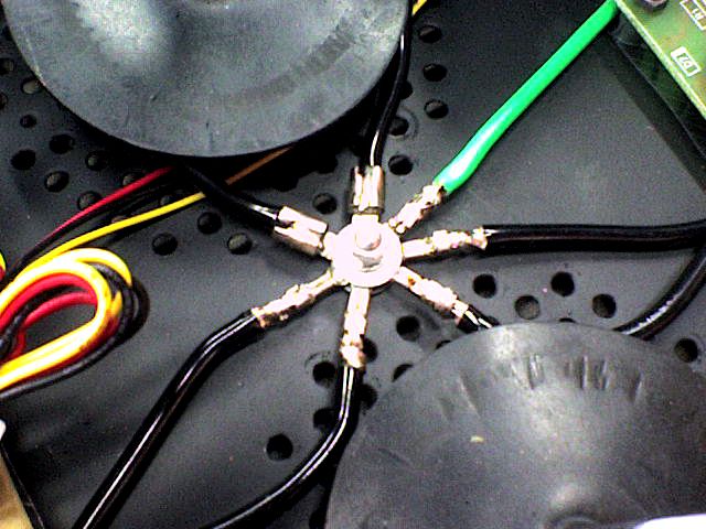

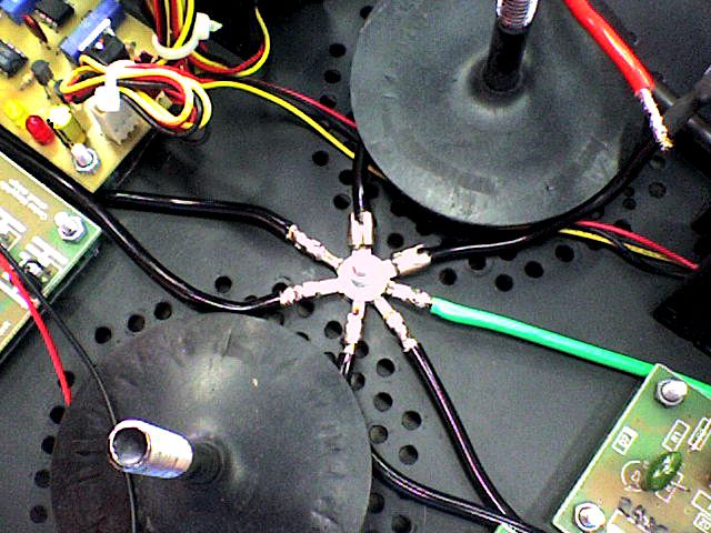

Android Starfish.
Crimped and soldered ringlets bolted together make an excellent Audio Ground.
The order of attaching the ringlets affects the resulting performance. Yes, some experimentation is in order, but since it's bolted, very easy and very quick.
I put on the dirtiest ring first. Probably the Disconnecting Network that goes to the Safety Earth. Progressing through to the cleanest last on, this would be the Signal Return.
Note,
if one makes this attached to the Chassis then the chassis panel becomes the first "ring" on at the bolt head.
Do not make this the Safety Earth.
Use a separate dedicated Permanent connection near the mains incoming socket/cable as the Safety Earth.

Thank you very much. This has been a major concern.Do not make this the Safety Earth.

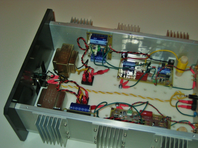

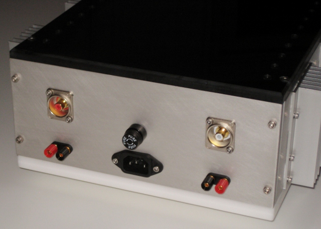

Transfer characteristics, measured values. HQQF-55-506W-5-1, Mosfet amp, 5 pairs IRFP240/9240
I am so happy with these amplifiers that i have build three.
regards,
Carlos
Only 3?
Regards zeoN_Rider
These are stereos inside enclosure..i have build more 12 channels
during the prototype work...these are final ones..needing some details only.
123 stereo sets of boards sold inside group buys in Brazil and inside this same forum... a very few have etched their own board...less than 5 percent.
Rudi have sold almost 40 stereo sets i suppose.... red board's group buy from Rudi.
It is big and heavy...i could measure 340 watts RMS each channel at 4 ohms..distortion at this power reaches 1 percent.... at 150 watts the distortion is around 0.003% THD - 8 ohms..it is rated as 100 watts each channel.... underated alike Sansui did.
