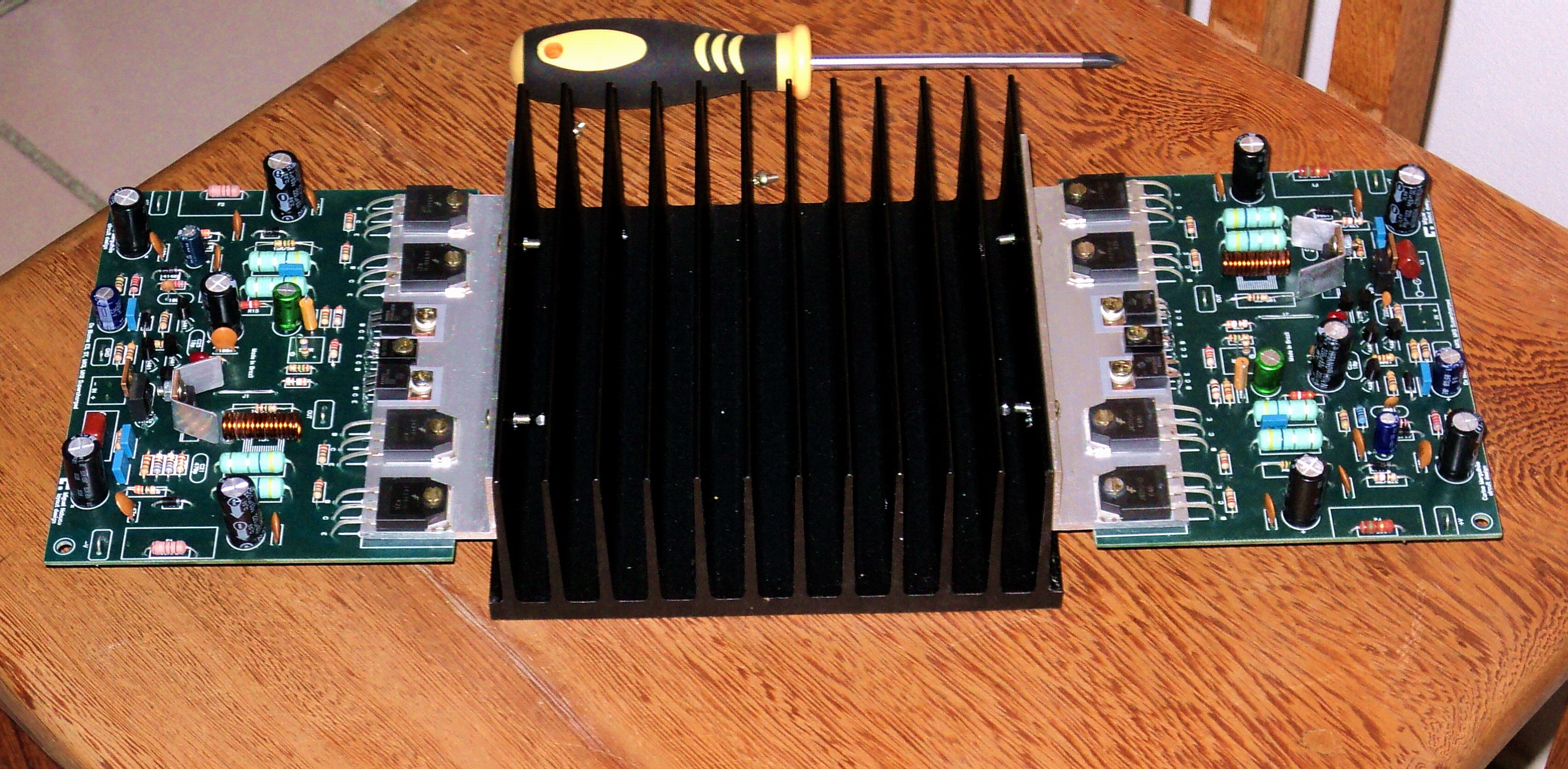

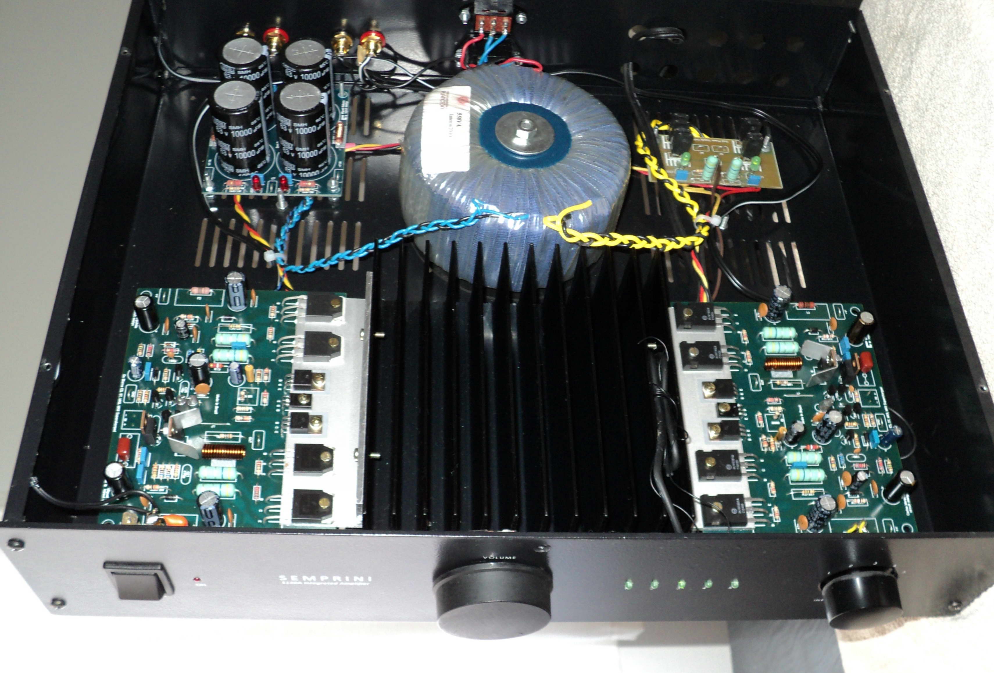

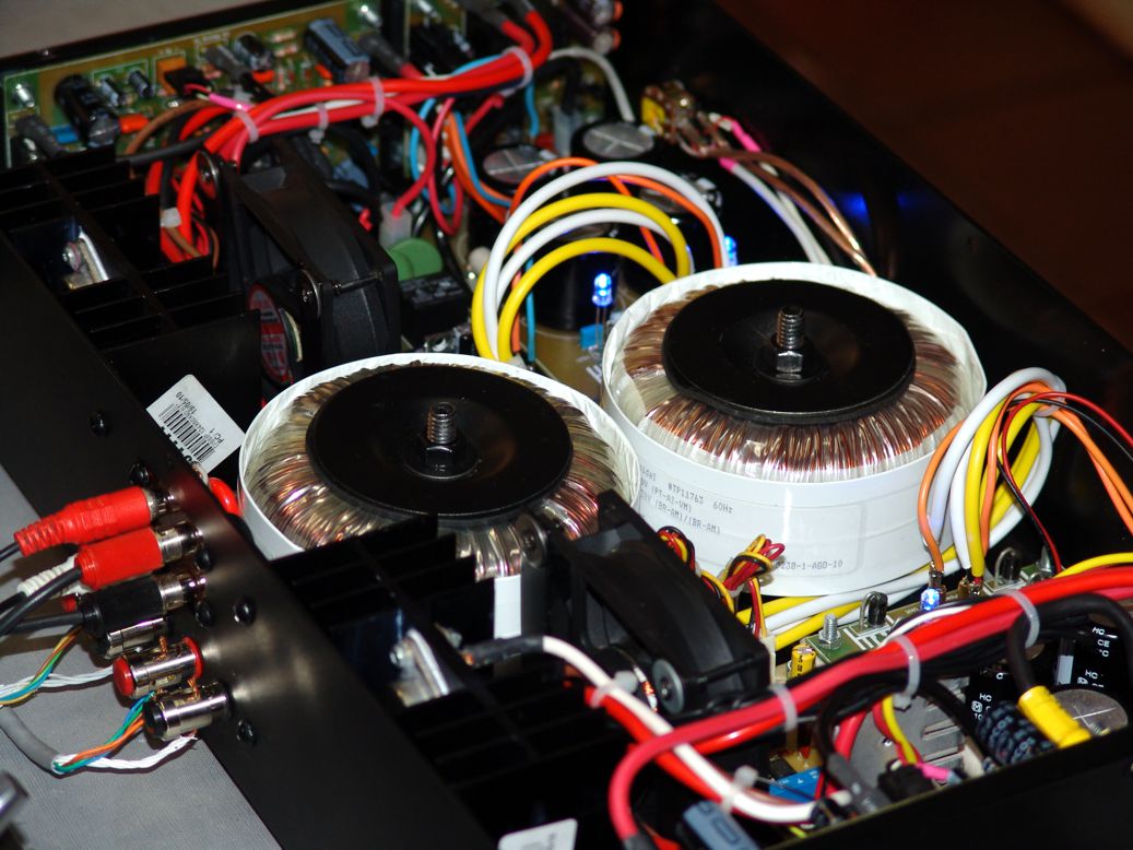

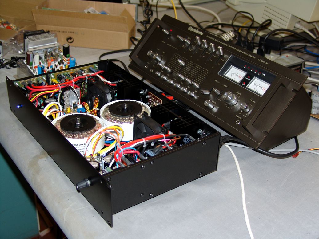

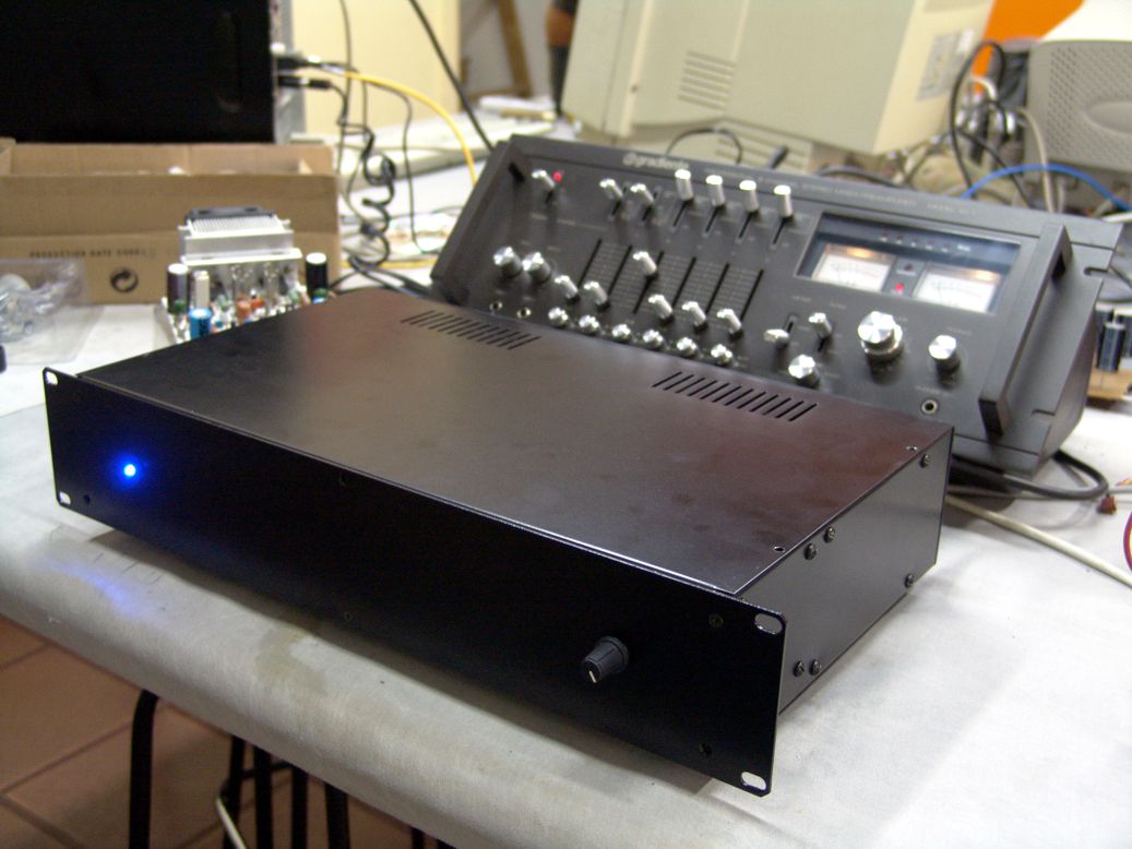

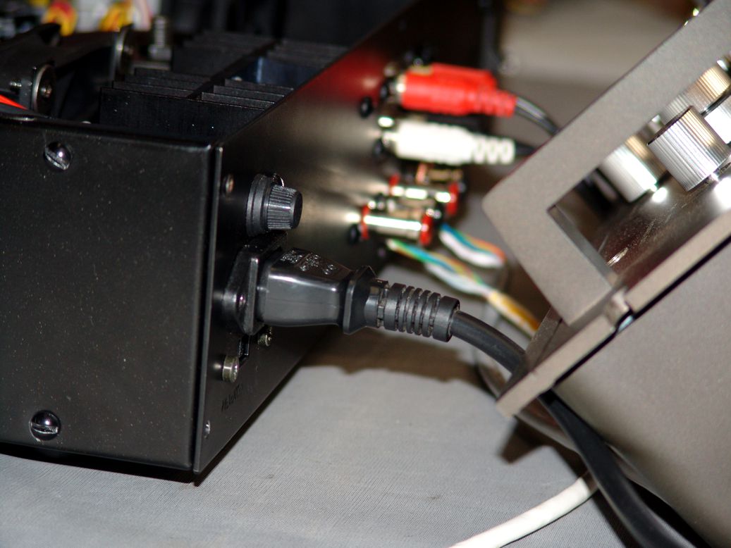

First photos after finished...
Here are some photos after finished assembling everything.
Amp is fine and playing very well!
Max.
Max.

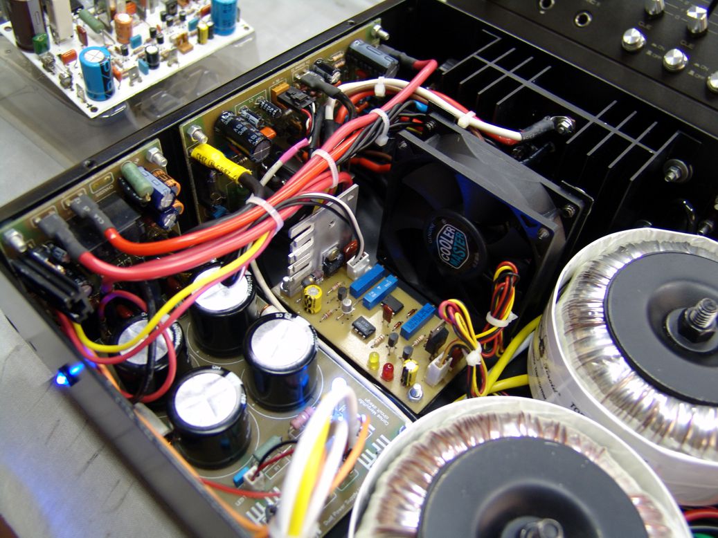

Wow nice one. Any details on the amp module used ? Transformer ?
OK:
- Dual DX Blame ST amp module and power supplies by Carlos Mergulhão, TO-3 outputs;
- LS Protect by Miguel Nabuco, idea from SiliconChip magazine;
- SoftStart adapted from National application idea;
- Transformers from Toroid do Brasil, 26+26ACV, 208VA;
- Fan controller from Giogros Lazaridis' idea, enhanced by AndrewT's suggestions;
- Case from Naoko (Brazil, mod. RK-2U-B);
- My design!!!!

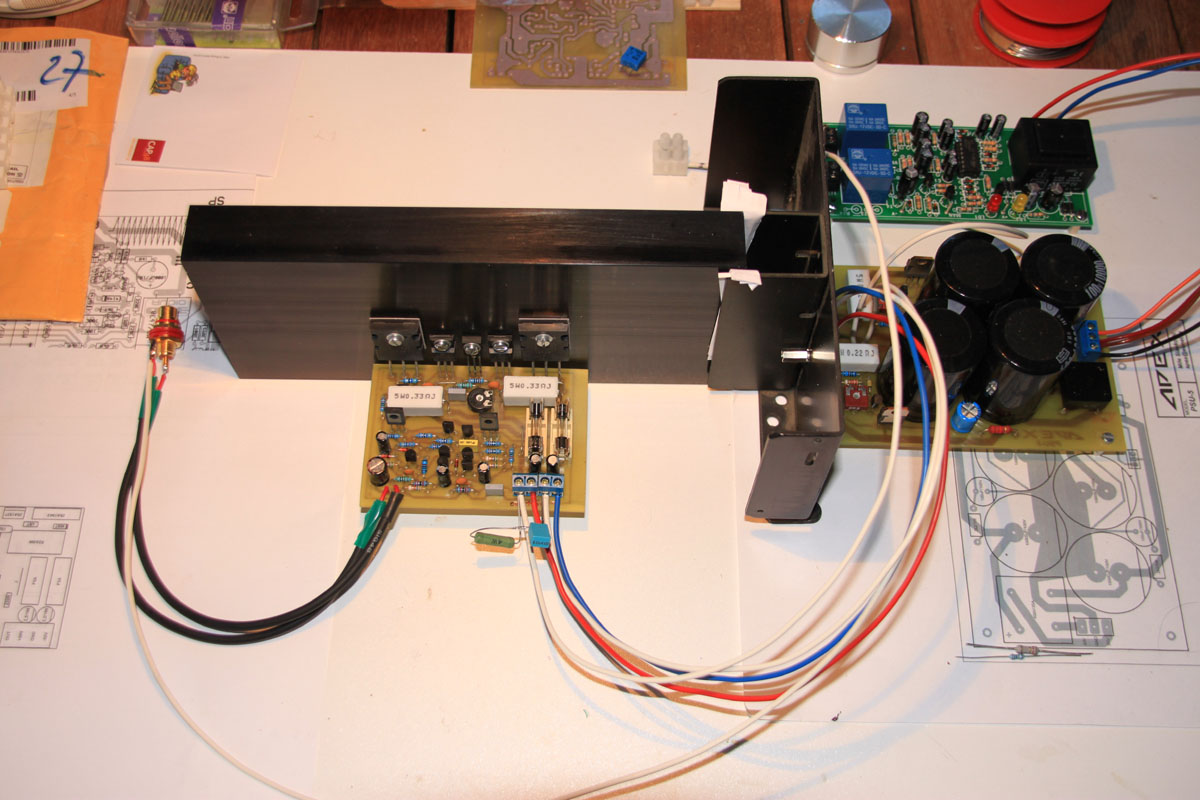

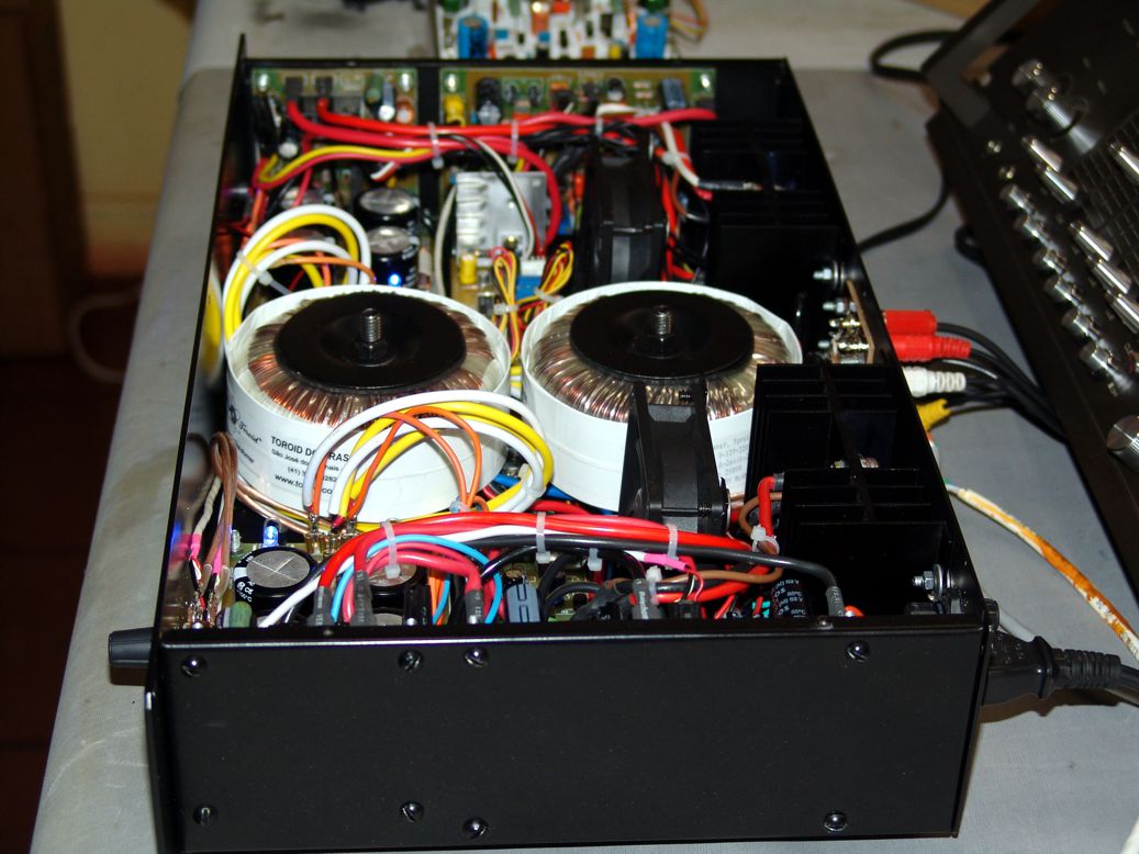

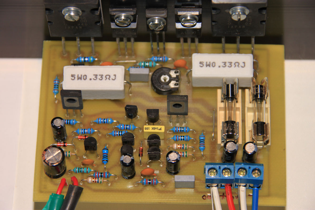

Here some pictures from the Supercharged
Yes, the heatsink solution is not the best...but it is the one matched my enclosure.. i am waiting some power resistances to arrive from part's supplier.
Black cable over the heatsink are for the peak meter in development... the left hand one is already in operation...but not finished yet.... rigth side one will go to the enclosure tomorrow.
Golden input connectors are missed too, also input switching and high cut potentiometer.
