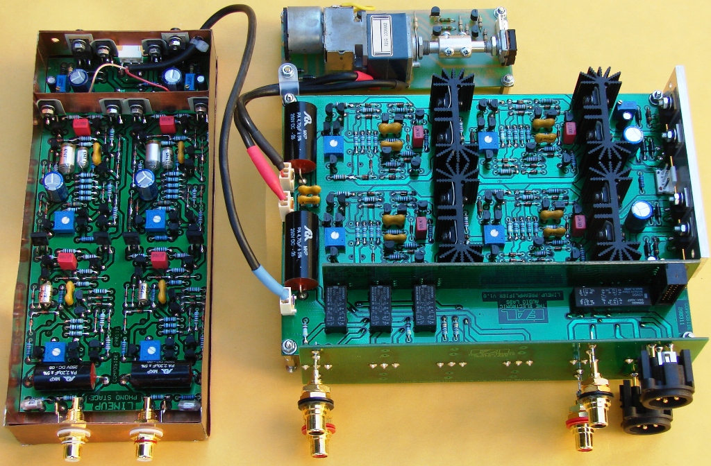

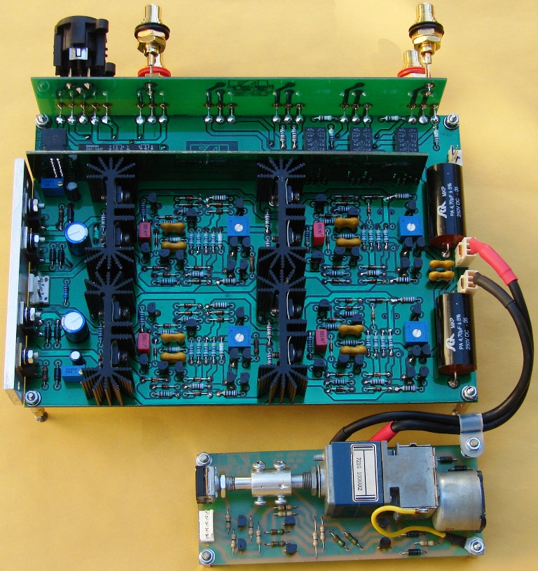

Here are some pics from the last work that we did with Lineup. The very polite and kind Lineup helped me a lot in the design of this Preamplifier. Thanks to the extensive use of simulator, we have obtained a really good result. For details of circuitry and measurements, please look at http://www.diyaudio.com/forums/analog-line-level/184455-preamplifier-lineup-fotios-fun.html
and at http://www.diyaudio.com/forums/analogue-source/183545-phono-preamplifier-lineup-fotios.html. In general, it is an Active Preamplifier included in the same case with a Phono Stage, both implemented with discrete devices and high quality parts. It offers 4 inputs: PHONO - CD - DVD - LINE. Its gain is unit (Av = 1) and offers both Single and Balanced outputs. A Record Output is also included, and thanks to the use of robust transistors in the output of main buffer (either MJE172-182 or BD139-140 mounted on heatsinks) the Preamplifier has the ability to drive low loads like a pair of headphones. It is remotely / manually controlled by my Control Unit described previously.

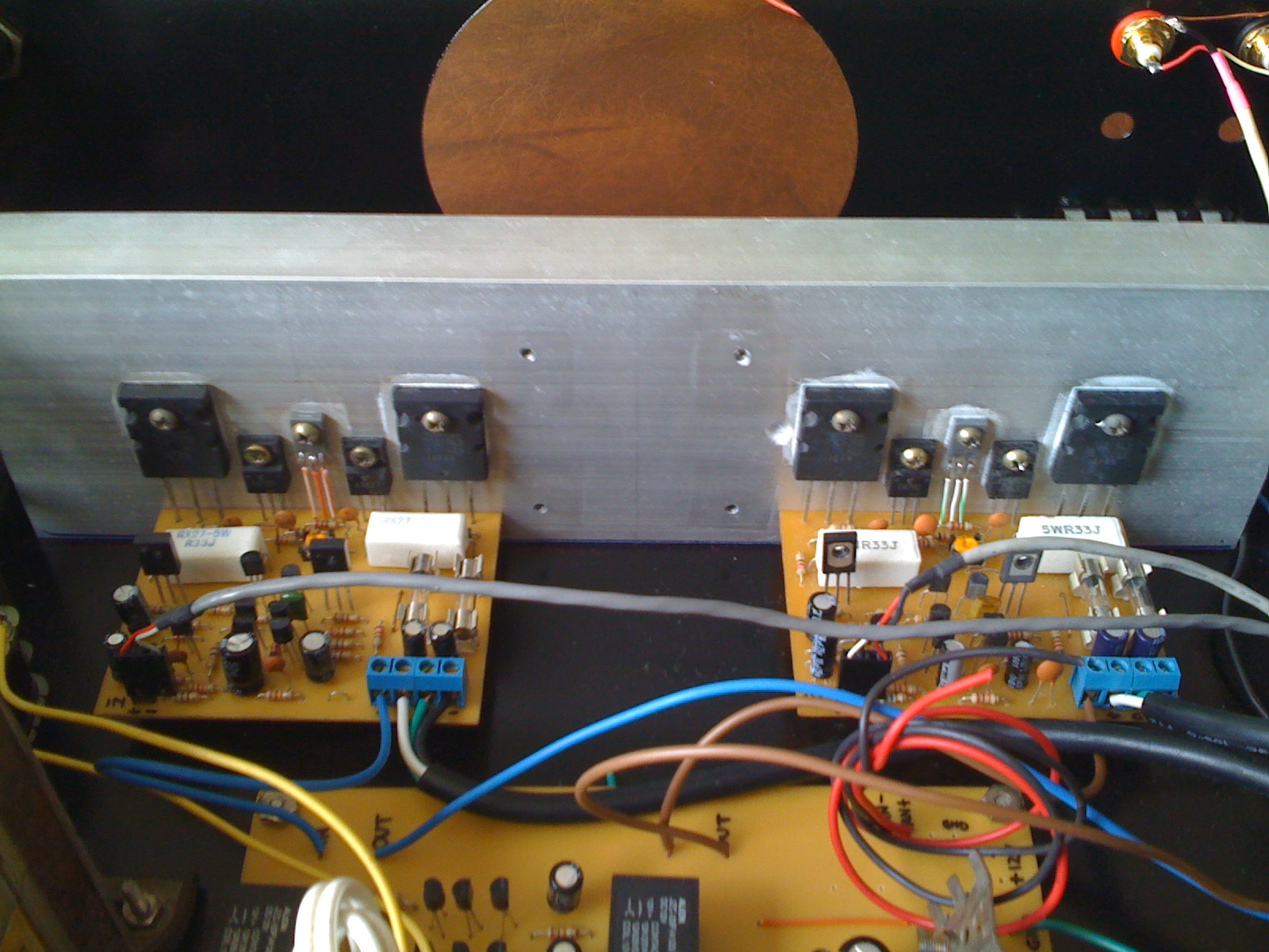

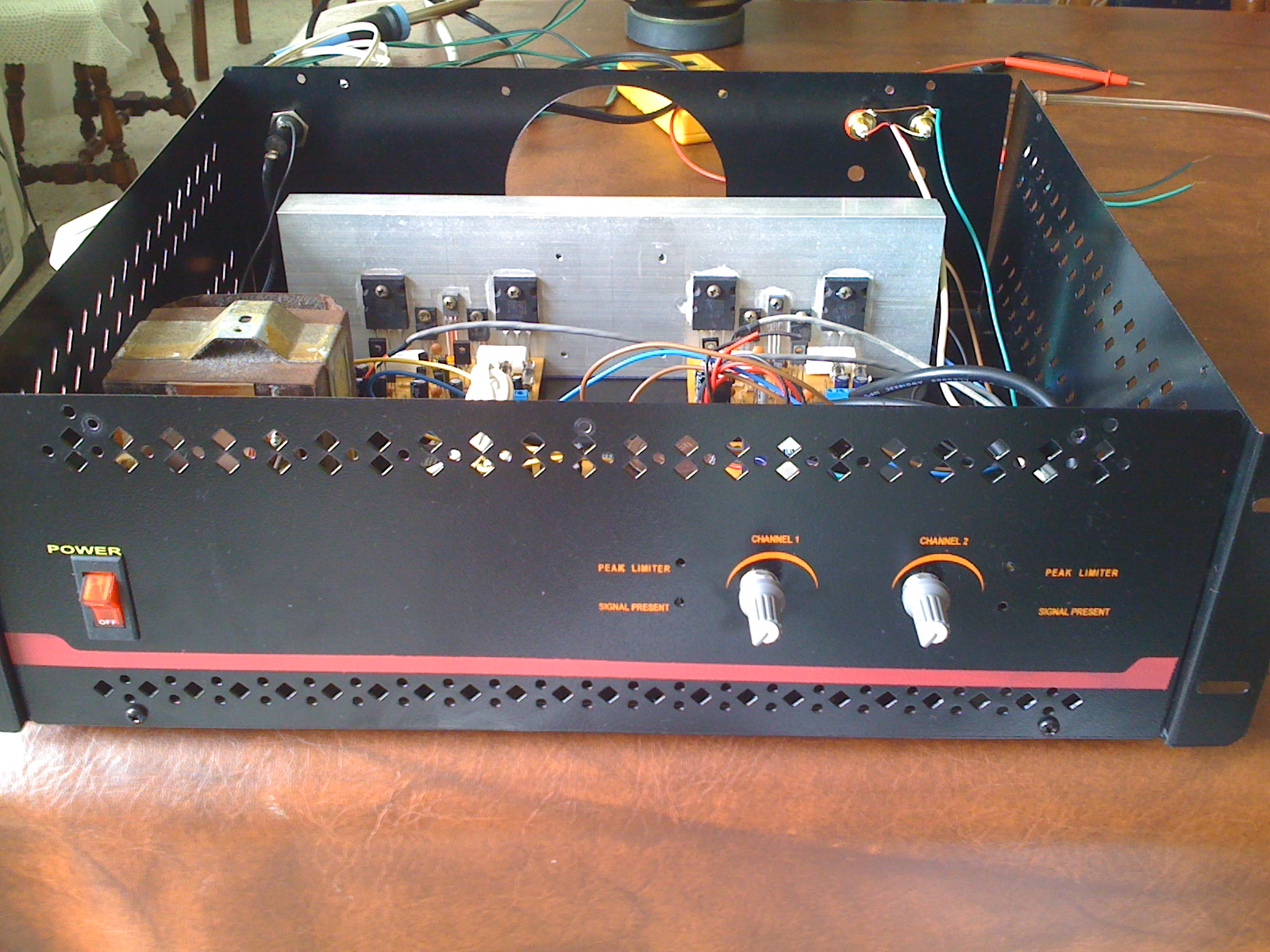

@fotios
You have great skill, the unit you build looks very professional. I checkout the other thread, this is beautiful stuff you doing there. Makes me want to do something like that too... You do have a great advantage of working in the audio industry. 🙂
@apexaudio
You also have put together a nice Amplifier.
DIYAUDIO forever 😀😀😀😀
@apexaudio
Awesome Fotios!
Awesome Fotios!![]()
Lot of thanks dudaindc for your kind words! 🙂
All the best
Fotios

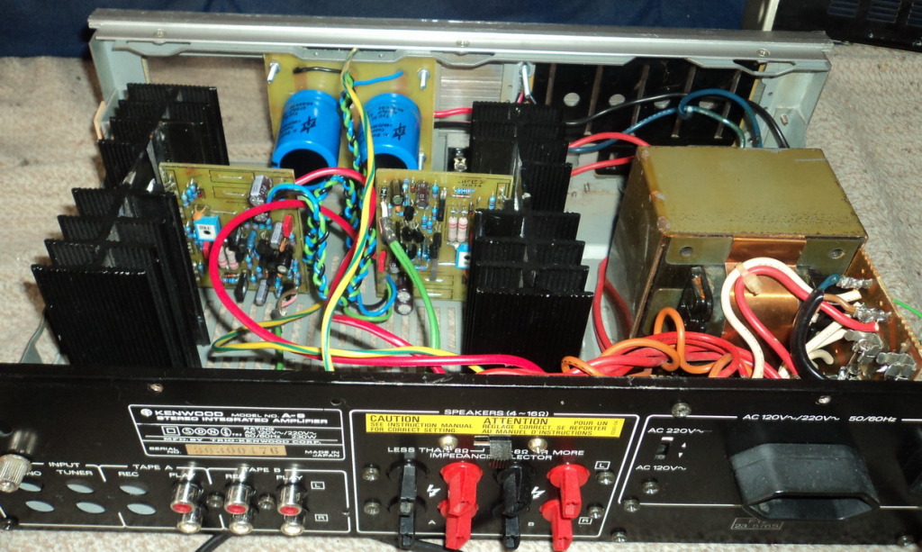

I only share pictures of my projects build by other diyers, I just have no time for hobby :-(
This is '100W Ultimate Fidelity' made by 'LuigiDJ'
Regards
