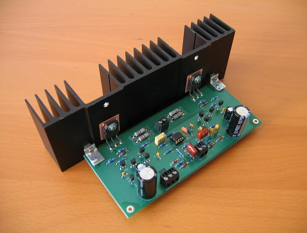

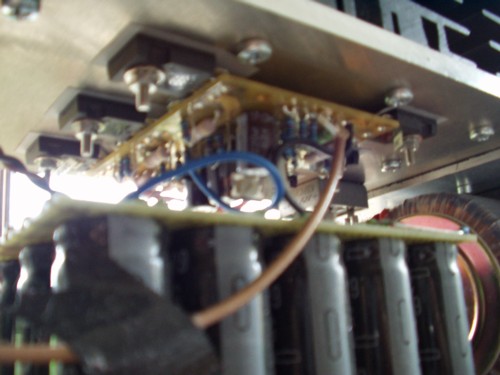

My latest creation -4
Electronics detail

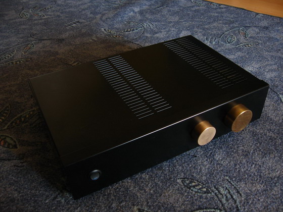

SymAsym 🙂

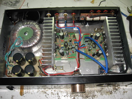

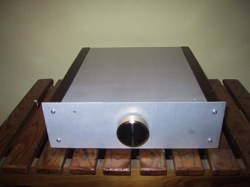

Front. Knobs made of bronze, needs to be polished.

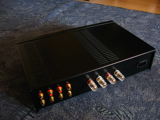

With which type machine your friend made the slots of ventilation in the top cover? With milling machine?
Also your box suppose is alluminium made. It is painted or anodized? Please give me further informations.
Fotios
Slots... I think you though of slots for knobs. Make hole in front panel (for example knob_diameter+2mm), then weld bottom-closed pipe (choose its length, as you wish the knob to hide into case), but before cut that pipe on side, just to be able to screw knob to potentiometr. On the photo you can see what i mean.
Ventilation rows, yes, they ware made by cnc milling machine.
Update: Don't change your post so qucik 😉 Material used is an acid-proof plate. For frame on bottom - 1.5mm, and for cover - 0.7mm. It's painted.

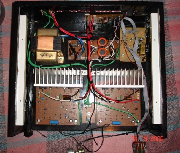

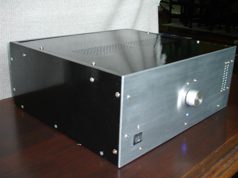

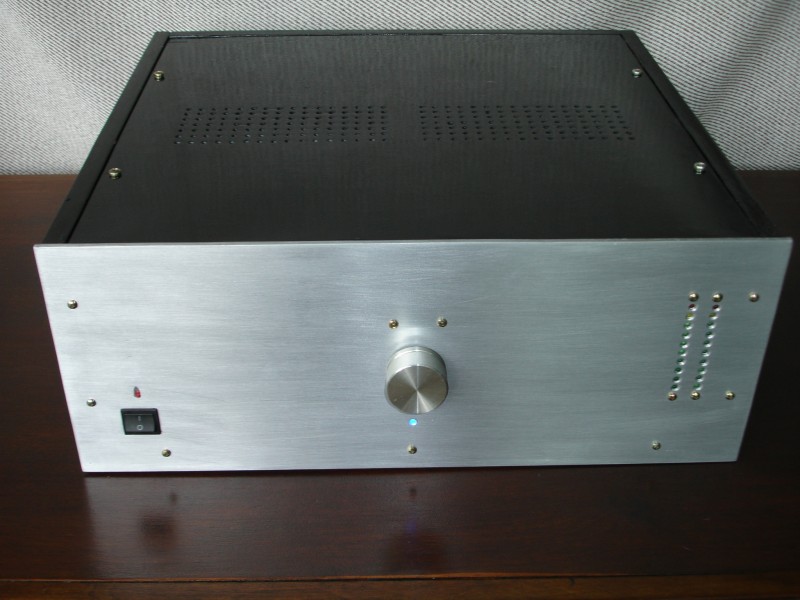

Here is my humble contribution to this thread. These are the pictures of my DIY attempt. I finished the case last year. The amplifier is a Randy Slone design and it has been playing very well for more than a year now.
João Pedro

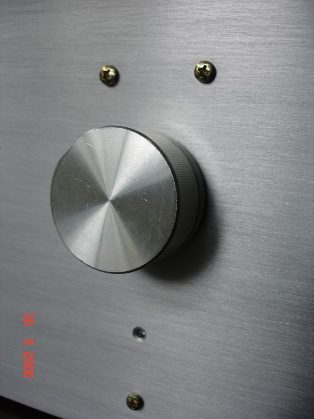

(Hi Fotios) I will post some fotos of an amplifier made 12 years ago by a friend of mine, as soon as i can.
The chasis was made from raw aluminium plates entirely, the sides were the heatsinks. I think you already have more than the tools needed for the job 😀
By the way, I must have more info about that 15E bending machine of your's :drool:
