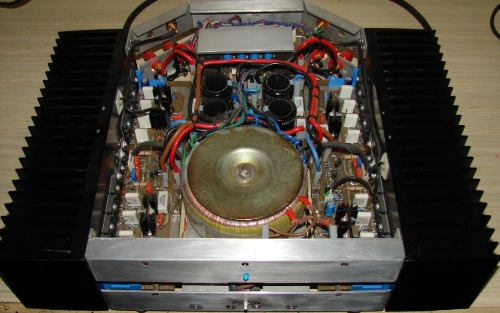

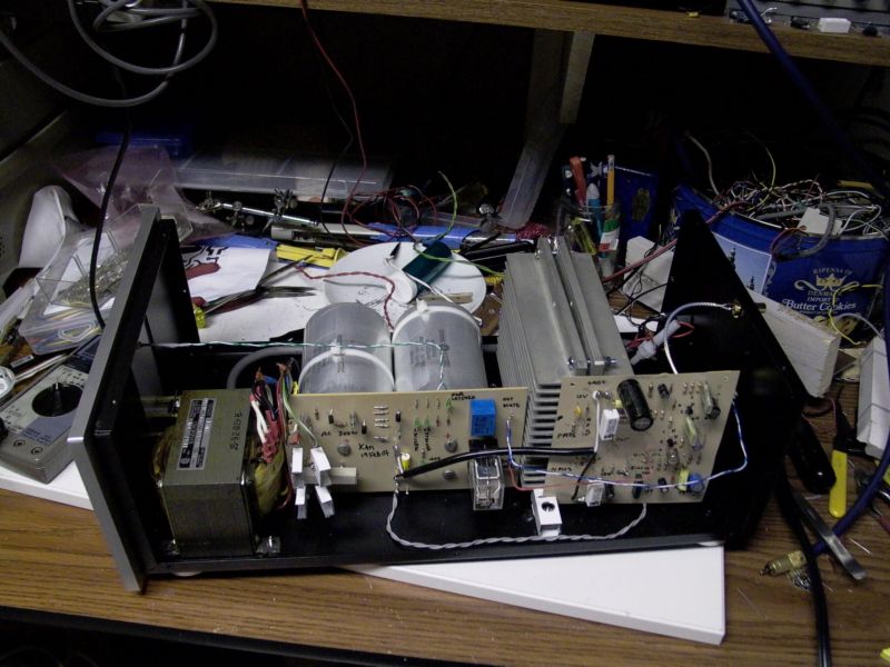

It is easy for you to inform me, in who factory in Europe you ordered this beautiful front panel and the box of your amplifier, also how many cost these. I know only a factory in Germany, FISCHER ELECTRONICS known more for the excellent heatshinks that manufactures – them I use exclusively in my constructions – but it manufactures also boxes at order. Is this? I quote a photo of my trial power amplifier in order to you understand the situation in that be located.

Thanks for your interest. The information and the links that you give it is very helpful, specifically that of ATI Research left me astonished, and i will contact with she in order to learn prices as i found ready boxes so for my amplifier as for the preamplifier - with discrete devices in modules - that I prepare. I am afraid however that i will be late somehow because I have spent all of my money in the research. Looking to the circuit of the power amplifier, yes it is my own design – if we can consider him such, because simply it is a compilation from already known distributed topologies that i have selected deliberately in order to achieve a balance between cost and quality in combination with flexibility for the possibility of construction different in power output amplifiers, and her cost is roughly 350€ as you see him without box – totally realized with BJTs (small signal stages by use of MPSA06 - MPSA56, VAS and drivers by use of MJE15030 - MJE15031, and with 4 X MJL21193 + 4 X MJL21194 output devices per channel) with a power supply of +/-60Vdc at 500VA, individual for each channel ( thus the output power lies in 2 X 170Wrms/8Ù – 2 × 250Wrms/4Ù from 20 to 20000 Hz +/-1dB ) a damping factor of 400, a rise time of 1,9ìs, an input impedance of 50ÊÙ, with ultra low TIM and THD+Noise (i have not an analyzer to measure these but i observe these with my digital scope). It includes a smart analog computer for full protection of speakers but also the output stage from all kinds of short circuits, and an inrush current suppressor circuit. The only that is absent is a beautiful box in order to enclose this compact construction – I have spend a lot of time to minimize her size – and be tried for 1,5 year without problems. Also she is flexible as with the same circuit and with few additions it can reach a power output of 2 X 350 Wrms/8Ù, he is also tried and this. Very soon I will make a complete presentation of this construction, step by step, in my web page; you will be informed for this. I quote below a photo indicating a channel from the trial module of a monster at 350Wrms/8Ù (with a supply of +/-86Vdc).

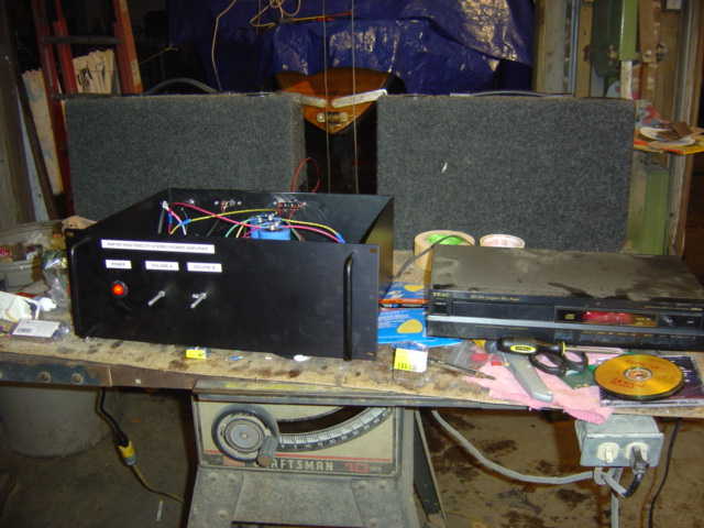

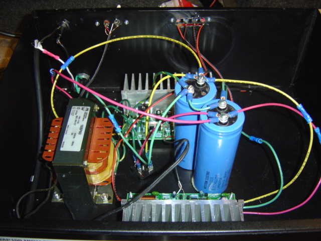

From the thread Power amp under development I picked this design as my first DIY. I should have started with something smaller but my stomach said, "This is the place to start". I am very happy I did build this amp as it is a wonderful design. Extra special due to the fact that it was tweaked out right here on the DIY & sounds and performs like a great amplifier should. 🙂
It has since been re-wired with a Bias Adjustment but it is on loan at a friends and I have no new photos. And I fixed the burned-out LED with a new one. 🙂
Shawn.

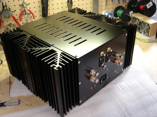

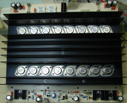

Here's my DIY amp. I built it about a month ago. It has been performing beautifully.
Specs:
Power: 100w per channel @ 8 ohm from 10Hz-100KHz +/-1 dB
THD: 0.02%
Type: Class AB
Rails: +/-45V, 19,000 UF per rail.
Output Devices: Toshiba 2SC5200 & 2SA1943
Specs:
THD: 0.02%
Type: Class AB
