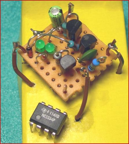

A follow up to my Post #14 in this topic.
Where I show a close up of my most advanced headphone amp circuit.
You can see itin this Image Attachment:
http://www.diyaudio.com/forums/attachment.php?s=&postid=1134699&stamp=1171426328
This time,
I will put ..... a small very precise 3 pin regulator
built with 3 TO-92 transistors + some diodes for voltage reference.
Intended use: Powering Op-Amps in battery powered gear.
Data:
Circuit own power consumption: 150uA ( 0.000150 Ampere )
Voltage output: +5.000 Volt ( +/- 0.010 Volt = 10mV )
Max current output: ~50-100 mA something
(but few normal audio Op-Amps would take more than 10mA per IC)
Dropout Voltage: ~0.050 Volt max (at 'normal' 15-25mA output)
... gives ...
Minimum input voltage( for +4.99V out): 5.04 Volt DC ... 😎
As said, this regulator, in it self would take, draw, only 0.15 mA to work properly.
So it would take many months to empty your batteries.
The hardware use the same typical ' lineup costruction method '
= hardwire at the bottom side of a piece of pcb experiment board.
In this case, it required like 25x25mm (1x1 inch)
See image attached here below.
It is easy to see my 3 brown pins in the corners of my circuit:
1. input pin
2. ground - 0 Volt pin
3. output pin
Regards and happy viewing my nice picture!

Here you have my discrete regulator data again .. in case somebody did miss it.
Transistors are BC550C and BC560C .. no other could do this job better, at such price.
A Feature worth mentioning:
Reference diodes, see picture: 1N4148 + Green LEDs
This reference is powered, biased
from my very precise OUTPUT ( +/- 0.01 Volt )
This feature, of course, improves 🙂
Regulator Line Regulation enormously! 🙂
Think these data deserves to be noted:
Data:
Voltage output:
+5.000 Volt ( +/- 0.010 Volt = 10mV ), accuracy +/- 0.2%
Max current output:
... gives ...
5.04 Volt DC ...
... those figures can take a compare
against 97.5% of all commercial chips out on the market
lineup

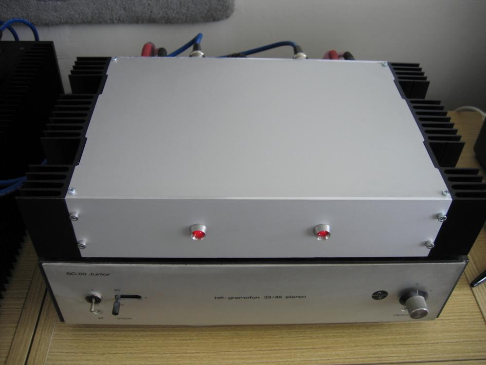

Here's my entry:
Dual mono lateral MOSFET amp, with JFET input stage and mainly SMD construction. Each channel is good for 140W RMS into 8 Ohms. 0.0013% THD (1KHz, 100W into 8 Ohms).
It's been running for a goodly few months now, with its matching preamp. I still haven't gotten around to building a muting circuit for it though, and it's still without a front panel
It sounds good though 🙂
Here's my entry:

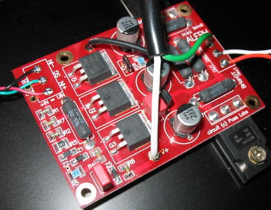

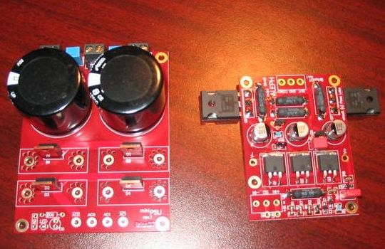

Here is a close up picture of the SMD amplifiers that i am running.
J'
http://www.jasesspace.com/G2/main.php?g2_itemId=352
J'
jleaman - SMD Mini Aleph
Interesting!
Deserves to be shown. Something for others to build, too ... ?
Photo 1 (from jleaman's public 'Audio Stuff' gallery (see link above )
jleaman said:Here is a close up picture of the SMD amplifiers that i am running.
Interesting!
Nordic said:I'd love that in a kit hey.
Nordic
Those Mini Aleph PCB are available, I think.
Because, Looking closely at the boards, after posting,
I could read 'BrianGT' in a corner ..
Now he is most know for making great 😎 Gainclone boards
for National chips like LM3875, LM3886 and LM4780.
( Explore / Order here: http://www.chipamp.com/ )
I would go search the forum for BrianGT Mini Aleph
Mini Aleph PCB may be mentioned somwhere ...
Anyway, when jleaman comes around to see my posts
He will give us more info 🙂
... how to get those boards
Regards

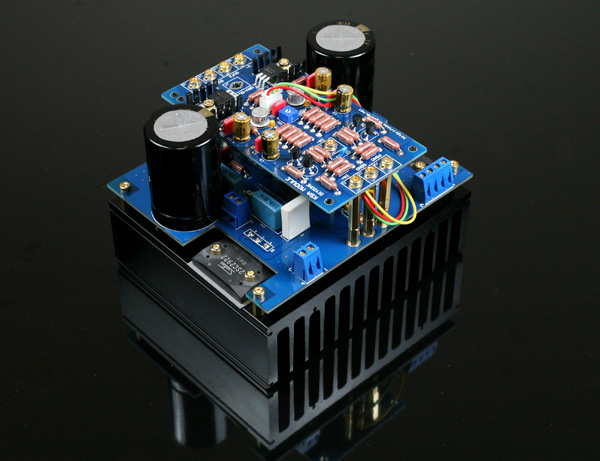

Arlo,
my god, that one is not an amplifier:
cause is
an 2SC2922
work of art
Arlo Mono Amp Creation!
http://www.ampslab.com/trans_2sc2922.htm
Japanese SC2922 Sanken ==> $30.00 for 4 pieces (paypal)
lineup
